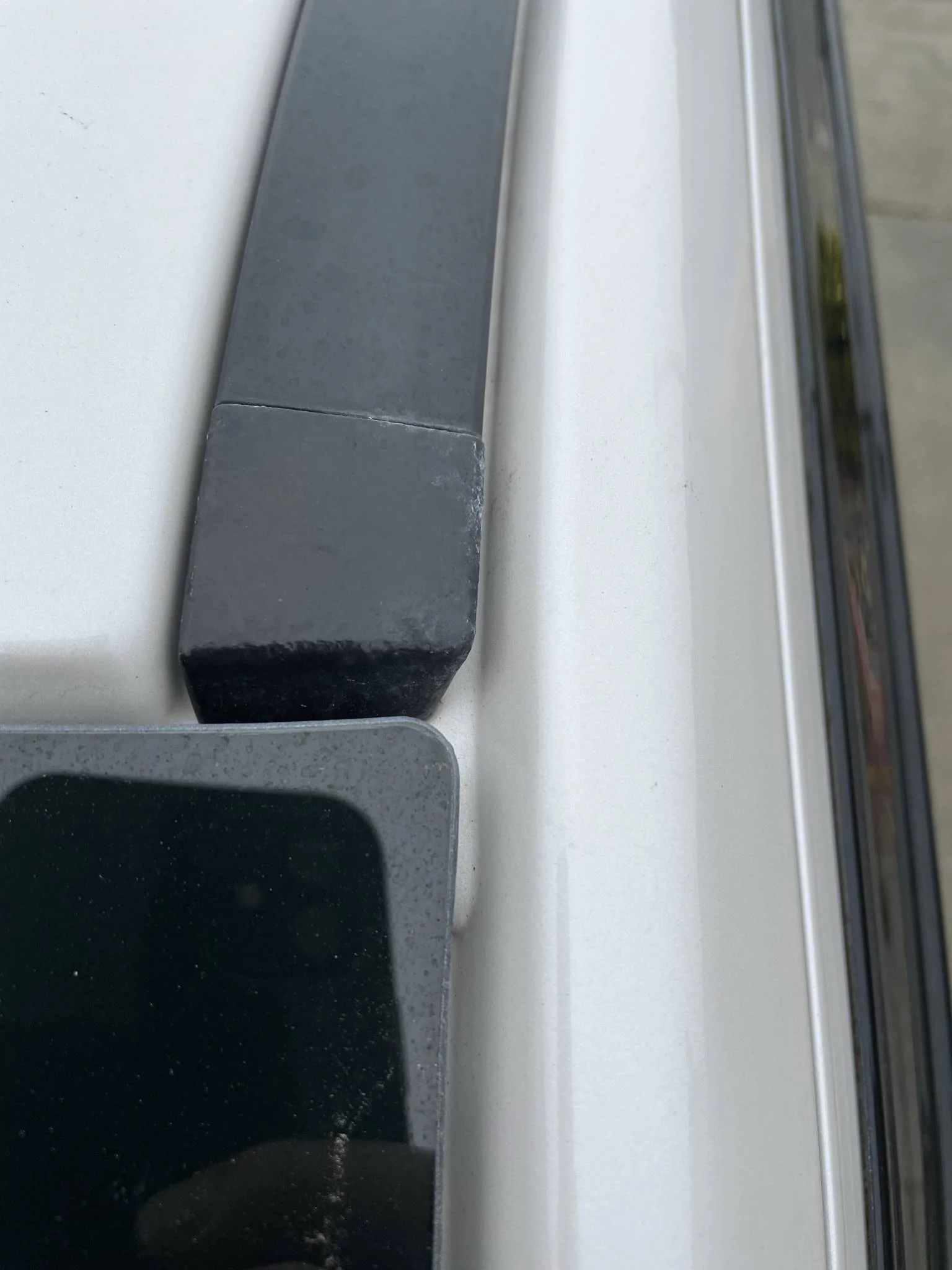

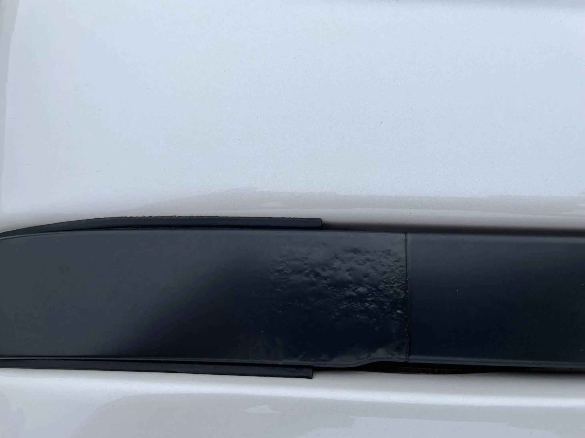

This is what it looks like. Flaked on passenger side and driver side rear you can see it bubbling under the shitty coating.
Most definitely corroded underneath like mine during warranty claim.

Clearly a quality issue with the supplier of this part. Warranty should cover without any hassle. If not, file a formal complaint with Ford Customer Care and find another dealer.
The supplier has to demonstrate process capability and somehow in the manufacturing finish process something went wrong.
Sorry to see you have a cosmetic problem such this that should never have happened.

I’m on my 3rd warranty claim on this same part. I live in Los Angeles and seems like one corrodes each year. Have had no issues with warranty. They have to pull the headliner each time they have to replace the trim

It’s the aluminum cap corroding. Have replaced the left front, right front and now put in for the left front again. Each one seems like it lasts about a year before it starts corroding.
