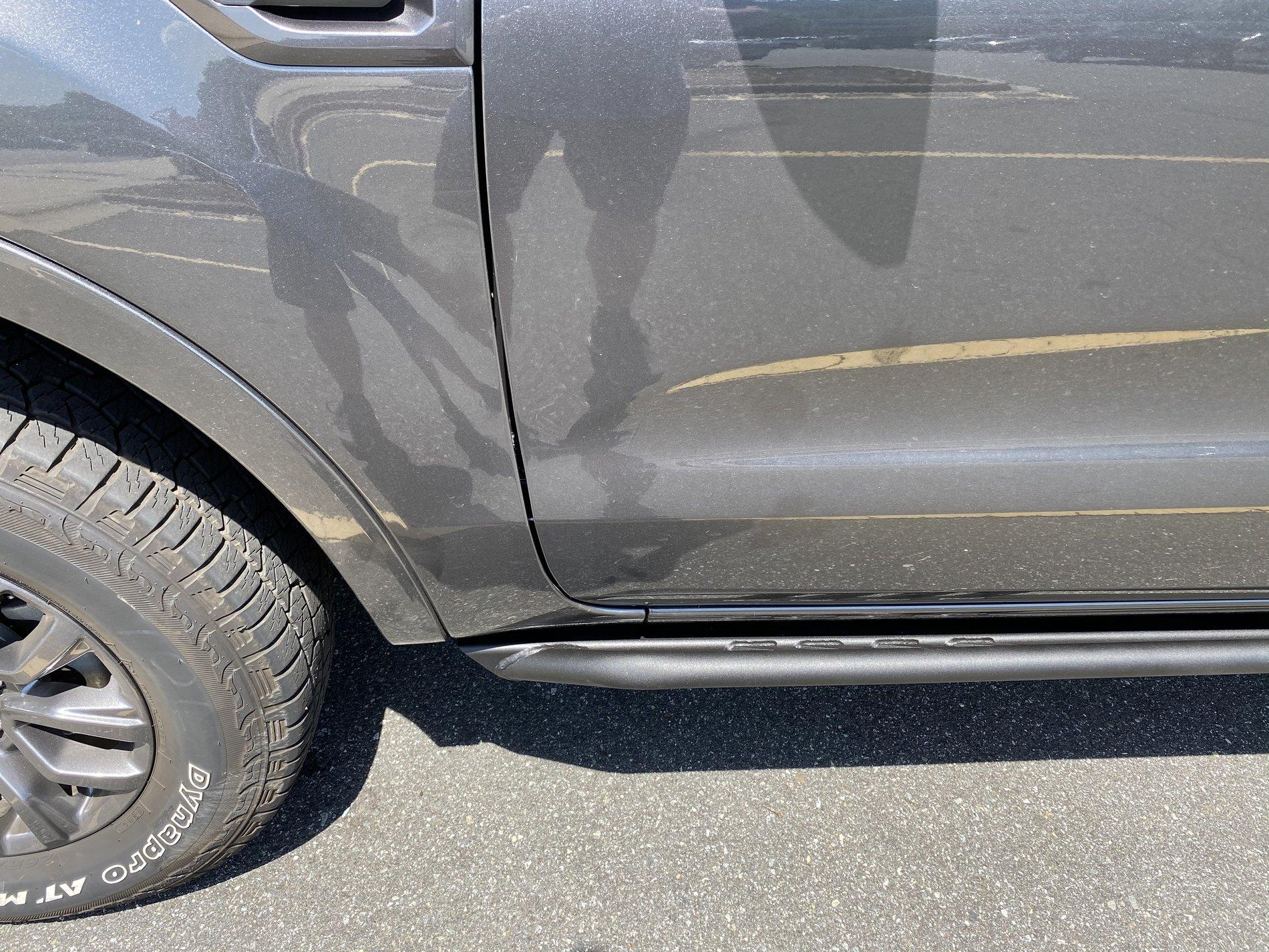

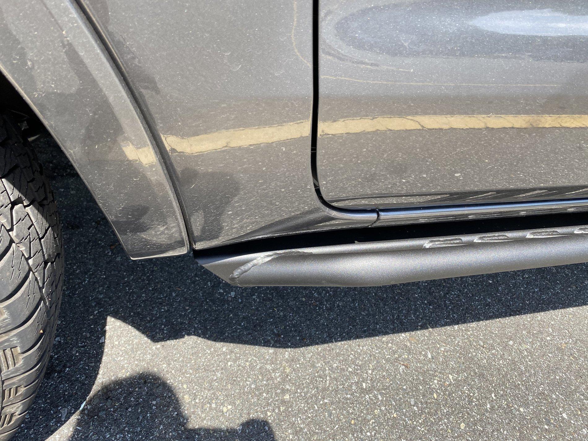

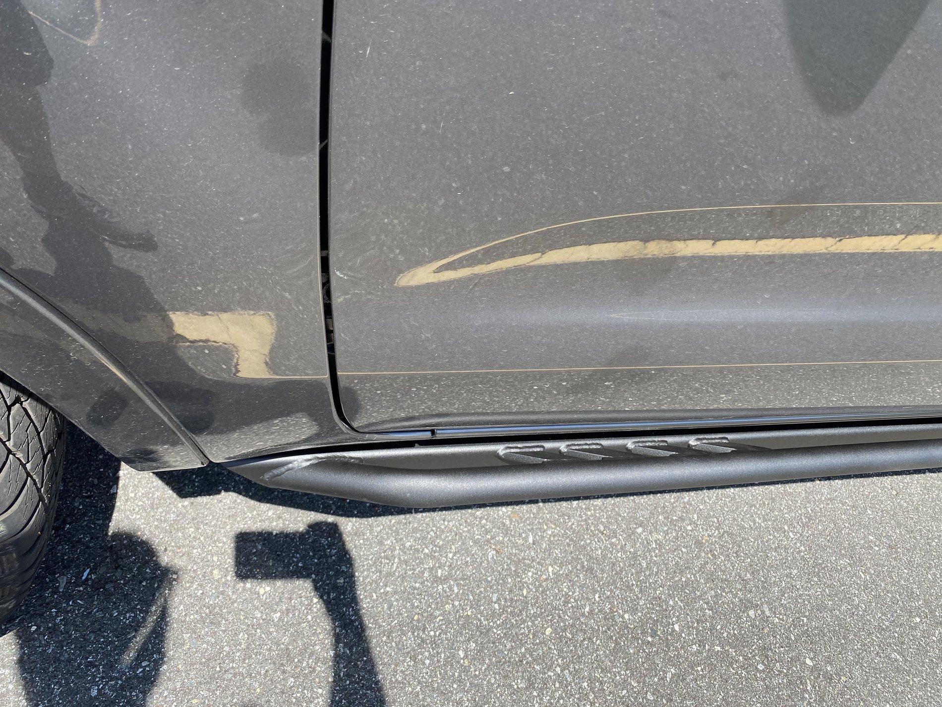

Anyone know if Shrockworks has solved the problem with their sliders on the drivers side not having enough clearence in the front on the drivers side?
I think I like the Rocky Road sliders more but the installation seems to be a little bit of a pain. Having to drill 24 holes into the frame doesn't sound fun at all. At least the Shrockworks sliders use existing holes. It's too bad they decided to go that route.

Shrockworks took care of me a while ago, stated they updated their jig and the new setup fits well
