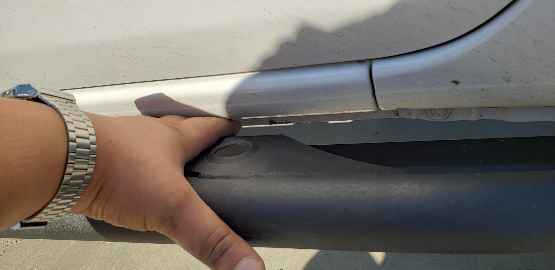

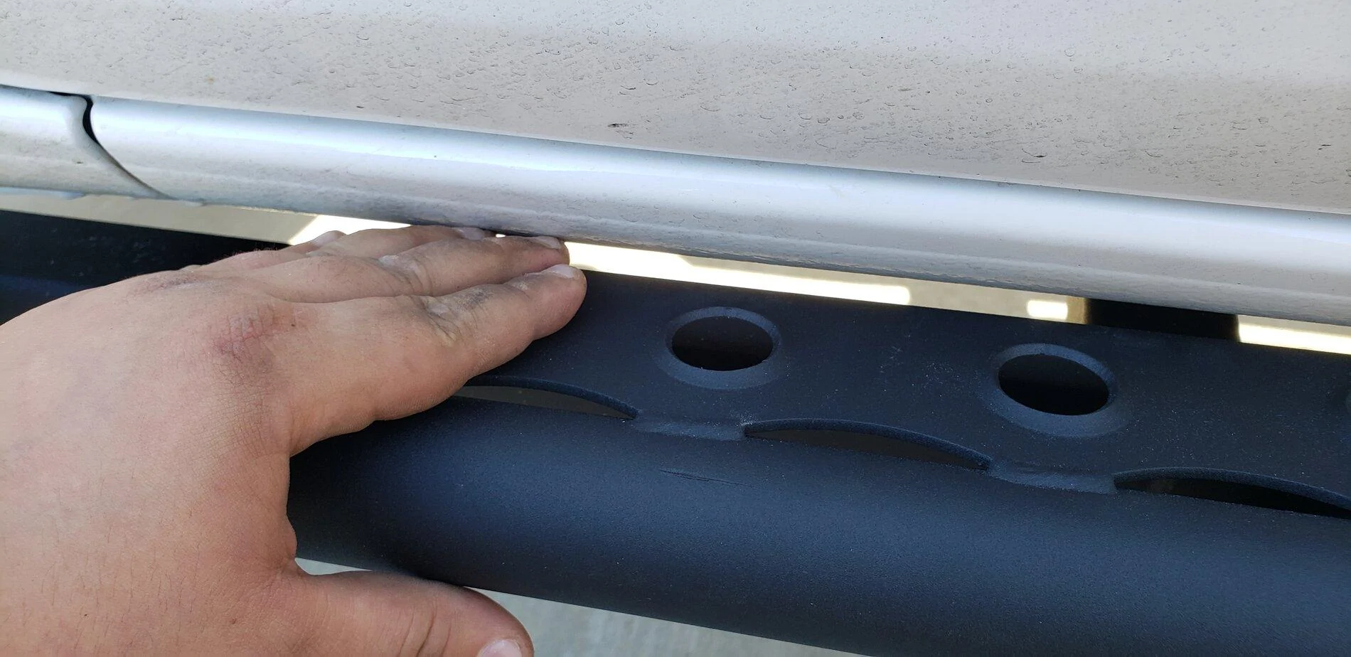

I'm going to send Shrockworks some pics - after seeing the latest thoughts in this thread, I inspected the install a little more carefully. Found driver front end to be only an eighth of an inch from the pinch-weld. I don't think that will do the trick with all this flexing y'all are talking about.
kinda concerned about the space midway too:
on the passenger side, I can slip my fingers in there a bit - not on driver side tho.
I got my shrockworks sliders yesterday and installed this morning with the same
I got my sliders yesterday and installed this morning with thr exact same outcome. Passenger side i can fit my fingers and drivers side i can't. Also on drivers side I am super close to pinch weld.
Pic#1 drivers
Pic#2 passenger
Pic#3 drivers pinch weld
