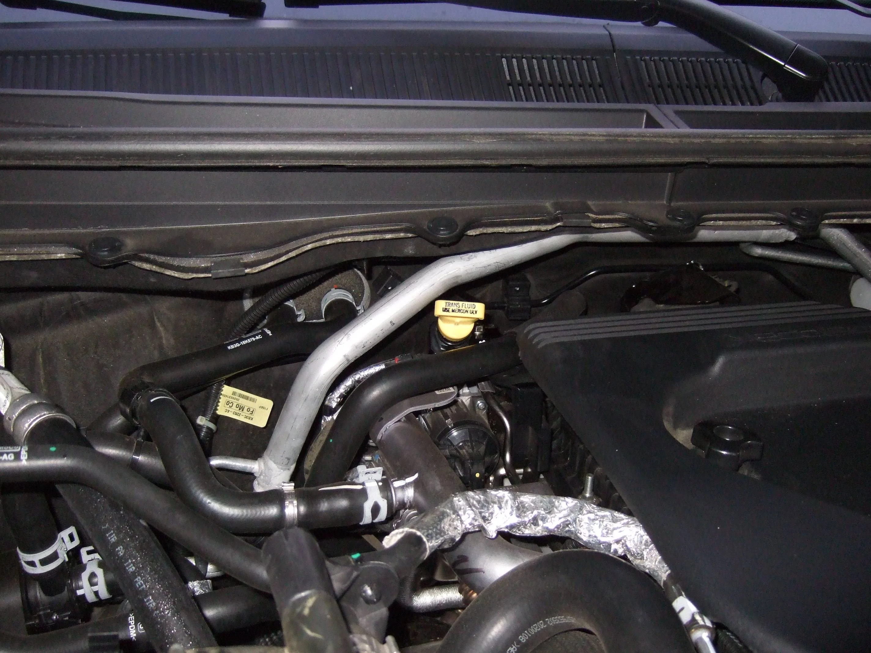

I'm not understanding what problems people are having with the harness...here's what mine looks like...the cables goes under the MBS aluminum head and the smaller cable is clear on the backside...the large harness attached to the tree is squeezed down when the bolt is tightened but nothing is pinched...
5,868
29,240
When I did my install yesterday, on my 2021 2 wheel drive, the stick tube inserted exactly like in the video. Right up to the firewall, with no problem from the wiring harness....it was positioned just as in the video.
My ac line is closer than in the photo from Sid, but not touching....maybe just the difference between his 2019 and my 2021.

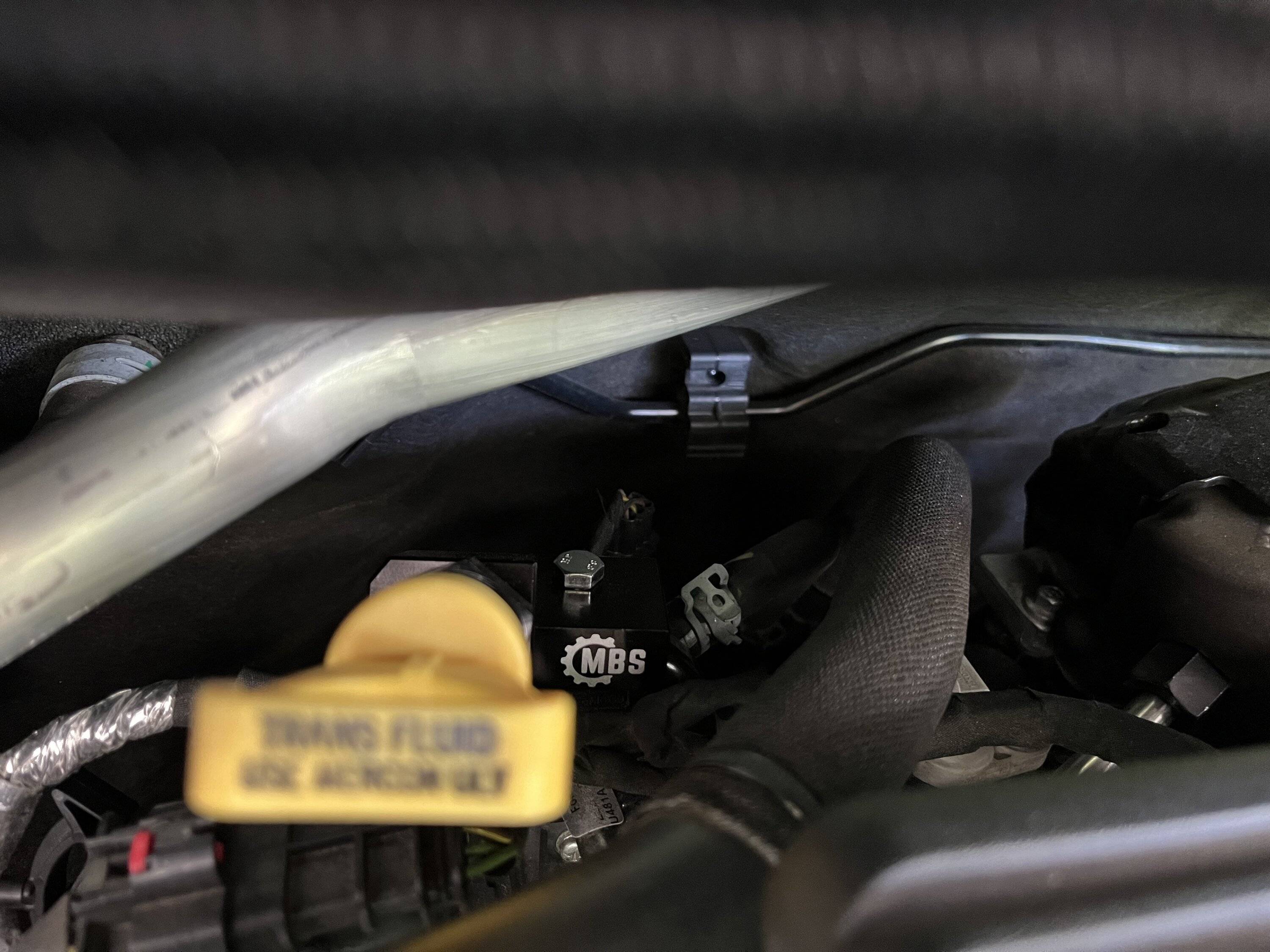

I had to route the small cable in front and under the dipstick tube. It was too short to go outside it. My small cable was not near the firewall at all. I am going to form the tab to get me a little more slack and then use a 3"-5" section of 1/4" split plastic wire loom tubing to protect the smaller cable. Just to be sure...
Here a picture of mine installed.

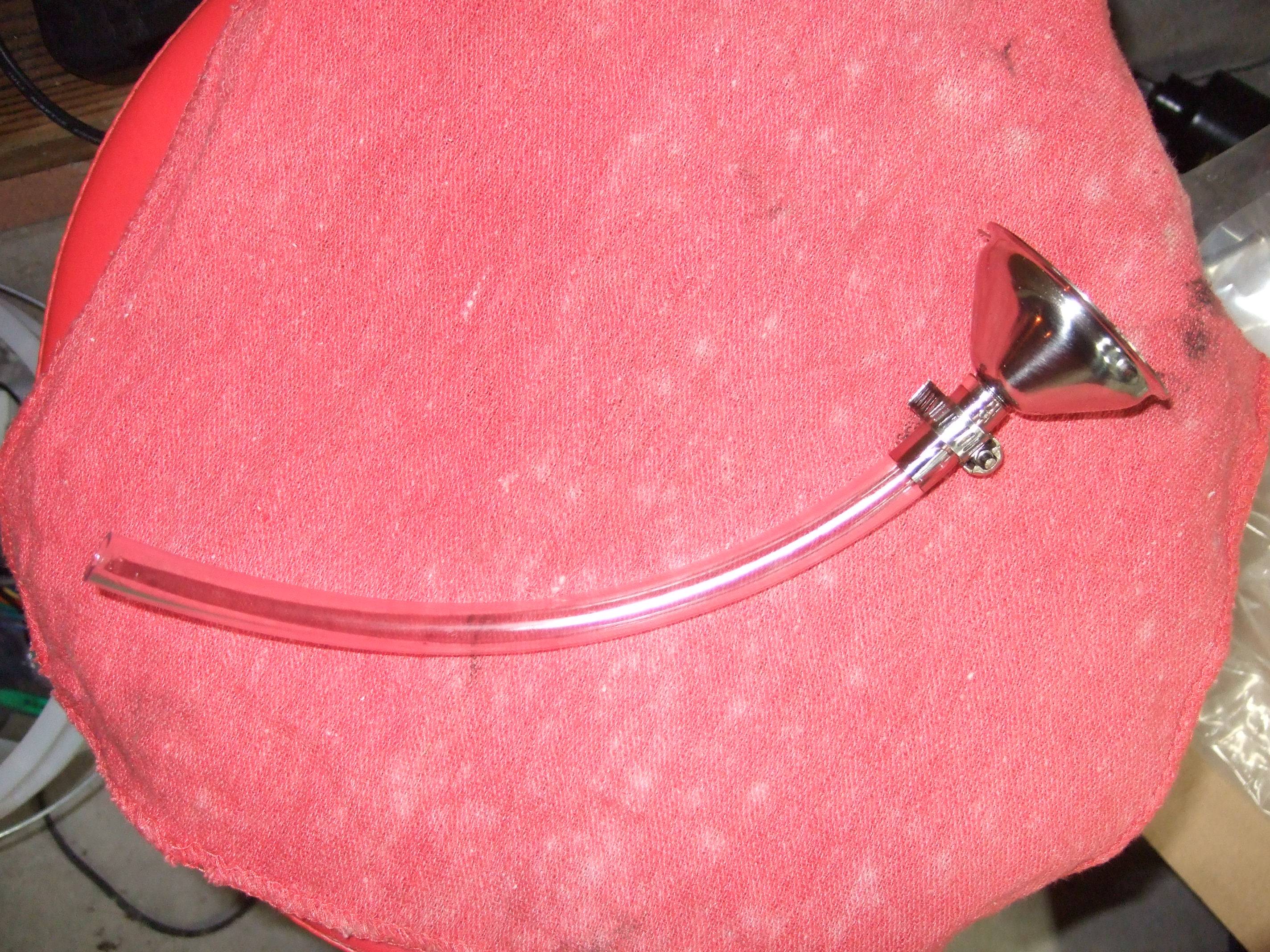

And here is my custom MBS Dipstick Funnel. 5 minutes of quality shade tree mechanic engineering! When inserted into the tube, it curves up and catches nicely on the cowl. The ULV fluid is so thin it drains quickly. My transmission was a 3rd of a quart low.

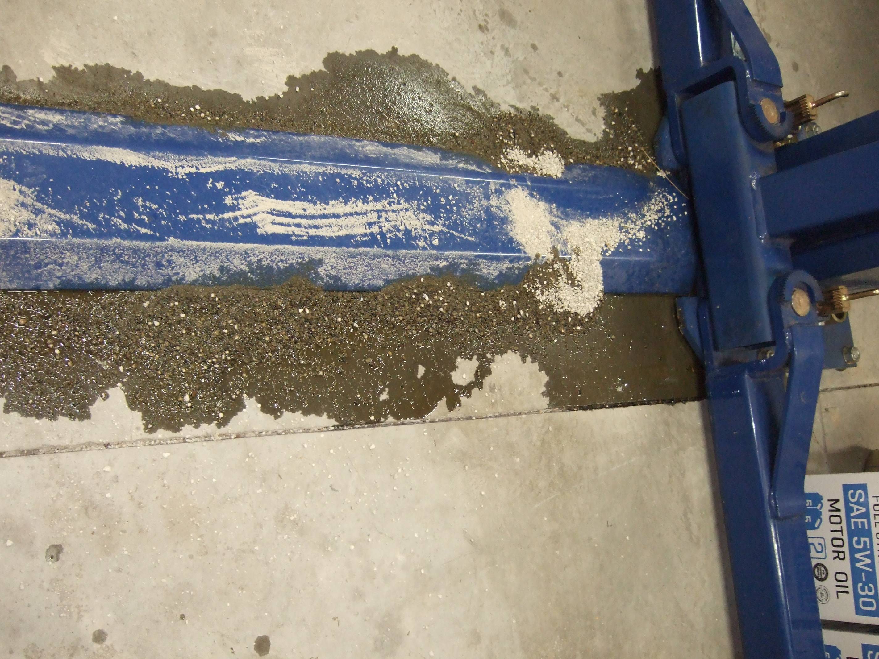

And here's my next project, replacing the hydraulic hoses on my bendpak lift. The good news is that it is an easy job. A bit messy, but easy. I haven't priced custom made hydraulic hoses lately, but I bet prices have skyrocketed just like everything else.

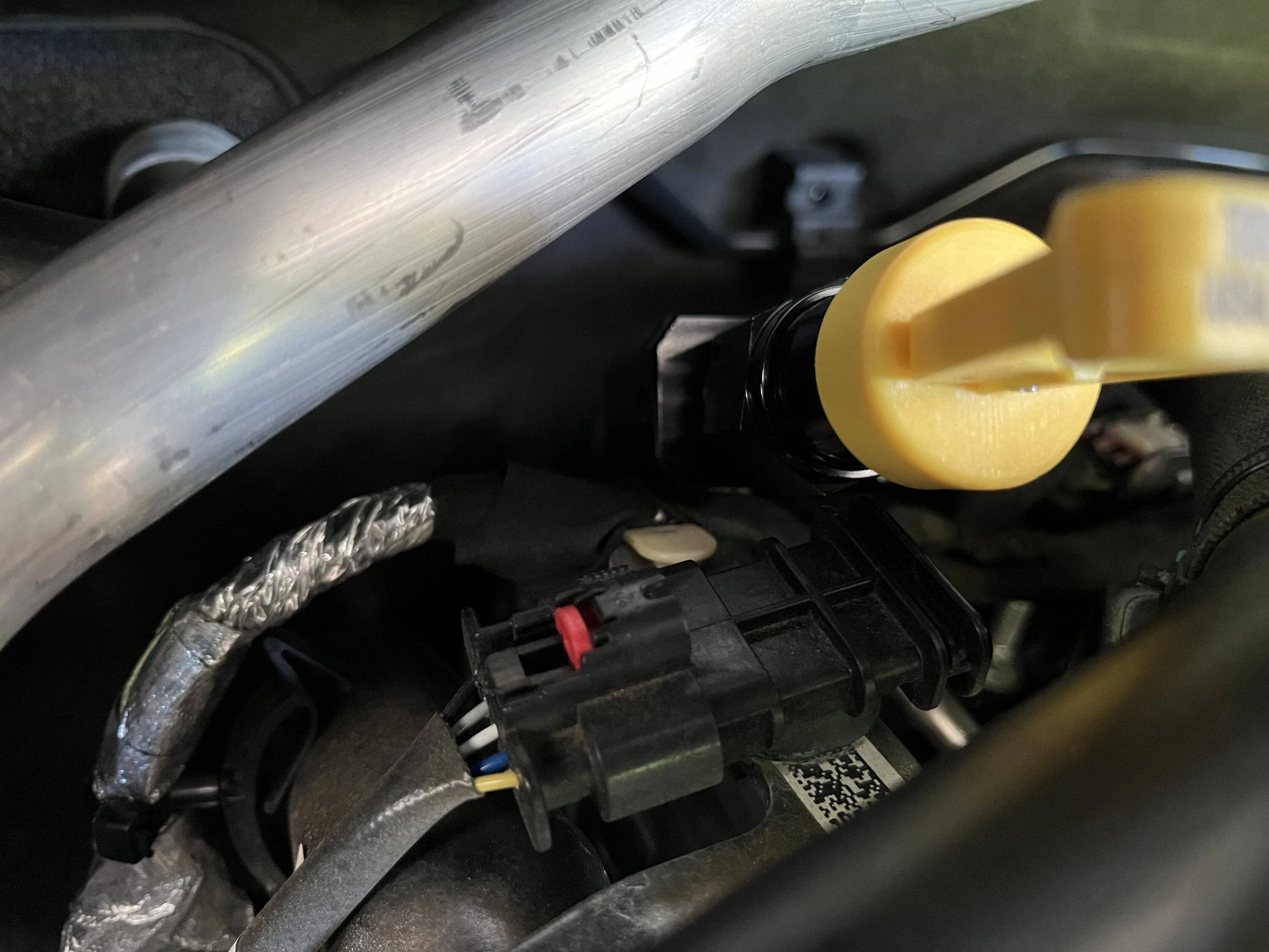

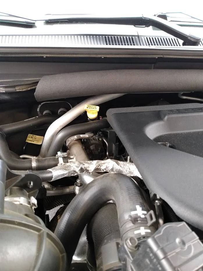

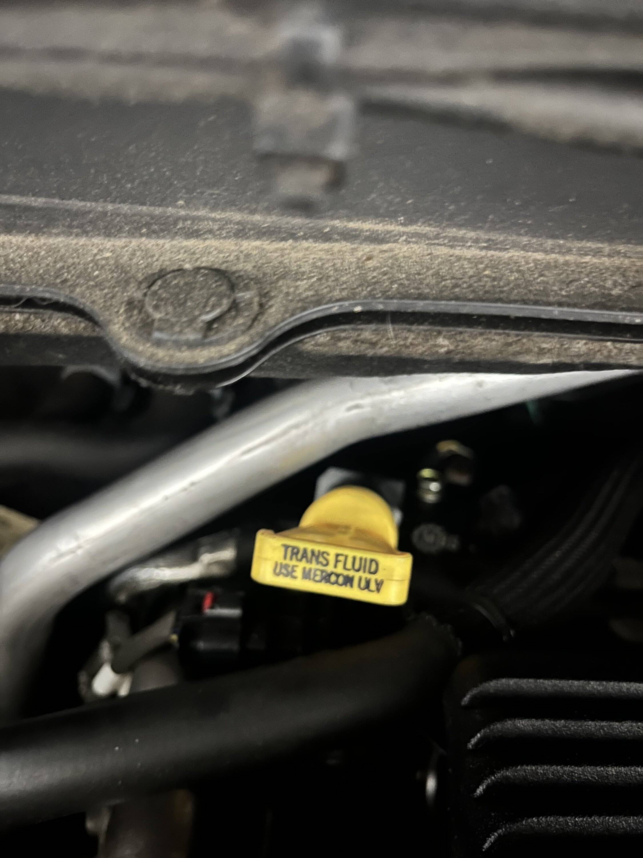

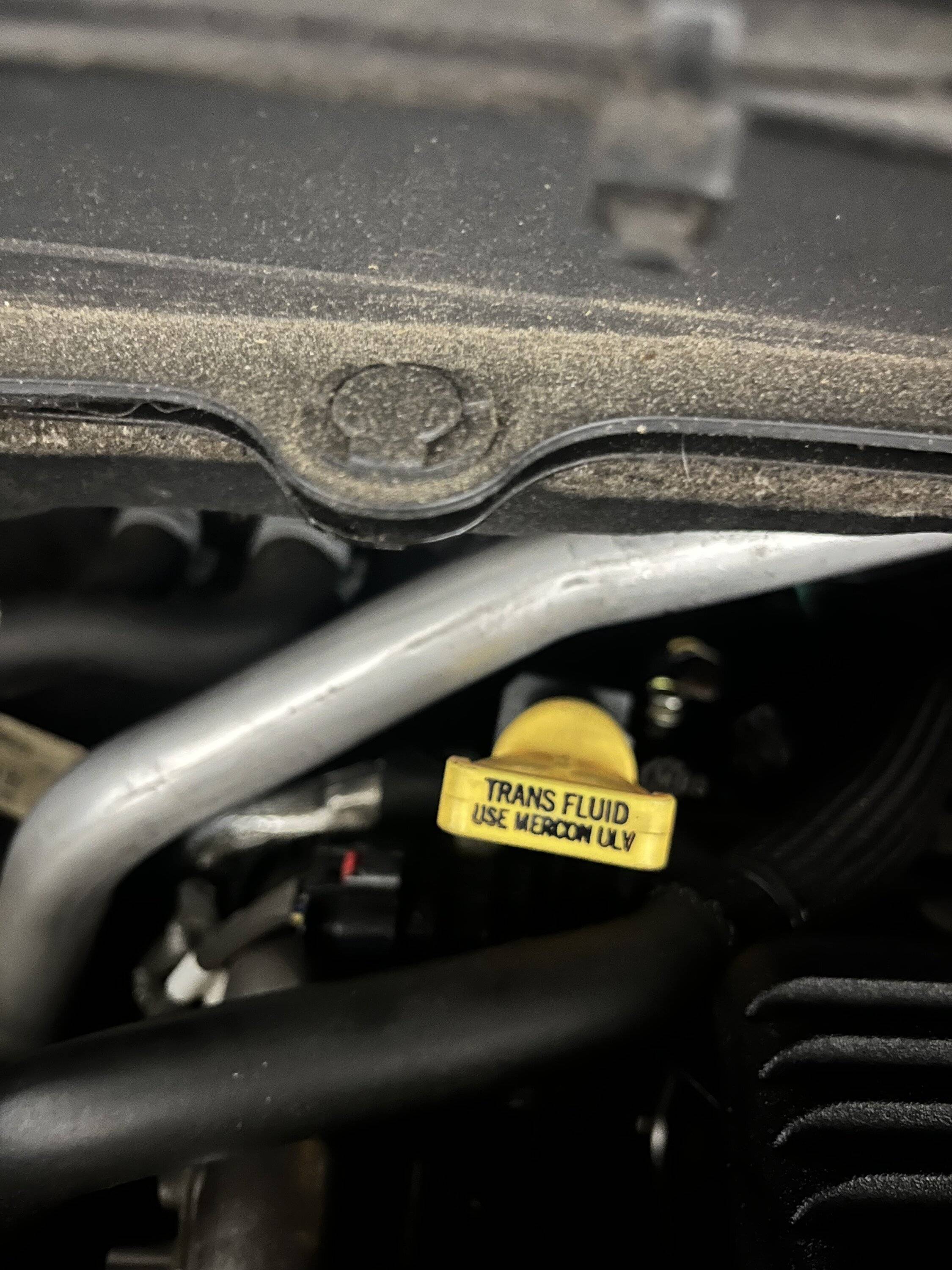

Installed mine today. Only pain in the butt was the need to remove front passenger wheel due to my Shrockworks skid plates. I had already swapped to aftermarket pan so I had not overly tightened my factory dipstick cover. I did route the tube too far back first time but figured out pretty quick. I had no issue with figment and the levels on dipstick matched factory exactly. Wish I had this couple months ago when I installed PPE pan. Fantastic quality work!
Photos attached but not sure how helpful they are?
The small loom that goes to the exhaust pressure sensor?
