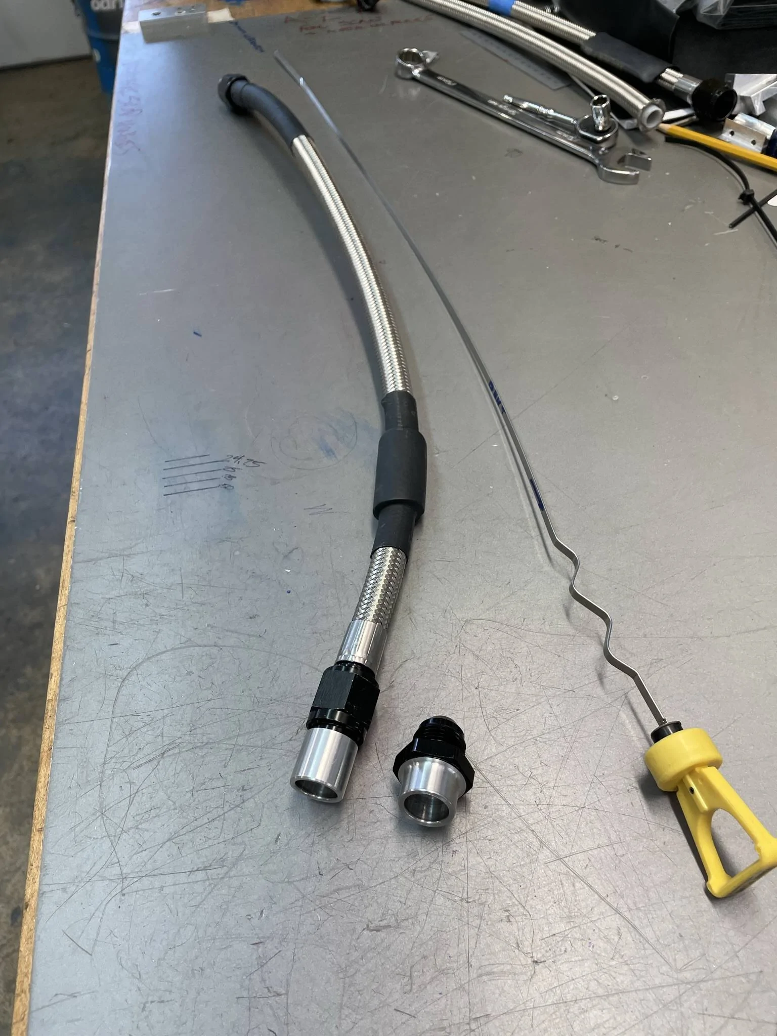

I'm off to pull the factory bracket off the engine to verify exact hole placement in the dipstick bracket, this is very important as it dictates the angle of the hose coming up the back of the engine, the register must be tight up against the bracket, then off to get another hose made, hopefully the final length, scrapped two of them so far.

Drawing is done except for the final 6mm mounting hole placement, hopefully I will have a printed version in hand soon to finalize that.

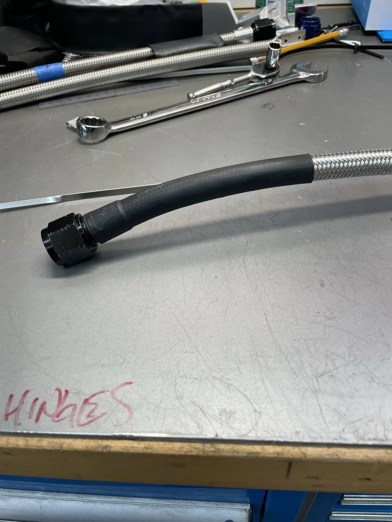

I have added heat shrink at the bottom to curve it away from the firewall, and at the top with a firm rubber pad to protect it as it goes across the back of the motor.
I am determined to keep it off of the firewall, the variance in the hose length from the mfg, has made this interesting, (turns out, it's up to 3/8" plus/minus) that's why the heat shrink had to be added.
This is still in the development phase, please hold off on any criticisms until I have the final version, as what you see now may be different then.
A hose that is exact to my required length is fine, clears everything, a hose 1/4"-3/8" longer touches the firewall, one 1/4"-3/8" shorter leans on the back of the engine, so I made my spec 1/4" longer and added the heat shrink, so now I can fit the different lengths properly.
The other challenge is the stick length, I had to machine up different length top fittings to keep the factory marks on the stick correct, yes, I still am trying to have a pre-marked stick, still in the plan, we will see in the end.

If I had my druthers, I'd rather it touch the engine over the firewall.
Absolutely, in the tunnel area the firewall pad is that soft material, anything touching it will eventually wear right through, not to mention the NVH that something bolted to a buzzy 4 cyl will cause.
So, I have criticisms, these are from my list:
What is the temp range of the heat shrink?
How many heat cycles is it good for before it goes rock hard, or starts to degrade?
Does the pad have additional adhesive if the heat shrink tension starts to degrade?
Fortunately, I found once the hose goes through a full heat cycle and completely cools, it's set, doesn't need any heat shrink or pad at that point, you would have to forcefully straighten it, and then it would still curl back into a twisted S.
If I was only building a handful, and really didn't care about making any money in this exercise, I would make a fixture that matched the installed angles (there are 3 very specific angles) and bake every hose in a oven, ship them out in a box with preformed foam to keep shape, no heat shrink or pad needed.
I wish I had stronger buying power, the low quantities that I am initially buying at, offers little to no discounts, one US made sample top bracket is $250, China made under a hundred gets me into the $20 something range, but only if I reduce some of the angles and radius's, 500+ will get me into single digit $, or if I want brass, out of India is pretty cheap.
So it's a work in progress, both from design, fit and Mfg.
