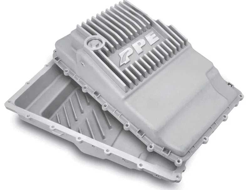

18K miles on my 2020 Ranger
New dipstick + New PPE deep pan + New Filter + New Transmission Fluid = Piece of Mind
Reports are that the extra 1.75 quarts lowers transmission fluid temps by ~10F-12F. My truck has shifted smoothly all winter, but since spring I have noticed a definite roughness in shifts. I am minimizing driving time until I complete this project.

Don't see how that can be the case, once the extra volume warms up, it'd going to be the same temp as the original oil volume. However If the new pan is bigger and sticks down further into the airflow under the truck, particularly if cast alloy, and it is finned on the bottom, then I can see how that might make a difference.
I am only parroting what has been reported. But I believe it to be true. It is cast aluminum with fins.
For instance (GM's variant of the 10R80 10 Speed Trannie)
Huge difference in temp. From day 1 my 2021 Silverado 1500 3.0L was hitting 210 to 230 Temps here in Arizona summers. Dealer service said it was normal that they run Temps after constantly returning with temp concerns. I installed the pan at 45000 mile oil change. Now temps at the peak of summer are 190 to 200 when sitting in traffic.
After installing I took it back to the dealer and they were shocked by the difference in temps.​
