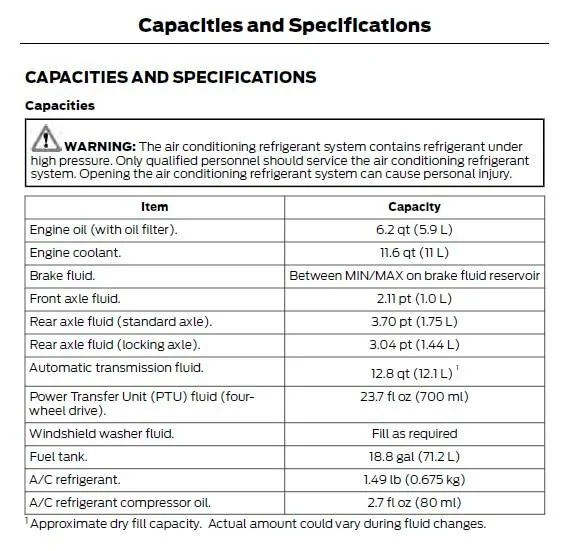

Owners Manual Page 319...

I don't have an owners manual in my truck I discovered. They did a dealer trade and I guess they forgot to put the owners manual in the glove box. So I need to get over to the stealership and get them to order me a manual. Thanks for posting up the fluid capacities.

Well do tell! Thanks very much!
