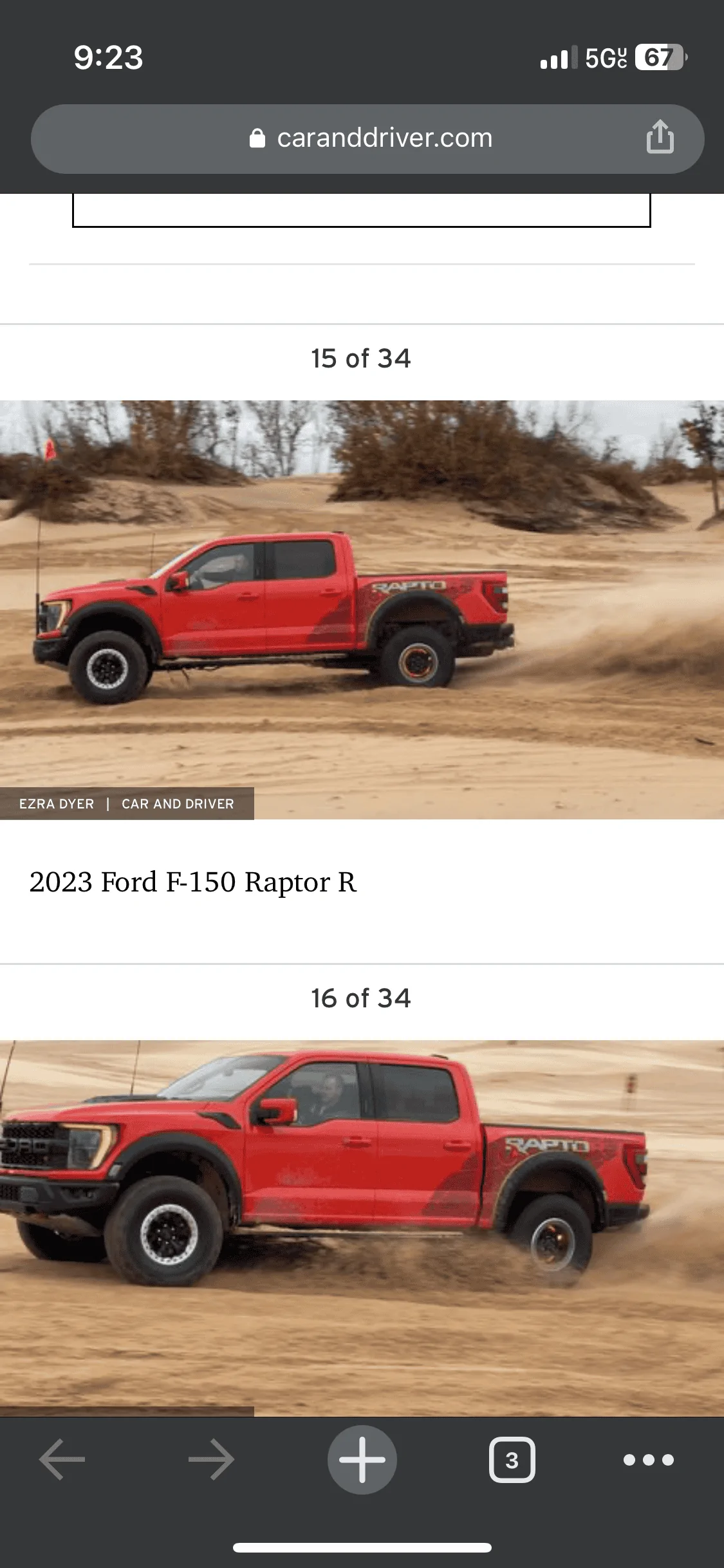

There is your answer! If turning off the traction control causes sliding well keeping it on uses the rear brakes to prevent said sliding.... Drive less crazy rear pads last longer.
Note rear brake rotor on the raptor r because of traction control systems.
