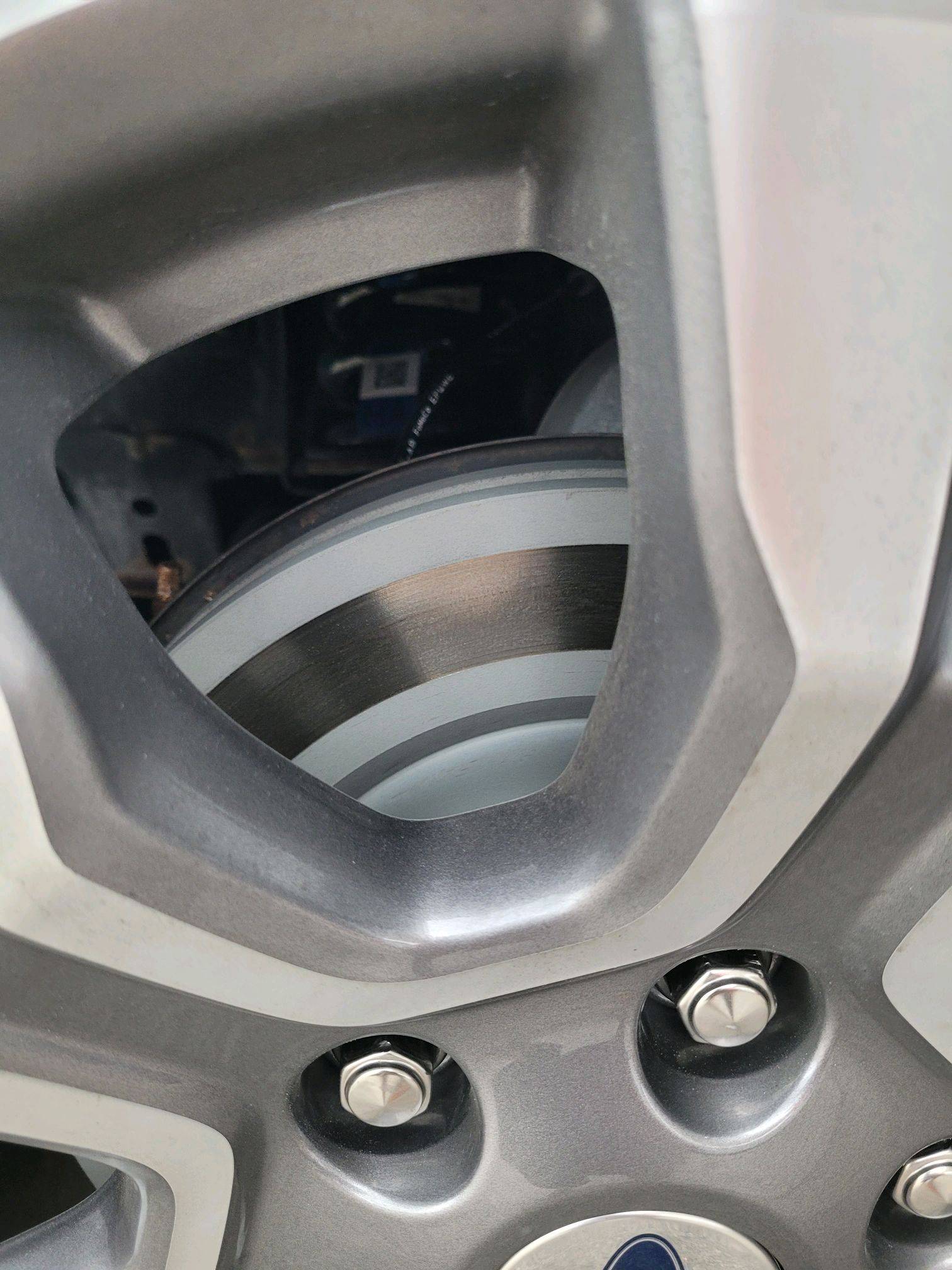

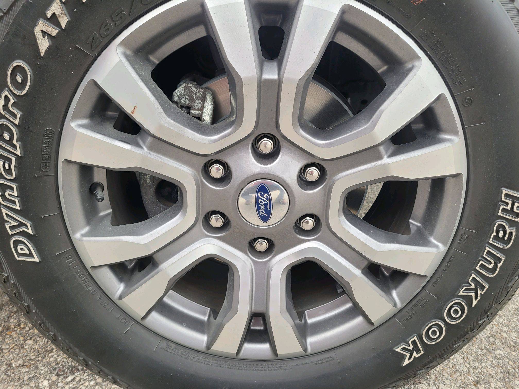

Ahh... the dealership informed me that this is odd and that they want to have it back to look it over. the odd thing is all the other new rotors are completely covered and the front driver's side is the only one with this "donut" issue on the rotor.
I will drop it off next Tuesday for them to check that rotor and to hopefully fix the damage on the wheel
Here is a photo of the passenger side for reference as well.
Passenger side rotor is brand new and the pad touches the full face...
And the driver's side with the pad only touching that small worn part of the face of the rotor
Doesn’t look right. You should be able to get a small mirror and see the pad on the rotor.
I am thinking one of (2)
The outer pad was not seated properly and tilted.
Or
The rotor was machined wrong, take a micrometer measurement, I bet the difference is noticeable.
I am curious if the I/B side ls the same wear
