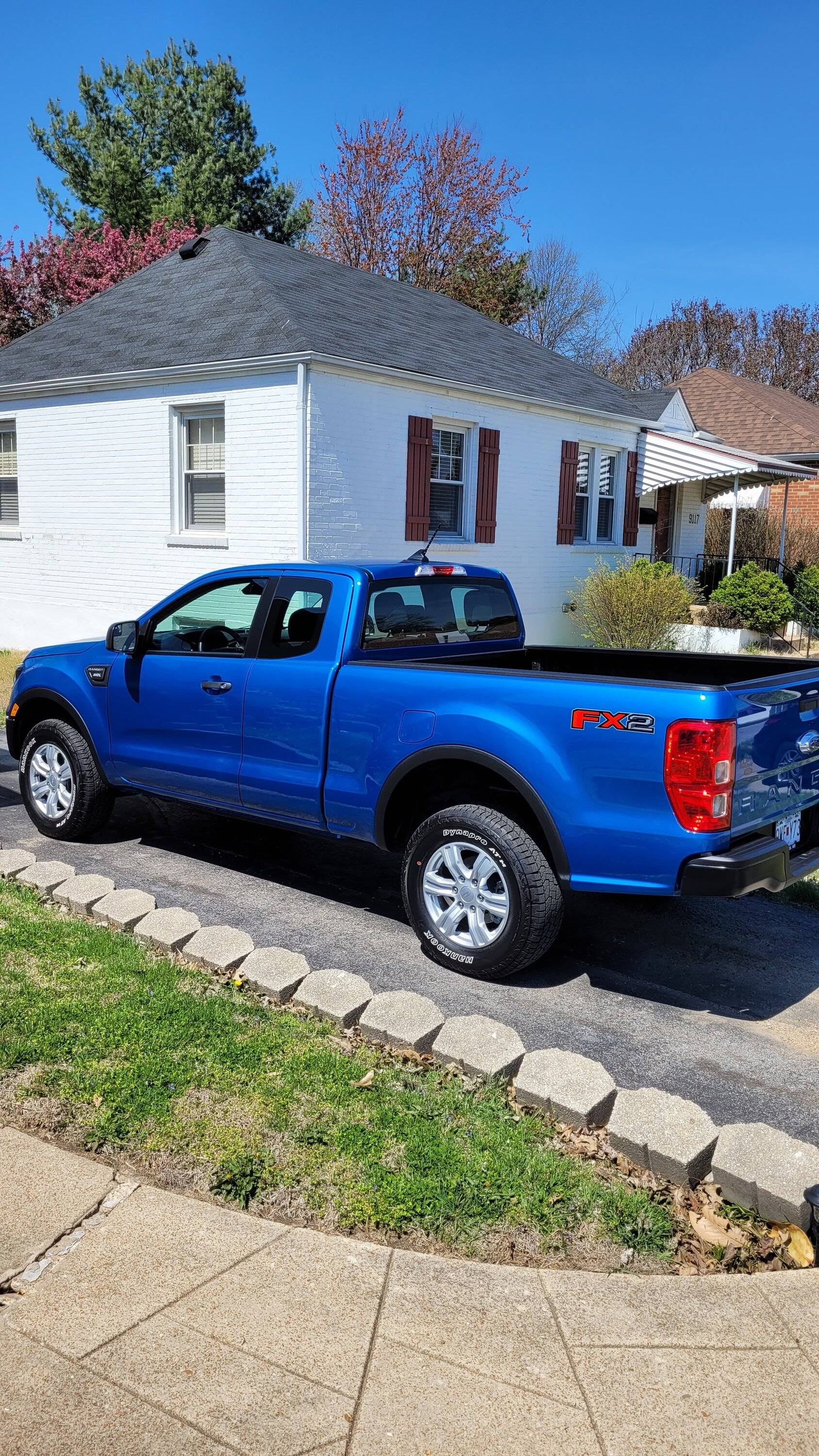

And here's a pic of Blue Dream, she's a 2022 with about 13k on her so far. I'm in love.
