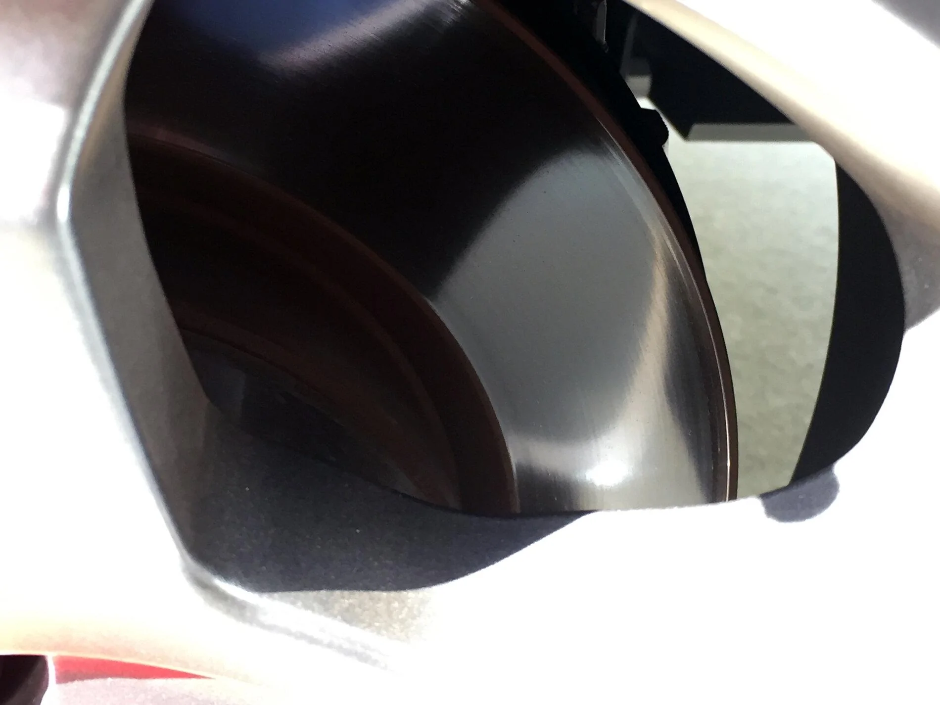

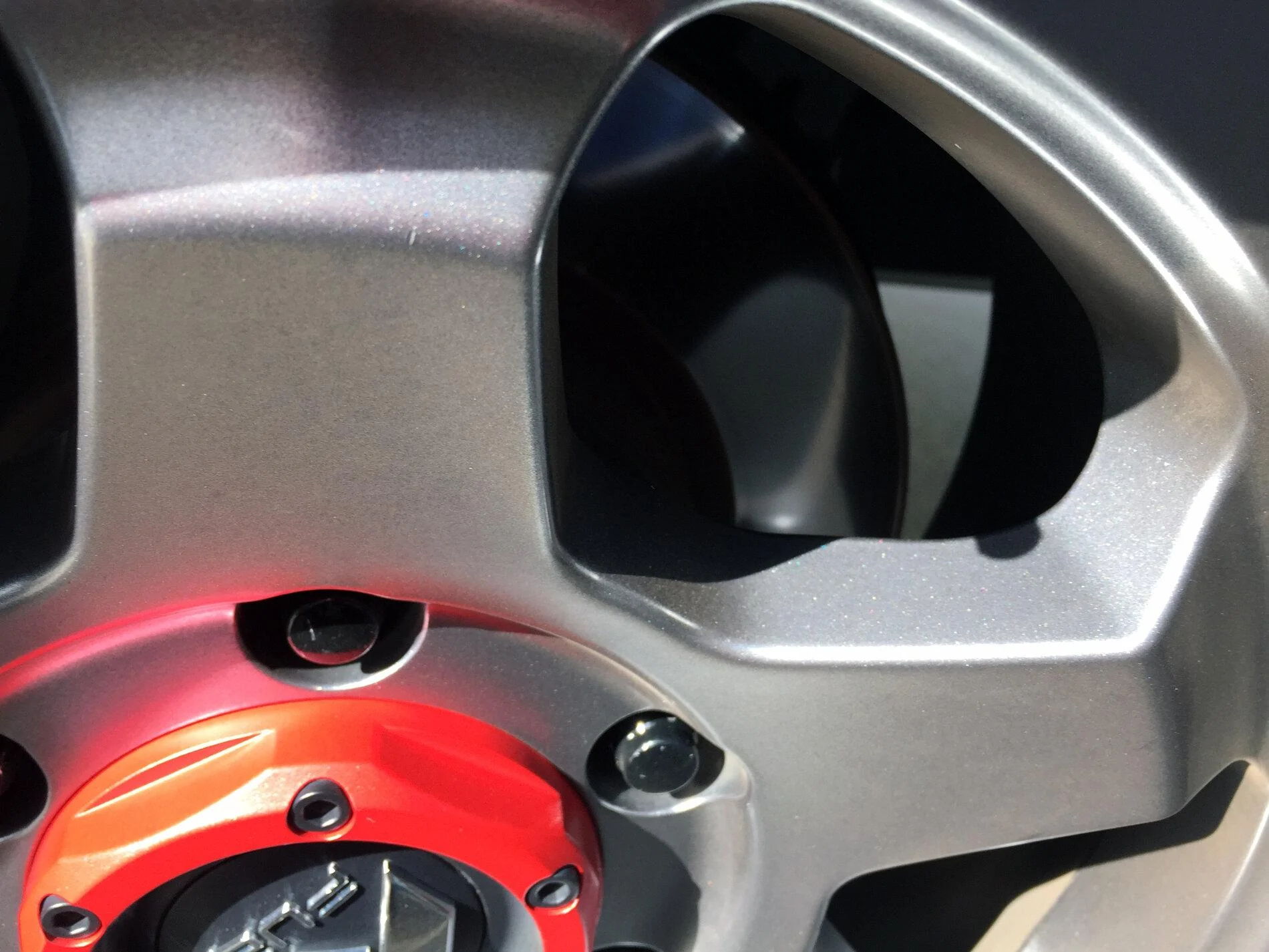

Here's a testament to how well Rangers brakes can wear when used with care...this is at 50,000+ miles with original pads (weighed in at 5,500 pounds loaded with gear)...rotors smooth and pads still have at least half life left...brake gently and avoid panic stops...?

@Msfitoy has clearly demonstrated his are still going strong after 50K so I'd again suggest taking them in to be inspected just in case. If something was manufactured/installed incorrectly they may even be deemed under warranty, you never know.
