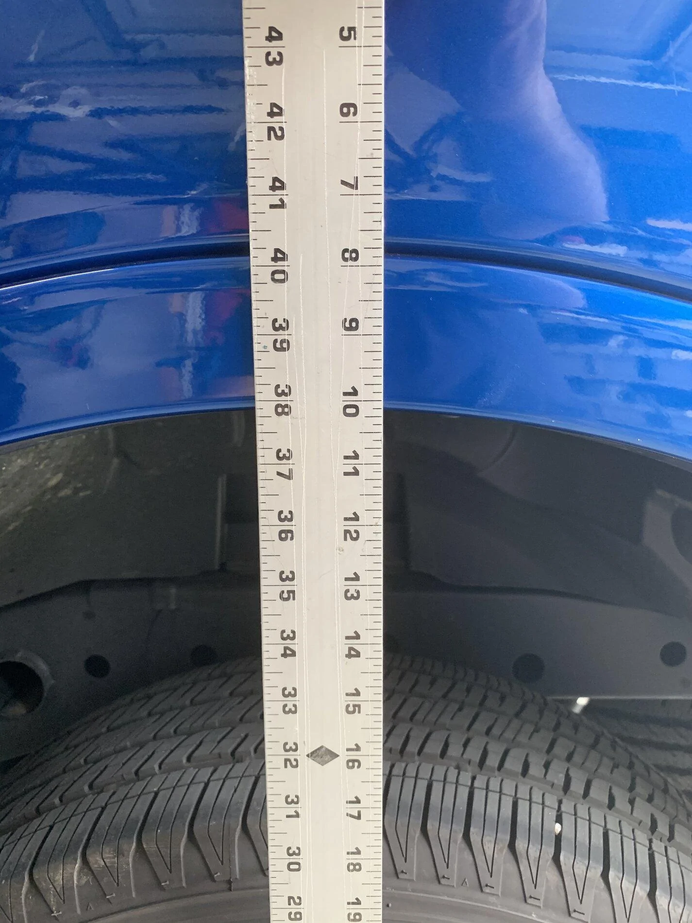

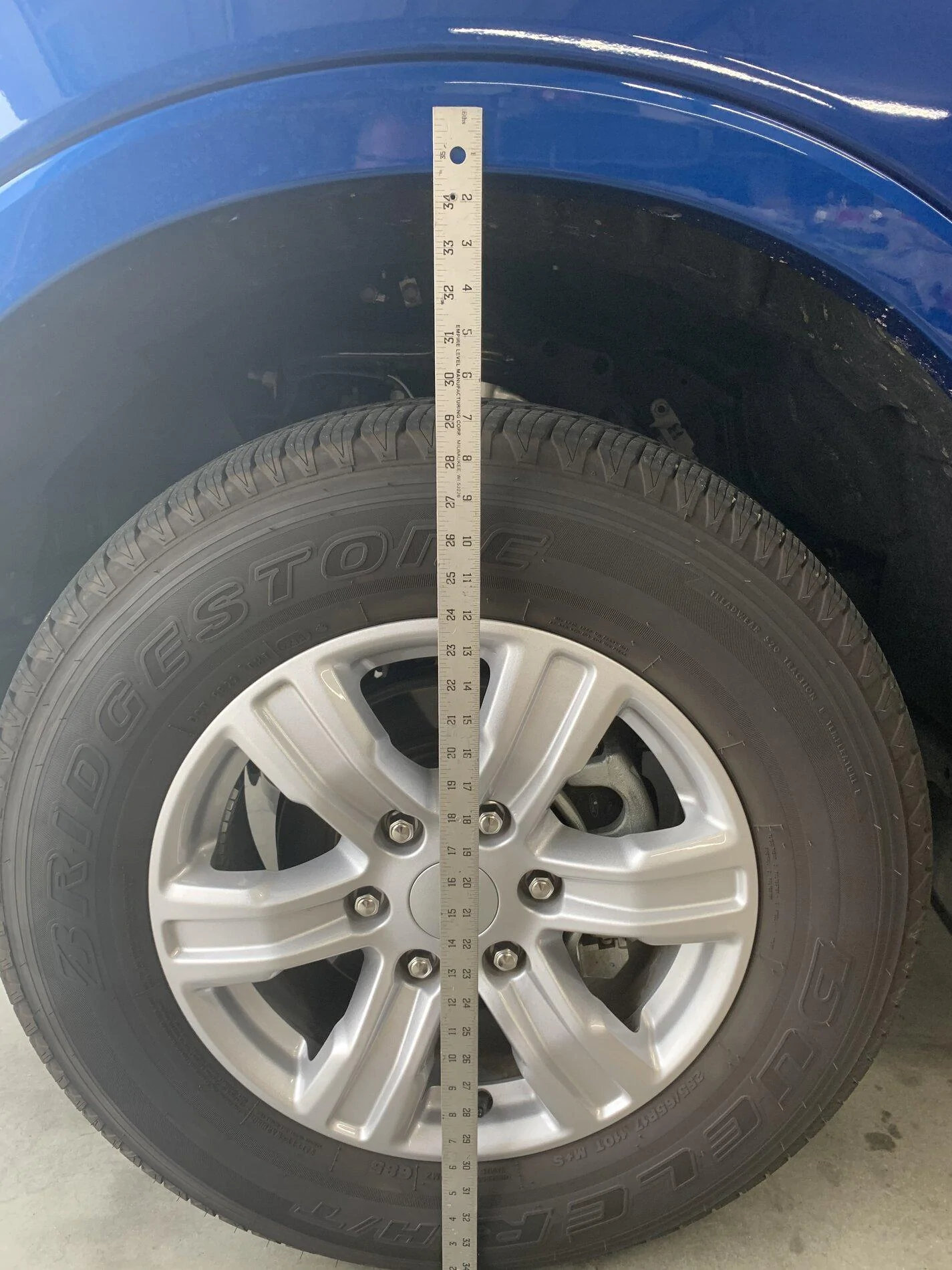

I just did the RC 2.5 inch level kit and it actually raised the front end 3", It was sitting at 35.5" from ground to bottom lip of fender and now it sits at 38.5". The rear measures 38". From the side and to the eye it looks dead even.

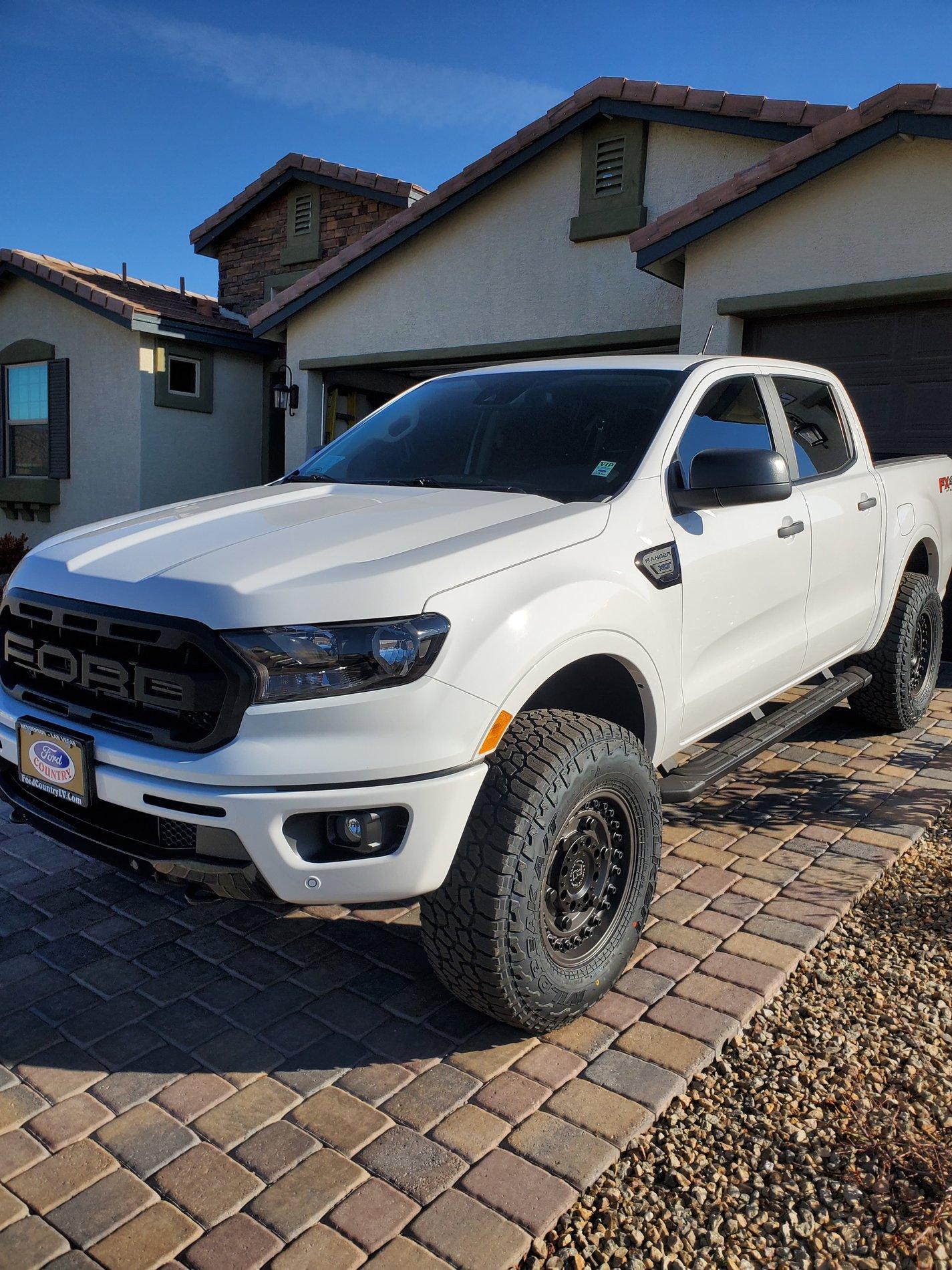

Just finished installing eibach pro truck lift with black rhino armory and 285/70r17 wildpeaks
Nice wheels. I've heard that the center cap is plastic and pops off easy and feels cheap. Have you had any worries about the cap or have you found a better replacement for the cap?
The cap is plastic but it is held on with an Allen screw only way it would pop off is if you don't tighten the screw all the way

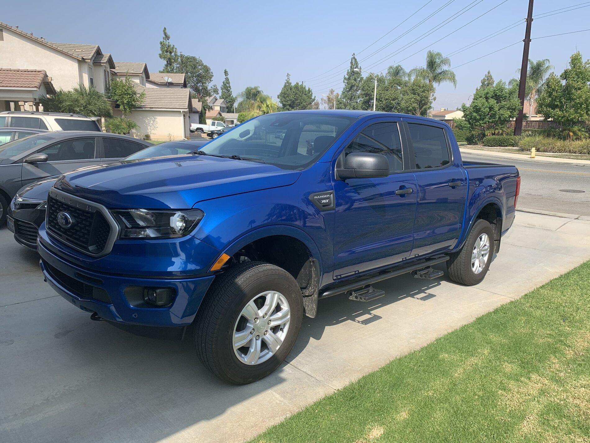

This past weekend I installed the Fox 2.0 leveling kit from Stage3Motorsports on my 2019 XLT 2WD and the ride is like night & day compared to the stock shocks, very happy with the ride! Basically muted the road. Paid $1199 on sale. Supposed to take 4-6 weeks because of Covid but I got the front coil overs in about 2 weeks and waited a week to install because it was so fricken hot, the rear shocks arrived that Saturday while I was installing the front coil overs, nice! Was supposed to raise the front about 2.5” but actually got 3”.
"Muted the road" indeed! I am so happy with the FOX 2.0 kit on my Ranger! Glad you got the results you wanted!
