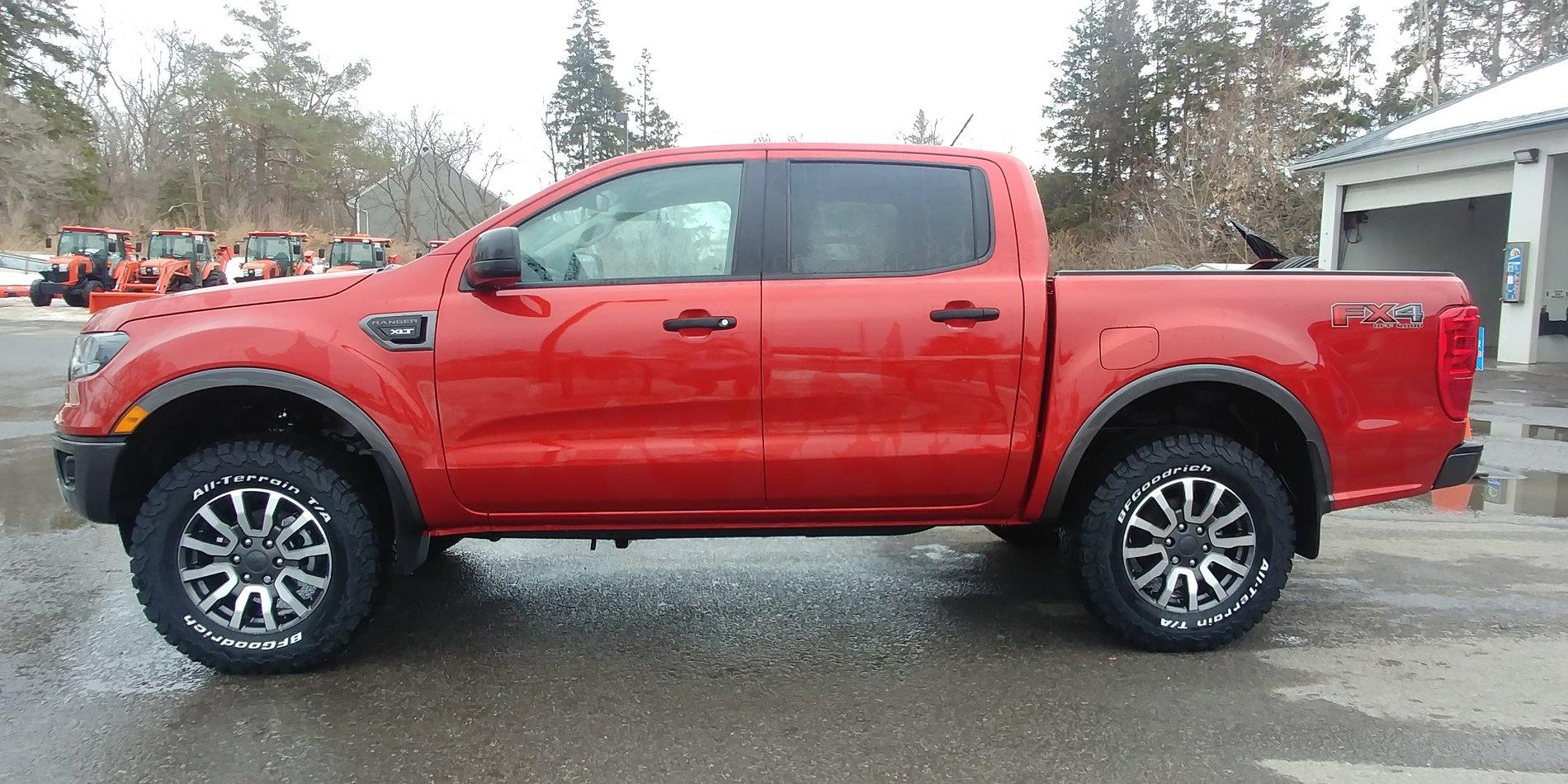

almost forgot....Ford Performance Fox Off Road Shock kit M-18000-R.
If you wish, you can add my truck to the list. LT265/70R18 BFG K02s. I haven't had time to do an interference test, but I've tried opposite lock, and is good so far. Will update later.

The only downside that I experienced was a slight loss in MPG, which makes sense, given that the truck will be slightly less aerodynamic with the front end two inches higher than before. Otherwise, I love that kit, best thing I have added to the Ranger. It smooths out the ride, gets you more clearance underneath, and gives you a higher position with better vision. If you do decide to order, you can get it for about 250.00 cheaper at https://www.levittownfordparts.com/part-ymm/2019-ford-ranger-suspension-kit.html. Wish I had known that at the time! Live and learn....

Can my 2WD Ranger dudes post some pics and results of the Fox suspension level/lift?
I have heard a couple different “results” about height and would like to know how much lift I will truly get on a 2WD truck.
I have a true 3” level and really want to stay around that height. Pics and info welcomed.
