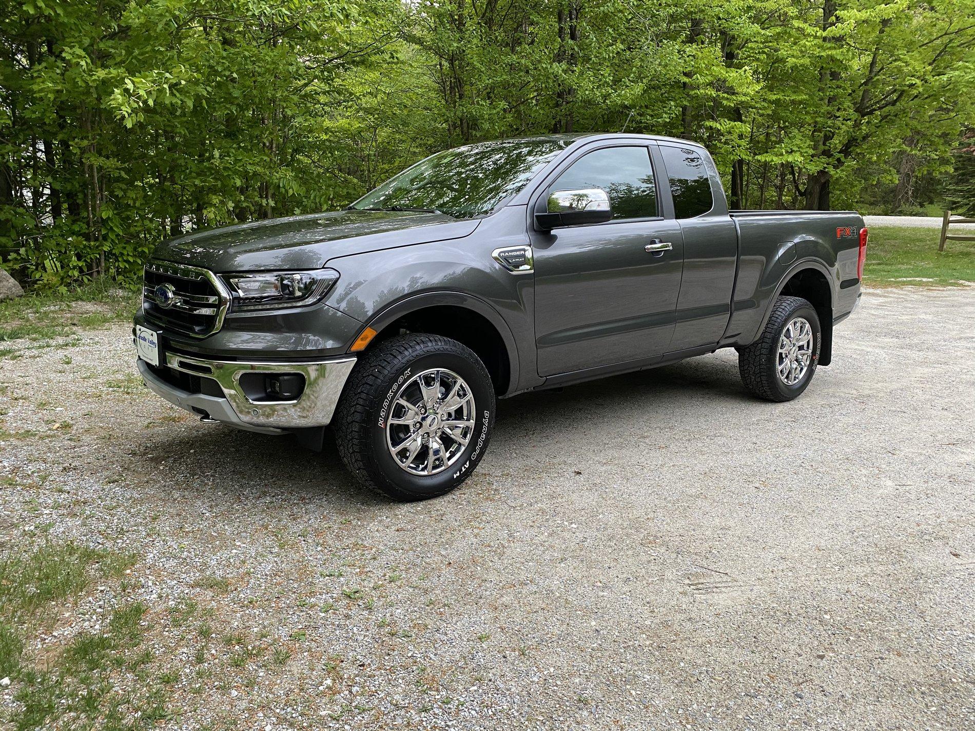

Just installed the Ford Performance Fox 2.0 leveling kit.
I hope everyone has checked their truck for level with this kit. I know they are advertised as “preset out of the box” but mine weren’t even close.
1/4” difference in height from left to right and the front was about 1” taller than the rear with no weight in the truck.
After driving the truck about 1k miles with the kit installed and setup properly my front is sitting just over 7/8” lower than the rear with no weight in the bed. I hate the reverse rake look.
For background info I race cars on the track and am very familiar with corner balancing cars with adjustable sway bars, coil overs, reservoir multi adjustable shocks, etc.
NvrFinished
Shea
Apr 27, 2020
608
1,161
SoCal
2020 XLT 4x4 Rapid Red
Interesting... I didn't think these kits were even capable of lifting that high. I was under the assumption that 3" was the max height they could go - which supposedly is just enough to make the truck level. But yours was 1" higher in the front than the back?
I'm a track guy as well and have a spot in my garage where I check ride heights and do my camber changes and alignment before I go to the track. I plan on checking my ride heights before and after kit installation. I know that I don't have the lean in the rear that people have complained about.
So what made you finally decide on the Ford Fox kit vs. the aftermarket Fox kit? I'm still trying to figure out which is best for me.
berlow94
Andrew
May 26, 2020
72
105
Keene Valley, NY
2020 Ford Ranger Lariat, 1987 BMW 325IS Track car, 1979 Mazda RX7
I think that is the main difference between the Ford Performance and the aftermarket Fox kits. The coil spring on the FP kit being 2" longer in overall length puts the threaded collar lower on the shock body and allows for more overall lift height. (Assuming that the shocks on both kits are dimensionally the same. Still trying to get a solid answer as to the valving differences)
I messed around with the heights for about 4 hours before locking it down and aligning the truck.
Even went as far as leveling the frame of the truck to the alignment rack and leaving the front wheels off to ensure that the back was level from the factory from left to right.
It was a pain in the ass compared to my track car since with the track car I have the car up on corner balance scales, each spring has an adjustment collar, and I can completely remove the adjustable sway bar end links. It's relatively easy to adjust each wheel height independently and move weight around in the car to get my cross weights 50%/50% and the car level at the same time.
With the truck I don't really have any weight to move around, no adjustable sway bar links, and I can only adjust the front spring perches.
As I mentioned before, I ended up with the truck within 1/8" level left/right up front which I needed to leave to keep the rear 100% level left/right, and about 7/8" lower in the front vs. the rear. Aligning it was easy after that. An even +0.2 degrees of camber, and even 3.2 degrees of caster and just a lick of toe in. (I don't like the factory adjustment of unequal caster and camber left/right to accommodate for the crown of the road)
