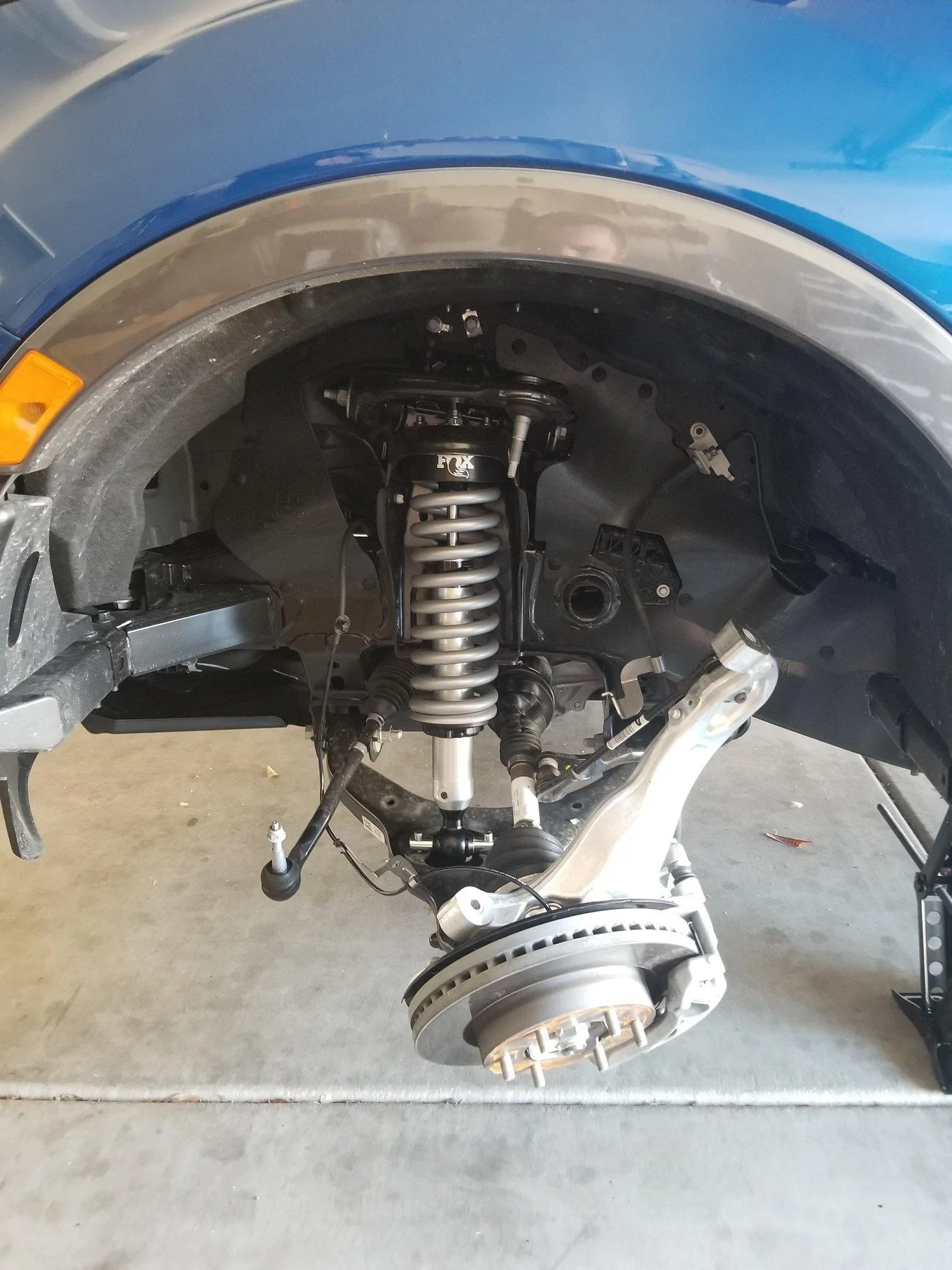

My FP/Fox
Fox

I haven't seen them both in person but it looks to me like the Ford Performance set and the aftermarket Fox set have different springs.
My FP/Fox
Fox
What are the part numbers on your Ford Fox front coilovers? On my Fox coilovers, the springs say 1400-300-550-0619 but the 0619 is in very small print. On the top of the shock body it says 985-02-133 and 278164PP. For the rear Fox shocks, on top of the shock body it says 985-24-207 and 327377.

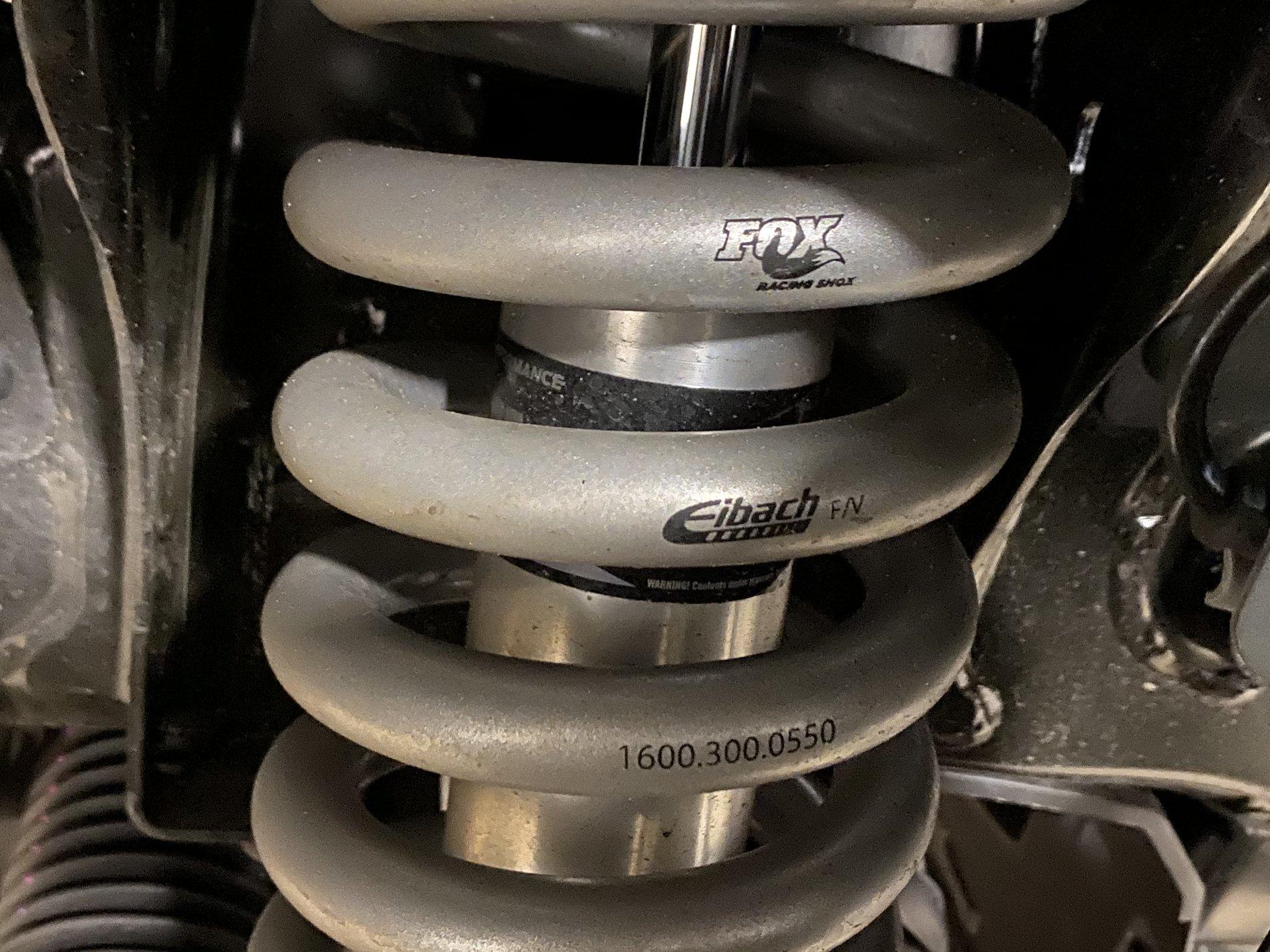

Here’s a pic of the Ford Fox kit spring P/N. I guess it is different.
Now, how do we decipher what all the numbers mean? There must be a difference between the Fox and the Ford/Fox springs on the front coilovers.
