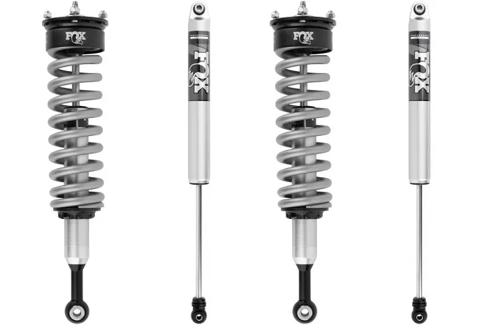

I'm pretty sure these are just the FOX 2.0 coilovers that are already available just set to 2" of lift - aren't they? Maybe with some custom FP tuning?
https://www.stage3motorsports.com/9...0-IFP-Performance-Front-Coilovers-3-Lift.html for example.
Assuming that Ford is giving us rear shocks in the deal (which point is unclear in its advertising), we would be paying $1,495 for parts that are available from stage3 for about $1,2780, as shown here:
2019 Ford Ranger 4WD FOX Stage 1 Suspension Package
FOXRNGRSTGE14WD%202019%20Ranger%204WD%20FOX%20Stage%201%20Suspension%20Package%2000.webp
Part#: RNGRSTGE14WD
1 Review(s) Write a Review
2 Customer Q&A(s)
$1,279.80.
But Ford advertising to date does not specifically say that rear shocks are included....

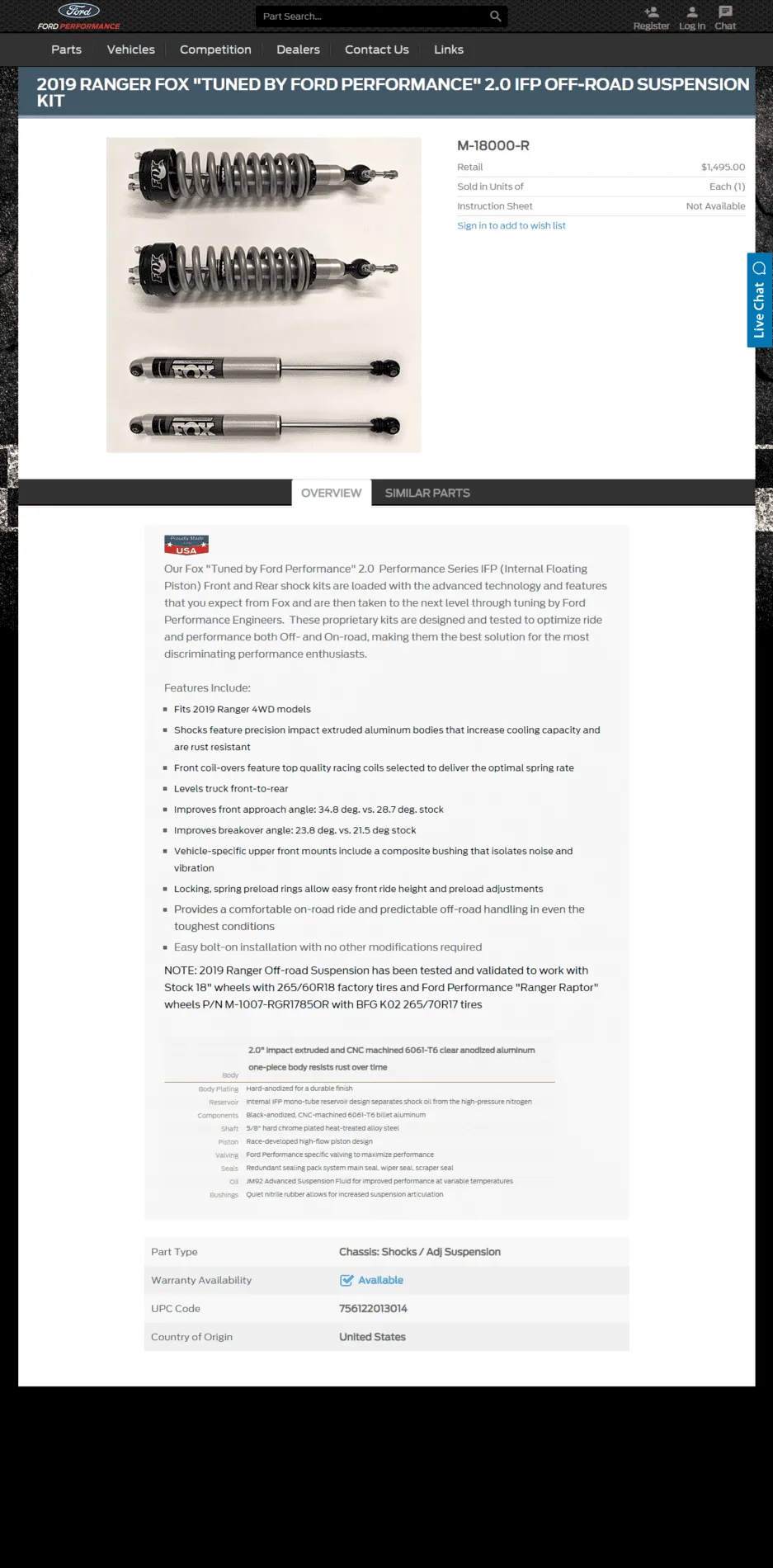

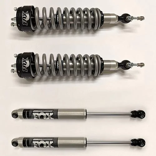

This just popped up - looks like its front and rear.
https://performanceparts.ford.com/part/M-18000-R
Our Fox "Tuned by Ford Performance" 2.0 Performance Series IFP (Internal Floating Piston) Front and Rear shock kits are loaded with the advanced technology and features that you expect from Fox and are then taken to the next level through tuning by Ford Performance Engineers. These proprietary kits are designed and tested to optimize ride and performance both Off- and On-road, making them the best solution for the most discriminating performance enthusiasts.
Features Include:
  • Fits 2019 Ranger 4WD models
  • Shocks feature precision impact extruded aluminum bodies that increase cooling capacity and are rust resistant
  • Front coil-overs feature top quality racing coils selected to deliver the optimal spring rate
  • Levels truck front-to-rear
  • Improves front approach angle: 34.8 deg. vs. 28.7 deg. stock
  • Improves breakover angle: 23.8 deg. vs. 21.5 deg stock
  • Vehicle-specific upper front mounts include a composite bushing that isolates noise and vibration
  • Locking, spring preload rings allow easy front ride height and preload adjustments
  • Provides a comfortable on-road ride and predictable off-road handling in even the toughest conditions
  • Easy bolt-on installation with no other modifications required
NOTE: 2019 Ranger Off-road Suspension has been tested and validated to work with Stock 18" wheels with 265/60R18 factory tires and Ford Performance "Ranger Raptor" wheels P/N M-1007-RGR1785OR with BFG K02 265/70R17 tires
Body 2.0" impact extruded and CNC machined 6061-T6 clear anodized aluminum one-piece body resists rust over time
Body Plating
Hard-anodized for a durable finish
Reservoir Internal IFP mono-tube reservoir design separates shock oil from the high-pressure nitrogen
Components Black-anodized, CNC-machined 6061-T6 billet aluminum
Shaft 5/8" hard chrome plated heat-treated alloy steel
Piston Race-developed high-flow piston design
Valving Ford Performance specific valving to maximize performance
Seals Redundant sealing pack system main seal, wiper seal, scraper seal
Oil JM92 Advanced Suspension Fluid for improved performance at variable temperatures
Bushings Quiet nitrile rubber allows for increased suspension articulation
