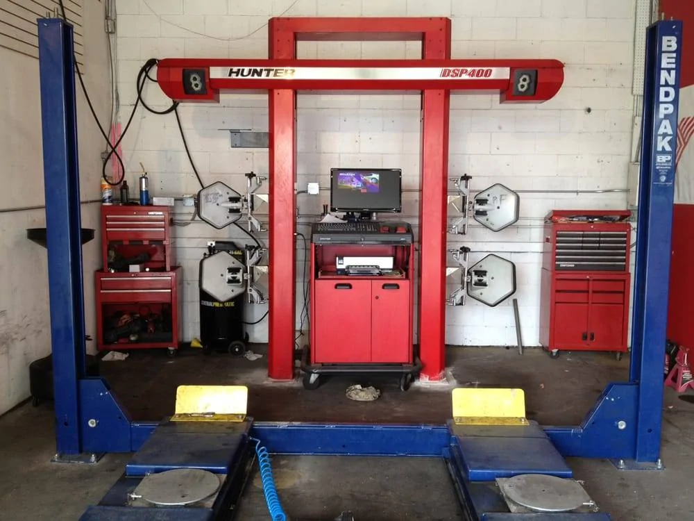

My local mechanic is well equipped with a 4 wheel alignment apparatus, etc. Someone mentioned previously about vehicles arriving with high tire pressures. I recall being told the factory raises the pressures to ease the alignment procedure at the factory - dealers are supposed to correct the pressures before delivery. The shop that installed my new shocks last week also raised the pressures up to 42psi before the alignment and set the values back to 32psi afterwards - same explanation. (stock image)

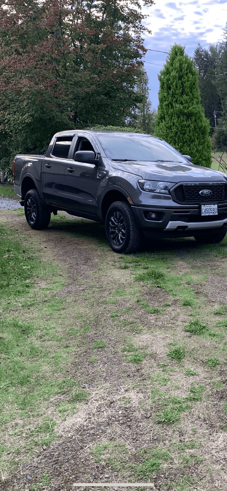

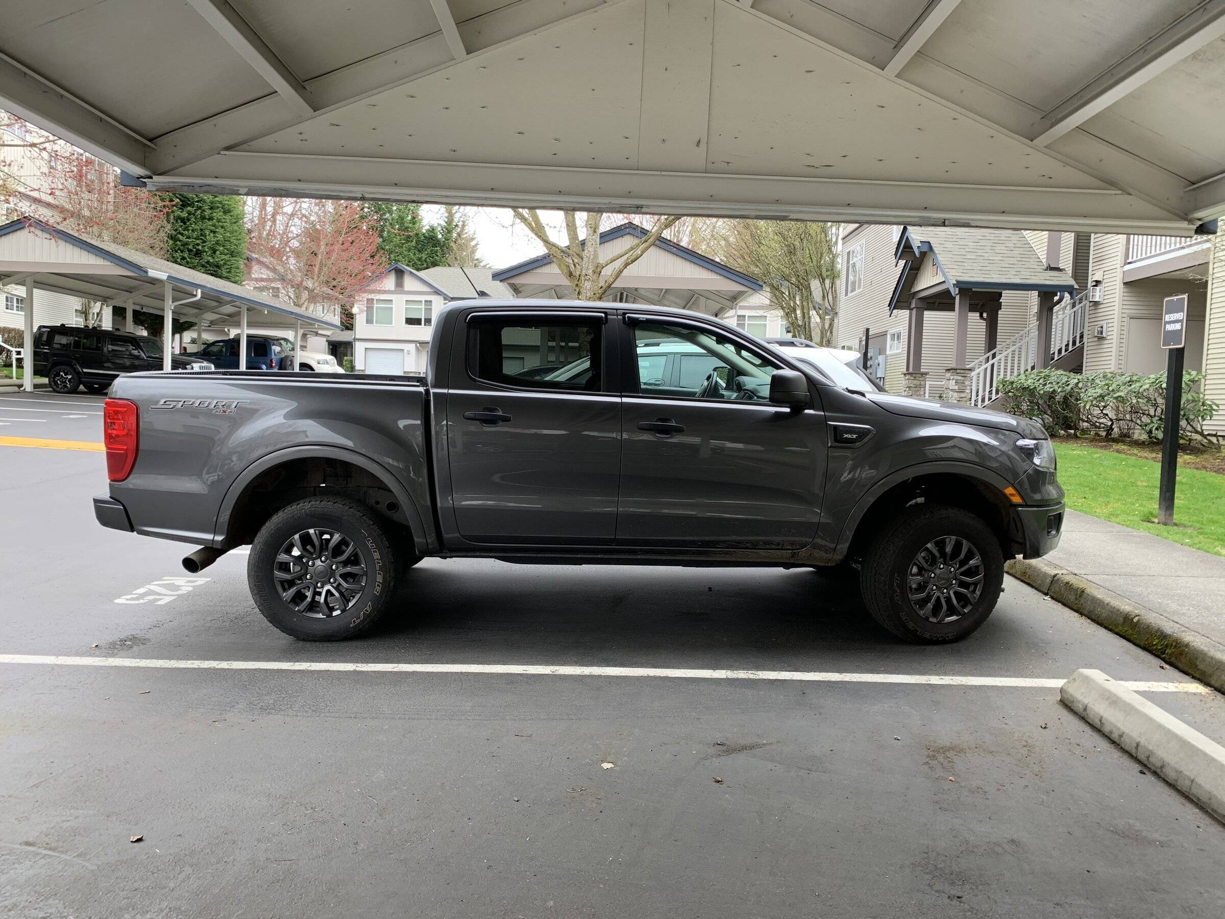

Just installed front B8 shocks and rear OME nitro charged shocks in mine. I love the stance. The rear went down about an inch and the front raised about the same (front adjustable ride height shocks set at middle tick). They are just as comfortable on a flat surface as the stock FOMOCO shocks. With the new setup, going over bumps/grooves, the tires feel much more planted and quiet than stock. I cant but can wait to put bigger tires on since mine are still new… before and after photos.
After:
Before:
allignment was not needed, as I was told by the installation shop.

I would be hesitant to accept that an alignment wasn't needed. It's possible, but getting our front strut/spring assembly out of the truck typically requires breaking apart the knuckle from one or both ball joints, as well as potentially removing tie rod ends and/or sway bar links. If it drives fine for you, that's what matters, but I'd personally keep an eye on it.

I remember replaced the front shocks on my old F-150, with torsion bars. The steering wheel was almost dead center after replacing them. To get that done all I had to do was remove the sway bar end link on both sides… jacking it up the right way is key to when you install the new shocks in place and cut the wire so they can expand.
Ranger: Yes the entire front suspension had to come apart. I would recommend following procedure from the factory and removing the axle from the hub. Lock tite and a torque wrench did the trick. The alignment feels better than before. Drives straight down the road. The front tires are visually perfectly aligned to the rear tires. I’ll watch for tire wear/cupping.
