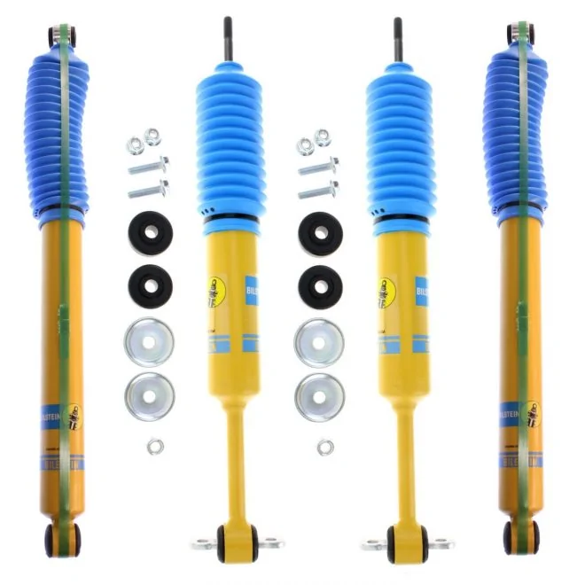

I see the OP has a very different setup than mine. His is heavily modified while mine is stock. Just had Bilstein 4600s installed all the way around - it's like night and day. Tires at 32psi cold - still a pickup truck but much better ride and control than the 'pogo sticks' Ranger was originally equipped with.
