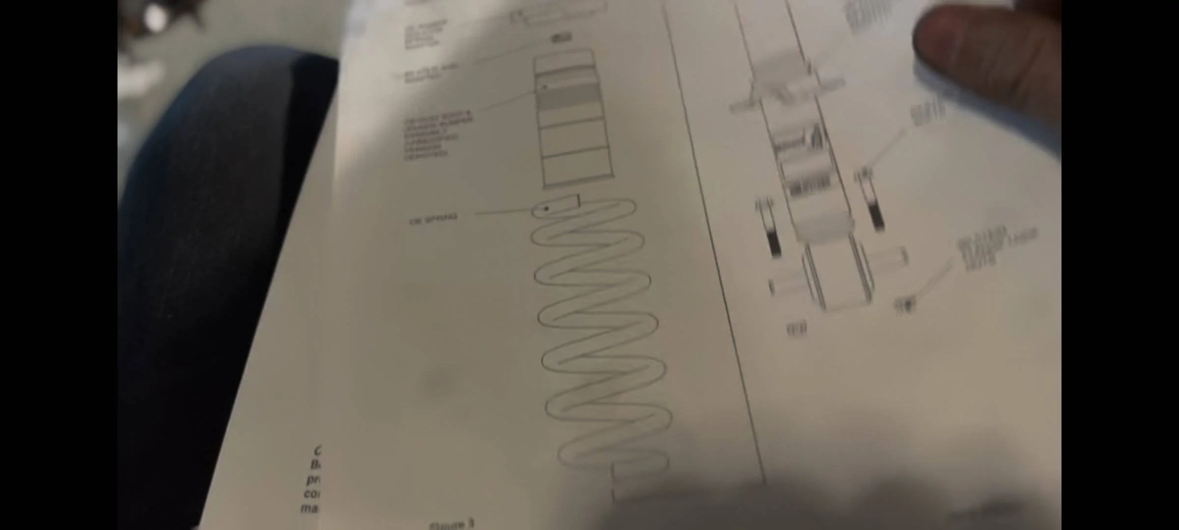

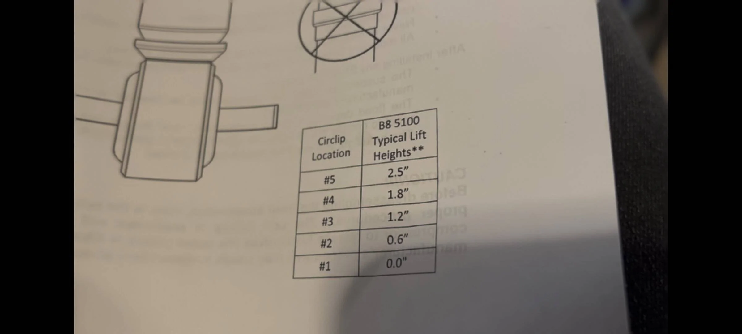

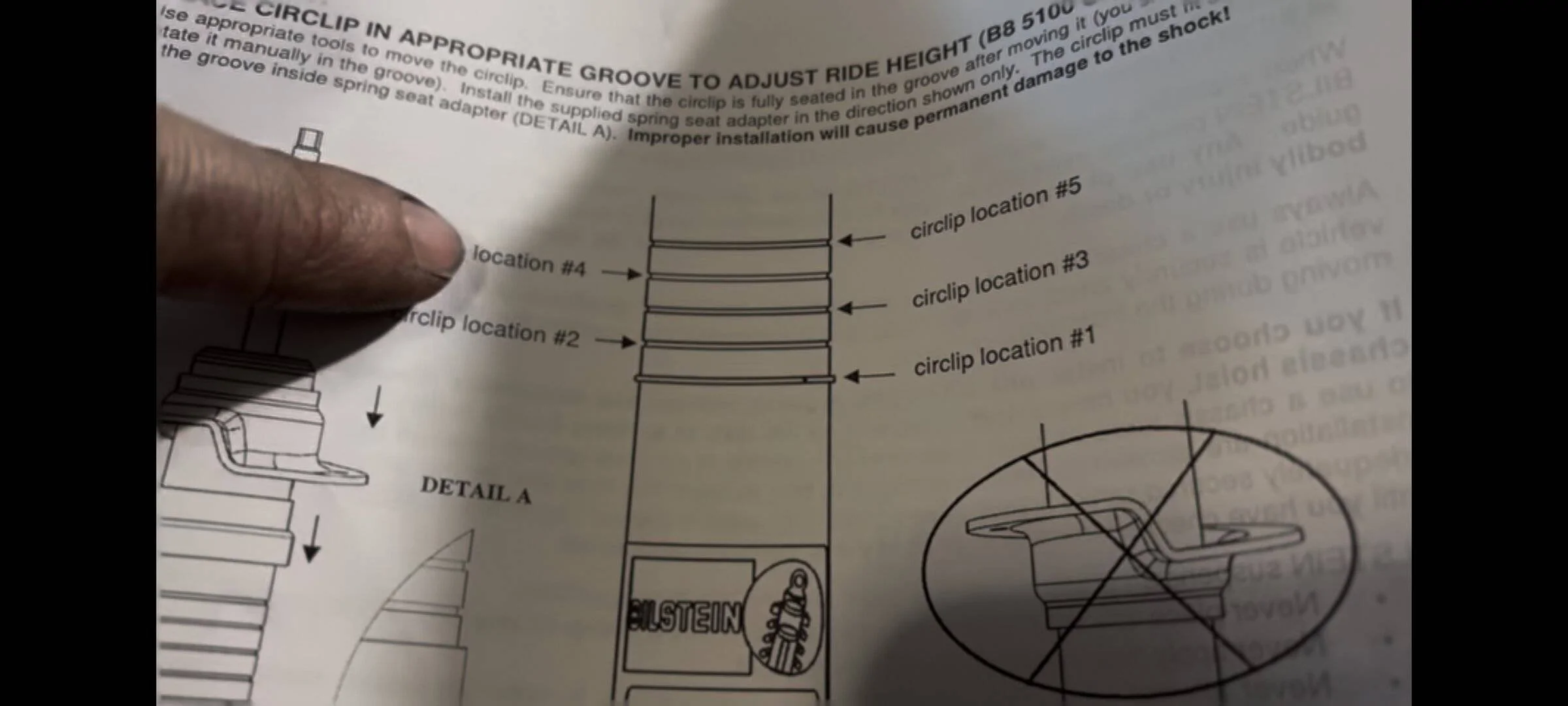

Yup just finished my install this past weekend with the bilstien 5100 on all 4 corners with the RC 3.5 lift. Had to do it twice because at the stock ride hight setting I only gained 1/4 inch over my stock struts with the ready lift sst 3in kit.
Spoke with RC tech support and they told me I had to use the 2nd notch from the bottom and not the stock height. They stated that the bilstiens were slightly different than stock. They were correct.
However, here are photos of the settings. I tossed my installation sheets so I had to screen capture a few photos from a YouTube 2019 Ranger bilstein install.
Good luck getting this info off of the bilstein website. You won't find it.
