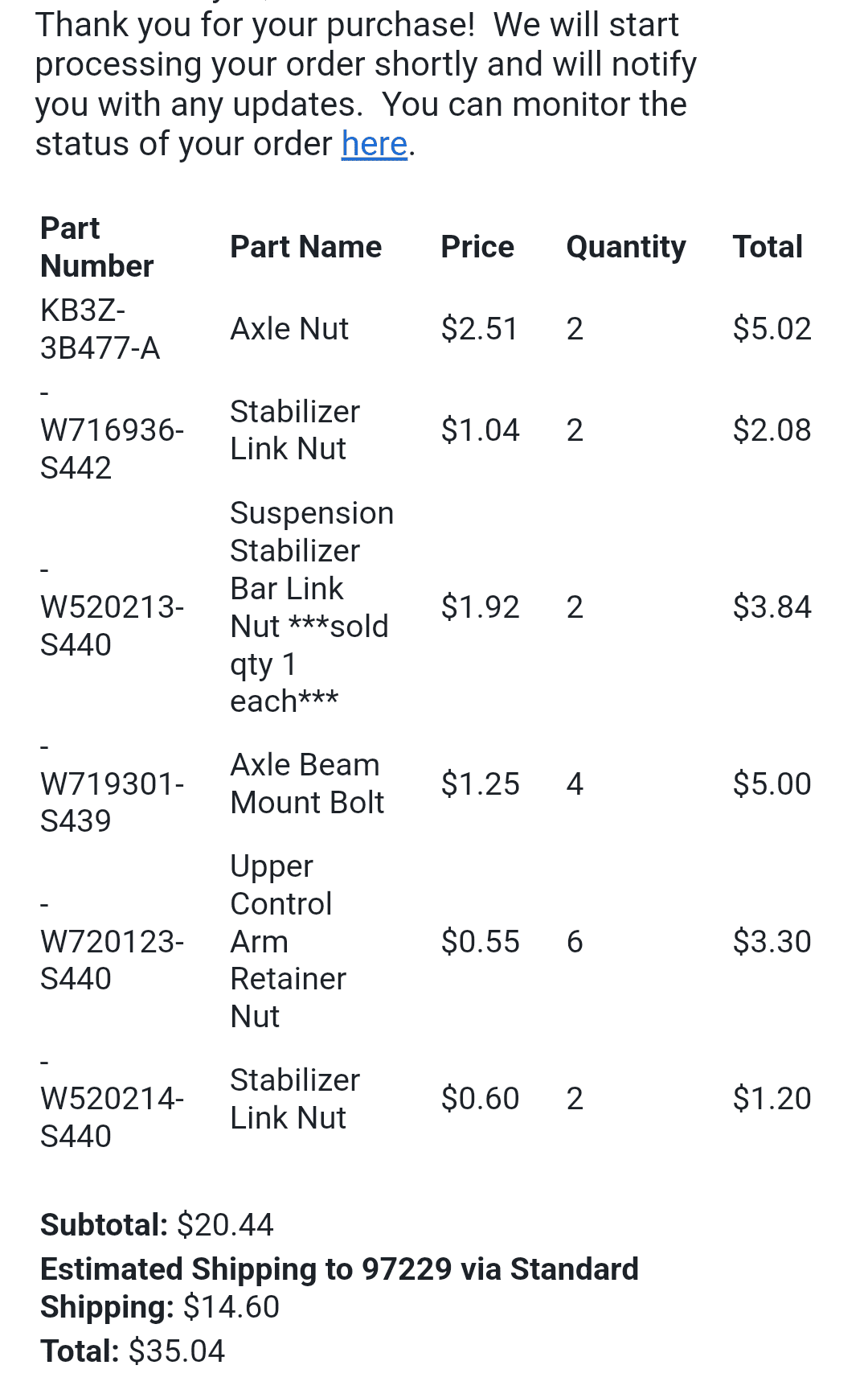

I received the 5100's recently and I'm curious if anyone who has done the install previously has the part #'s and associated quantities of the lock nuts that need to be replaced for the install. Much appreciated!

If you are talking about the suspension pieces to replace when installing new coilovers, attached is what I know.
I looked up the Ford Fox performance shocks instructions for the throw away parts and ordered them from Levittown. This is to go with my (non Ford) Fox 2.0 front install.
BTW these instructions are useful regardless of what coilovers you install.
Edit to add the above details as text for easier copy and paste.
that seems crazy cheap.

Well considering they are ford parts lol. The cv nuts on my f150 were about $12 each and thats rock auto. Ford is good at over charging for their little stuff.
