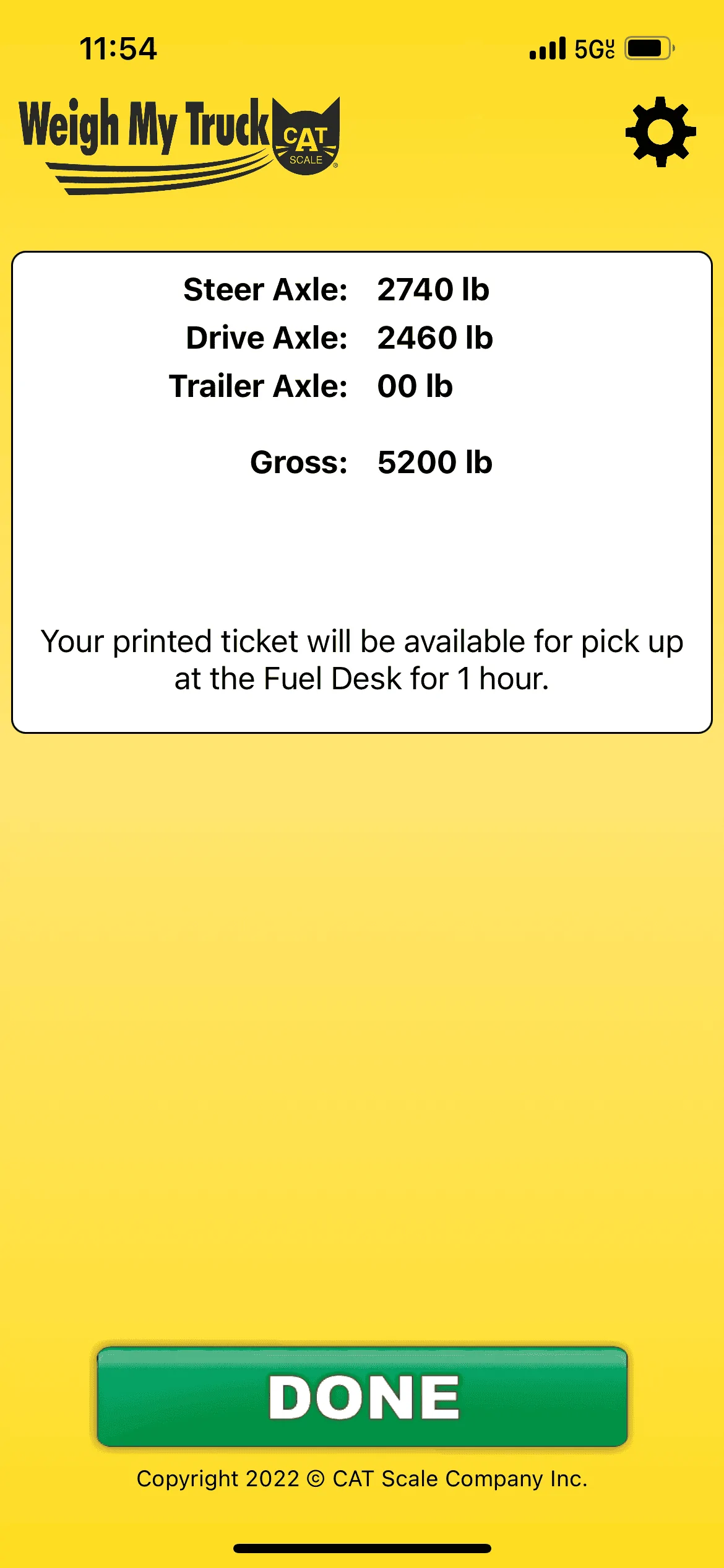

2022 Tremor. 350lbs of sand positioned between wheel wells but front of bags are over rear axle. We’ve had two significant snows so far (24” and 17”) and it makes a difference. Attaching weight slip showing axle weights without sandbags.

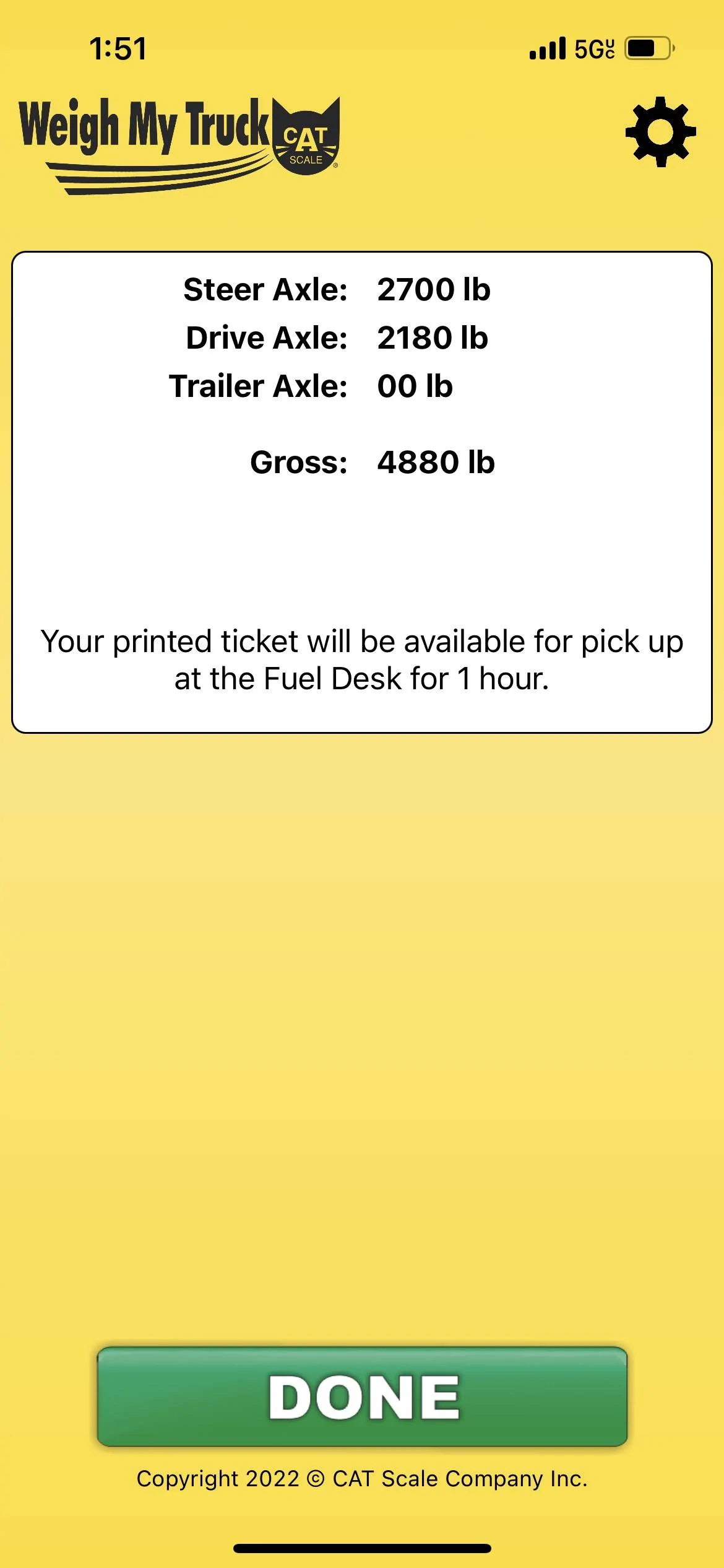

So I was in the neighborhood and popped across the scales this morning for a comparison. I forgot that on my original weigh in that I had my WD hitch attached. So for comparison sake it’s off by 60lbs and should read front 2700 + rear 2120 = 4820. So the difference is 380lbs. The difference between the 380 and the 350 of sand is most likely fuel and or inaccurate sand weight. It is interesting to see that it still gained 40lbs on the front axle when the sand is at or behind the rear axle. My daily science contribution ?
