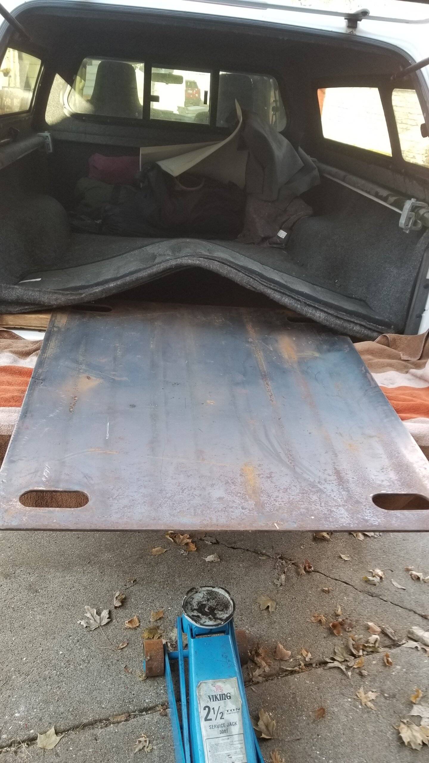

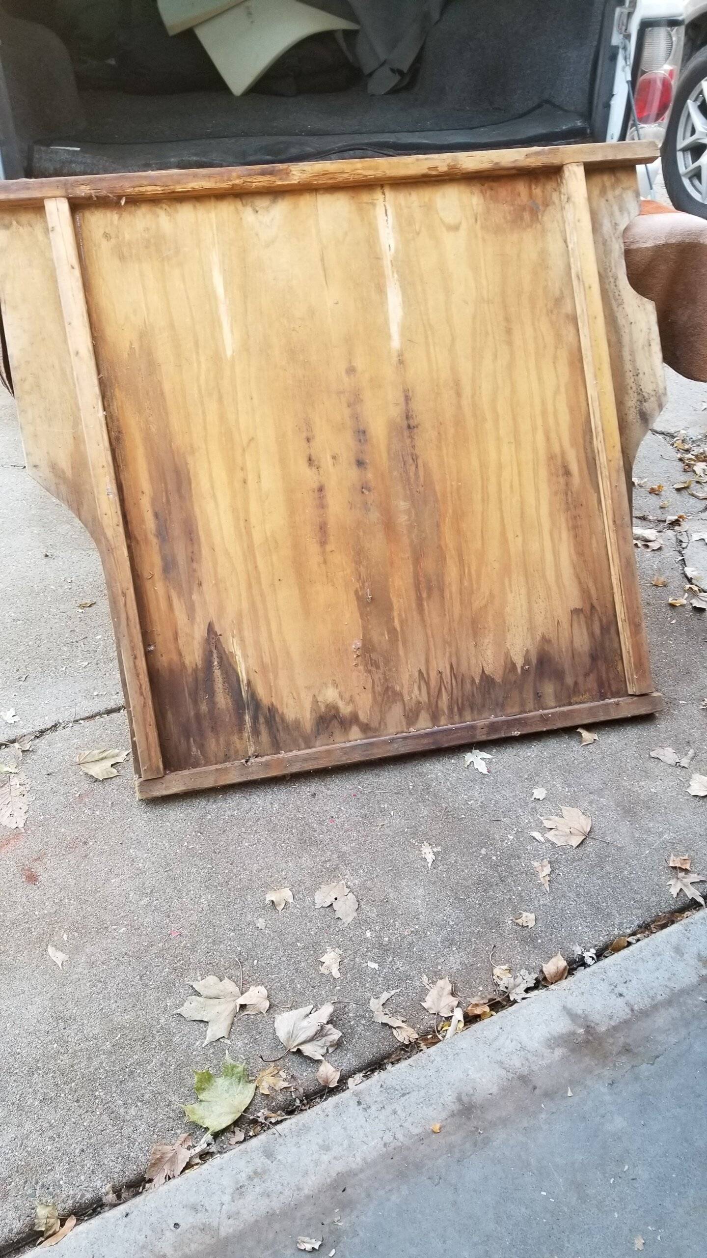

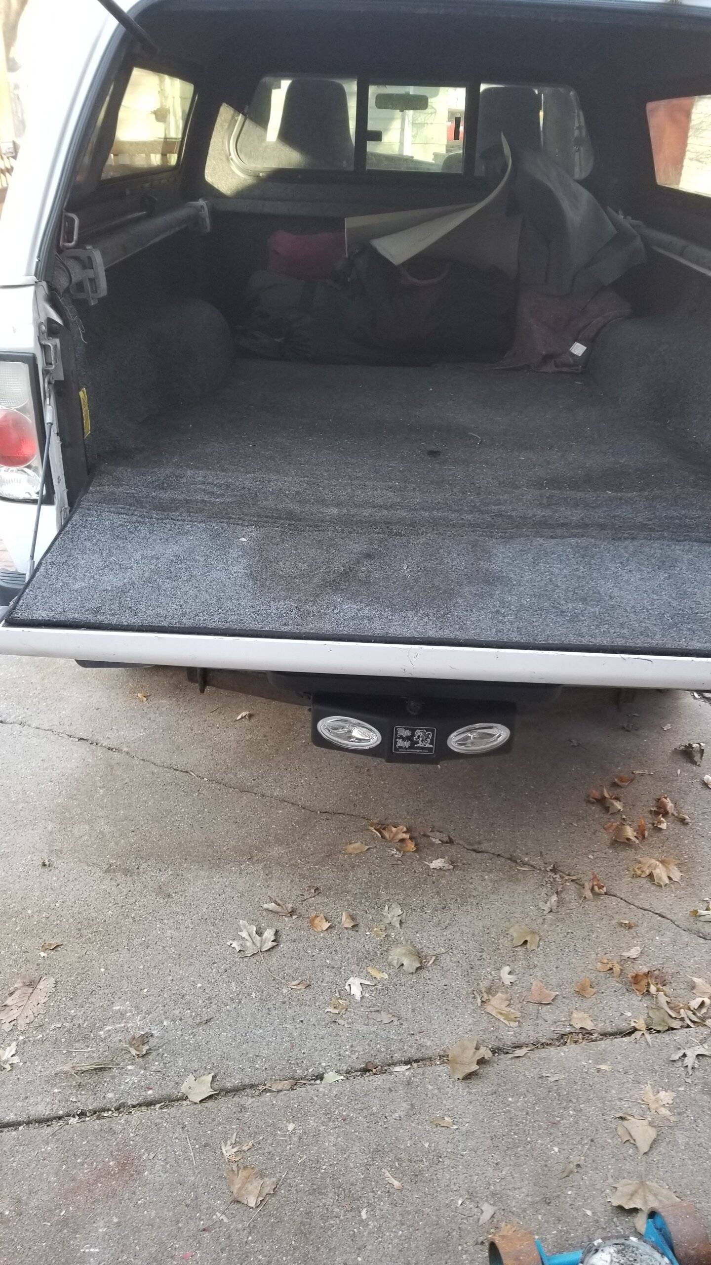

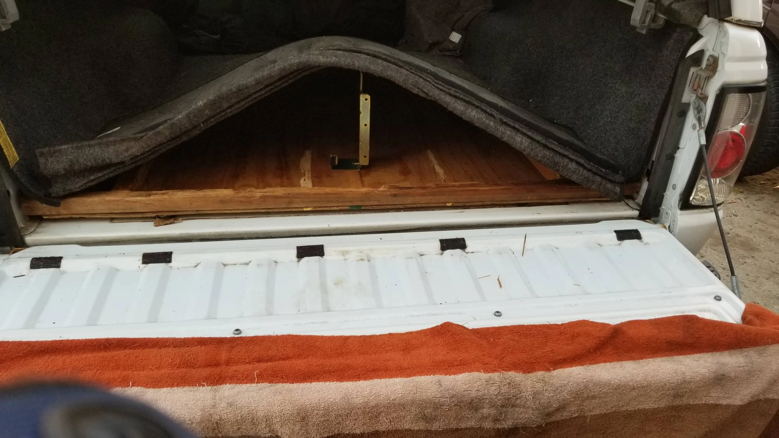

This is what I did in my 2005 (and will do for the 2019 Ranger as well):
Made a frame )1/4" plywood base; 1"x1" frame
Slide frame in bed under the bed rug:

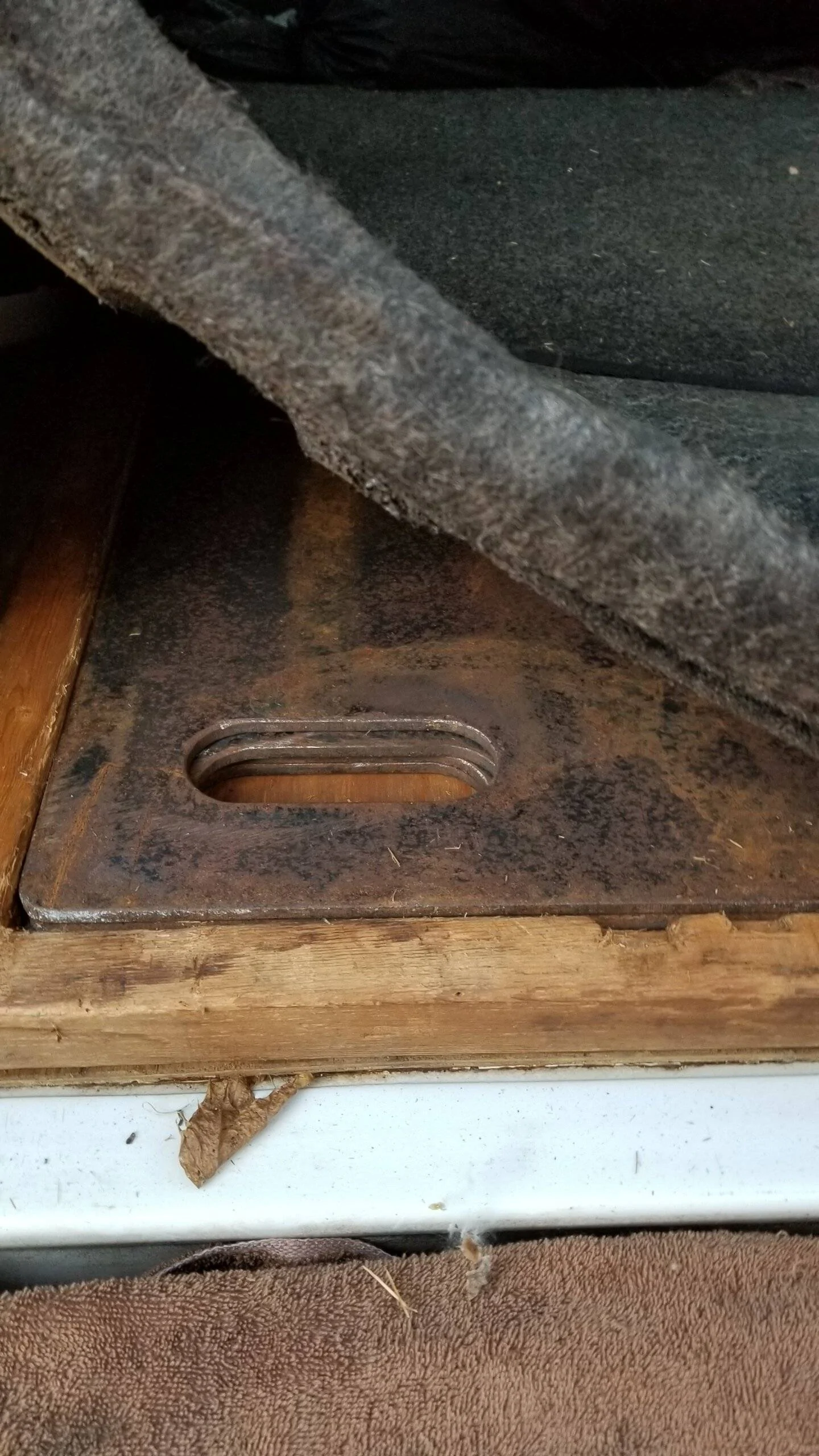

Looks like a good setup. I am flinching just looking at that, knowing there is a pinched finger story as a result of those plates - or at least there would be in my case.
Then insert 4 1/4" steel plates sized to be 100 lbs each (used extended bed bolts to tie them down). Now I still have full bed usage. (Note: had airbag helper springs that I aired up to keep it level):
Yes, most likely over kill not to mention the fall/spring install and removal is a pain (literally) but what a difference it makes in winter. Keep them in for the summer, Cadillac smooth ride.. at the price of 2 mpg lower fuel mileage (I always removed them in summer).

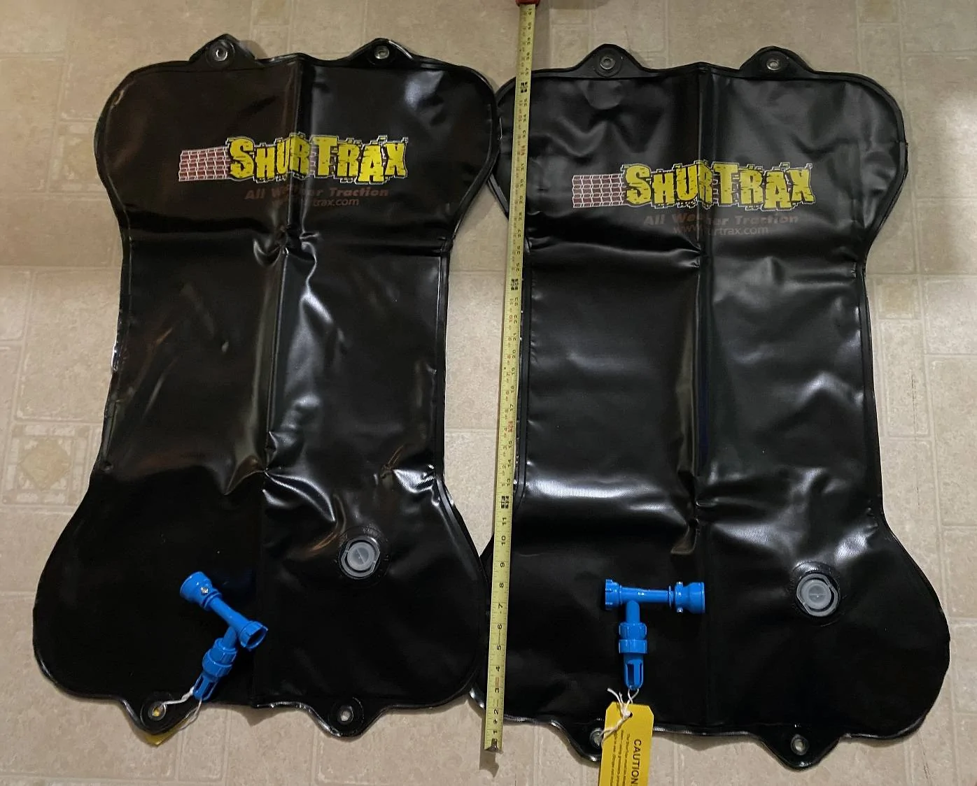

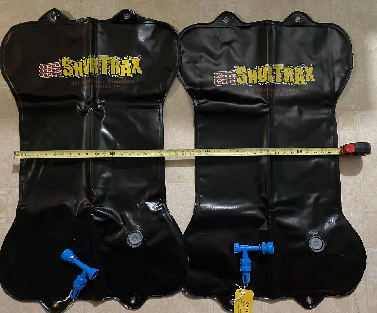

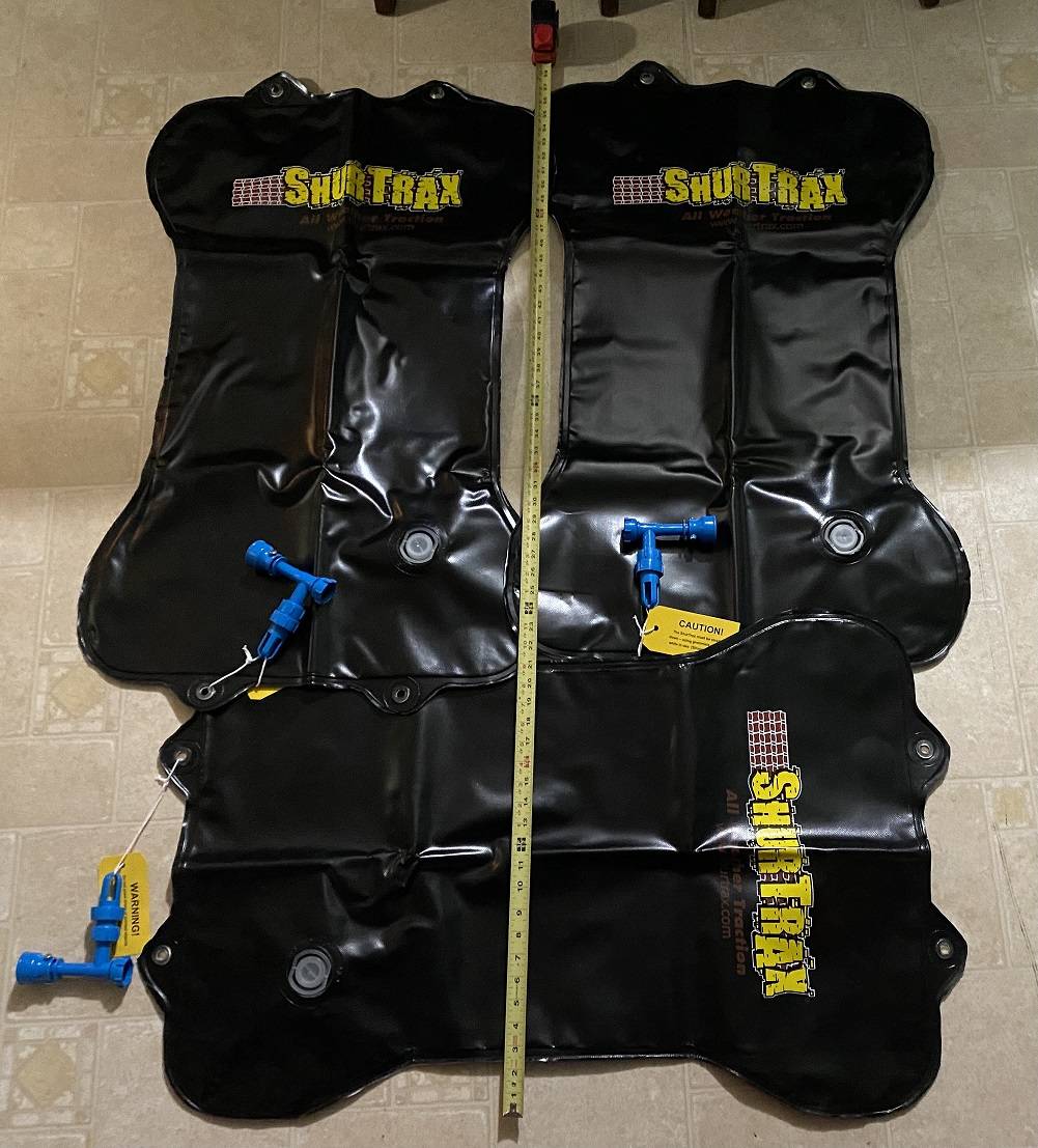

But I'm debating on ordering "three" of the small Auto/SUV aids since I have the shorter but wider crew-cab bed:
Shurtrax Auto/CUV/SUV Small Individual
Especially since each would be $40 [x3] versus the $150 single bag-unit.
Ended buying a "3-pack" and it was $100 versus $120... plus free ship.
Since everyone loves pics...
It was folded flat & each one weighs 4-lbs dry & roughly 14" x 14" squared.
It's been so cold out that I haven't gotten a chance to "mock-fit" in the back of the Ranger yet.
About 42" across [side-by-side] & 38" in length... 57/58 inches with all three mocked-up.

that's an accident waiting to happen. I feel like a week max before I put a hole in all of them
4,566
23,251
Bladders leak ... oh, wait, maybe that's just because I'm an old man - sucks getting older ... =D
