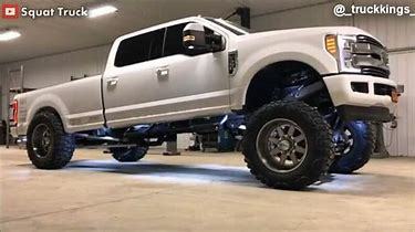

I was just going to get a pair of 203 pound kettle bells and hang them from the rear hitch.
truck nutz + traction = WIN-WIN!
Now we're back to looking like this. o_O:oops:
