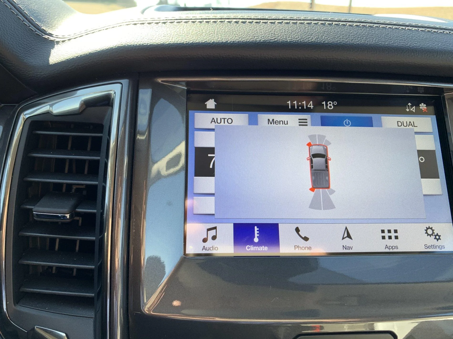

I have a remote but wanted to TRY use the homelink capability. I tried it all and nothing worked and what is worse is the process left the truck with a weird problem - whenever I stopped a never before seen warning screen popped up with the whole truck outlined in red and a red corner indicator also. Nothing would stop it from happening even when I tried to clear all the homelink buttons according to the instructions. VERY annoying. It seems that if I turned off the parking assist it would prevent this from happening but I have to have that to get it in my garage. Finally I tried again to program the homelink in my garage - still nothing and I'm not going the ladder route. But I was able to clear the programming from homelink and got rid of the problem. So you can try to program homelink unsuccessfully and still send some sort of information to the truck that really fouls things up. I'll stick with the remote.

So since I tried this and my problem persists I went to my dealer and showed him the attached. While there is an absolute correlation to my failed programming and the start of this "problem" he assures that the problem cannot be related to homelink programming and wants to scan it to see what error codes might pop up, he also thinks my generice OBDII scanner may not retrieve them and FORSCAN might be needed. Happens every time I stop at a stop sign or light - persists until 10-20 yds and goes off until the next stop. It will turn off if I switch off parking assist but I cannot get into to my garage without that :)
