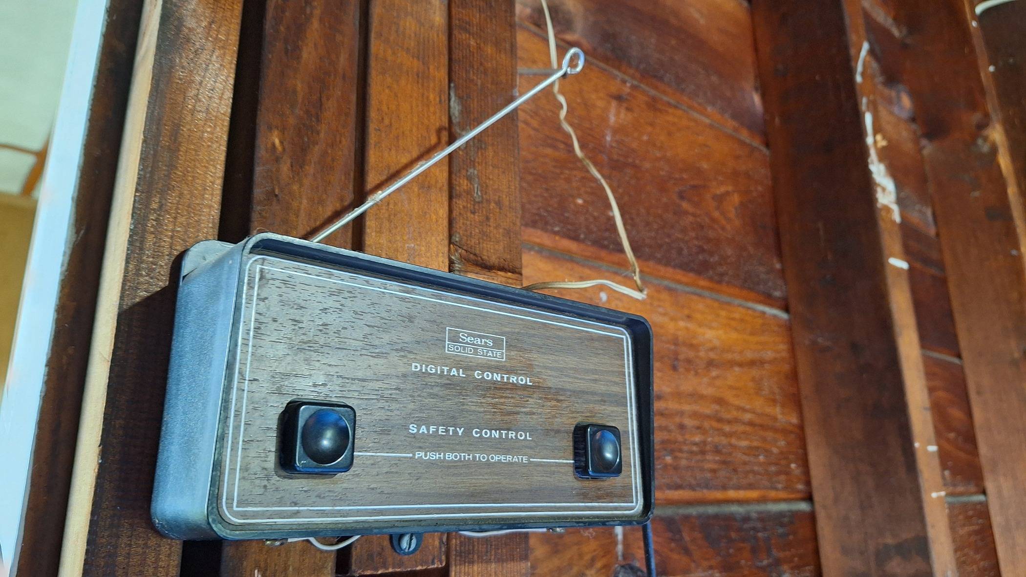

Man, I lucked out. We have an old Stanley that was manufactured before 1992 and it connected right up with my wife's 2022 Mazda CX-5. Talk about lucky!
Isn't there some sort of module to do a retrofit? Like this HomeLink Compatibility Bridge for LiftMaster and Chamberlain (post-2011) garage doors?
https://www.chamberlain.com/homelink-compatibility-bridge/p/HOMELINK+RPTRMC
step aside Cybertruck, look at this tech! It's even got an antenna the size of a Ranger's!
gee, it's even the lowly economy model =p
