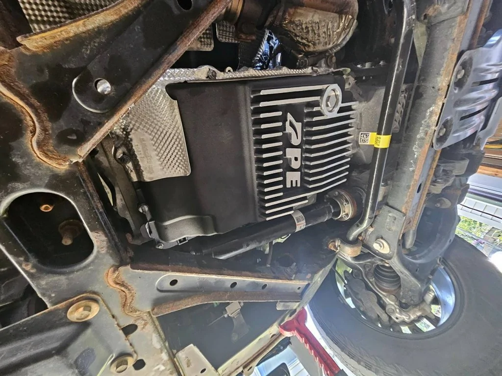

I installed the PPE Power 328053620 Deep Transmission Pan. I chose the deep pan as it provides increased volume of trans fluid (dilutes contaminants between fluid changes) , and greater surface area for cooling. My truck is lifted about 3.5", so, no worry about it getting dented when climbing over rocks. It doesn't stick out below the frame anyways. Remembering the torque sequence for the bolts was too complicated so I made the attached pic and stuck it to the bottom of the pan while torqueing the bolts (HS=Heat Shield Bolts, LB=Longer Bolts)). At the same time, I installed The MBS RS-1023 Extended Automatic Transmission Dipstick for 2019-2023 Ford Ranger with the 2.3 EcoBoost engine and the 10R80 automatic transmission. Otherwise, checking fluid levels via the standard micro dipstick, and adding fluid is an absurd PITA.
