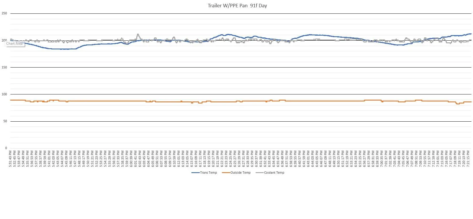

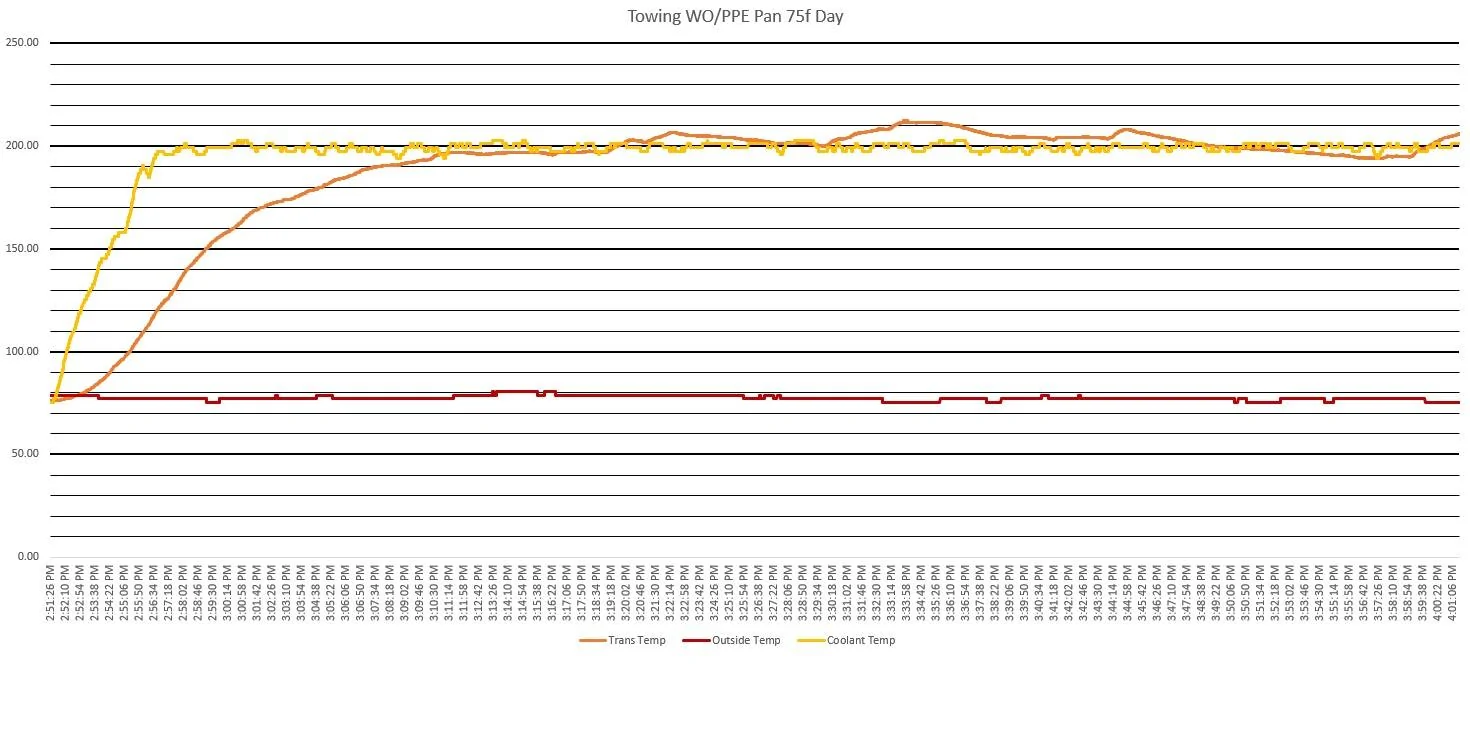

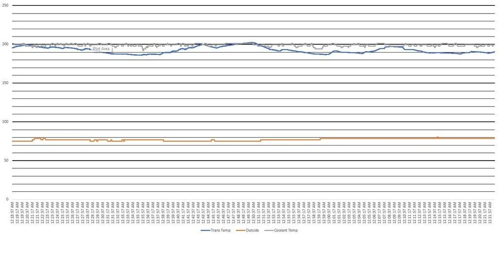

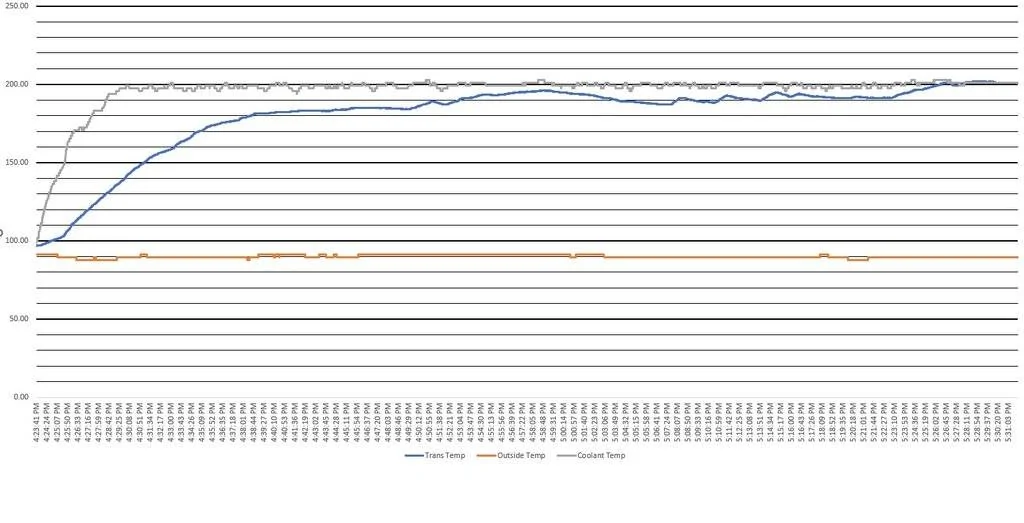

Here are the two plots for when the trailer was attached. Same trip as above, just the opposite.
These two don't show as much of a difference as the unloaded graphs, but then again, the truck was dealing with almost 20-degree hotter ambient air as well.
The trailer is attached without the PPE pan. (75f Day)

This towing the trailer with the PPE Pan (91f Day)
I would have to be there to truly see all the conditions for the Transmission Temperature as I suspect there was either Stop and Go traffic involved some or som grades involved. That said if you look closely you can tell the transmission temperature is a bit more stable and comes down easier compared to the stock pan.

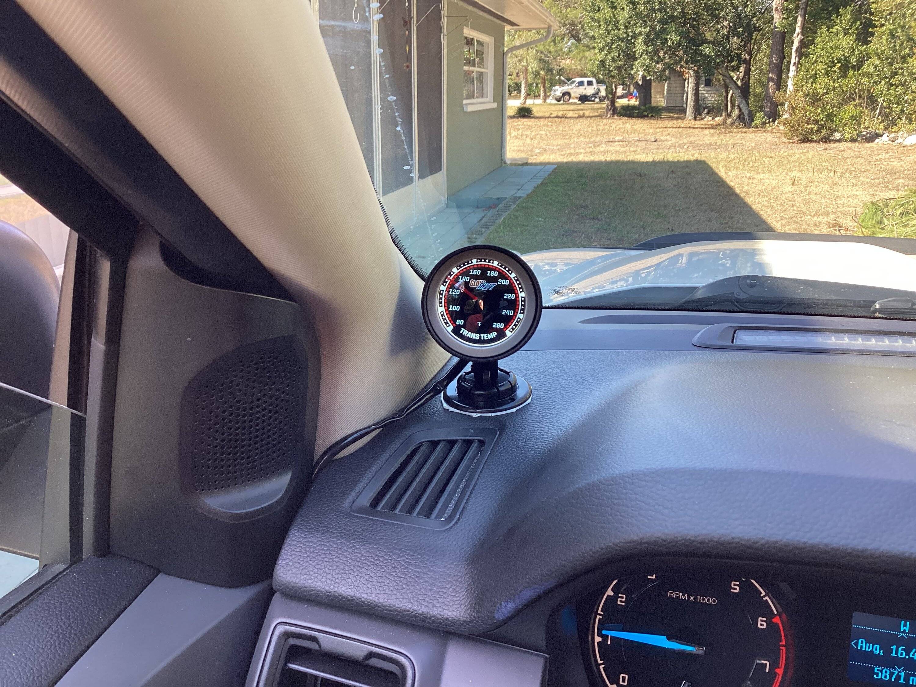

Which specific trans temp gauge fits this pan? Im looking to do the same thing
OBD PID electronic readout...sensor already in our trucks...
