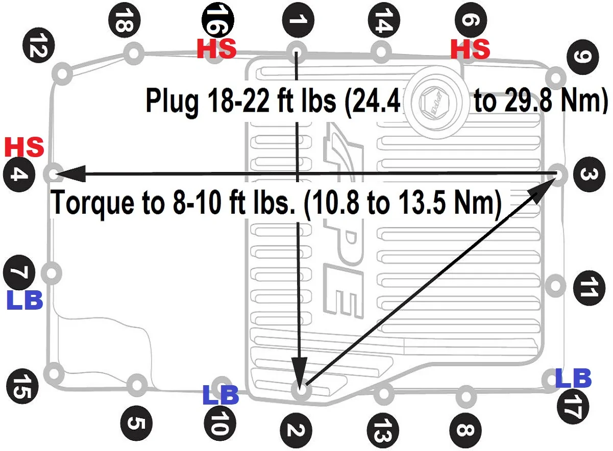

I installed the PPE Power 328053620 Deep Transmission Pan. I chose the deep pan as it provides increased volume of trans fluid (dilutes contaminants between fluid changes) , and greater surface area for cooling. My truck is lifted about 3.5", so, no worry about it getting dented when climbing over rocks. It doesn't stick out below the frame anyways. Remembering the torque sequence for the bolts was too complicated so I made the attached pic and stuck it to the bottom of the pan while torqueing the bolts (HS=Heat Shield Bolts, LB=Longer Bolts)). At the same time, I installed The MBS RS-1023 Extended Automatic Transmission Dipstick for 2019-2023 Ford Ranger with the 2.3 EcoBoost engine and the 10R80 automatic transmission. Otherwise, checking fluid levels via the standard micro dipstick, and adding fluid is an absurd PITA.

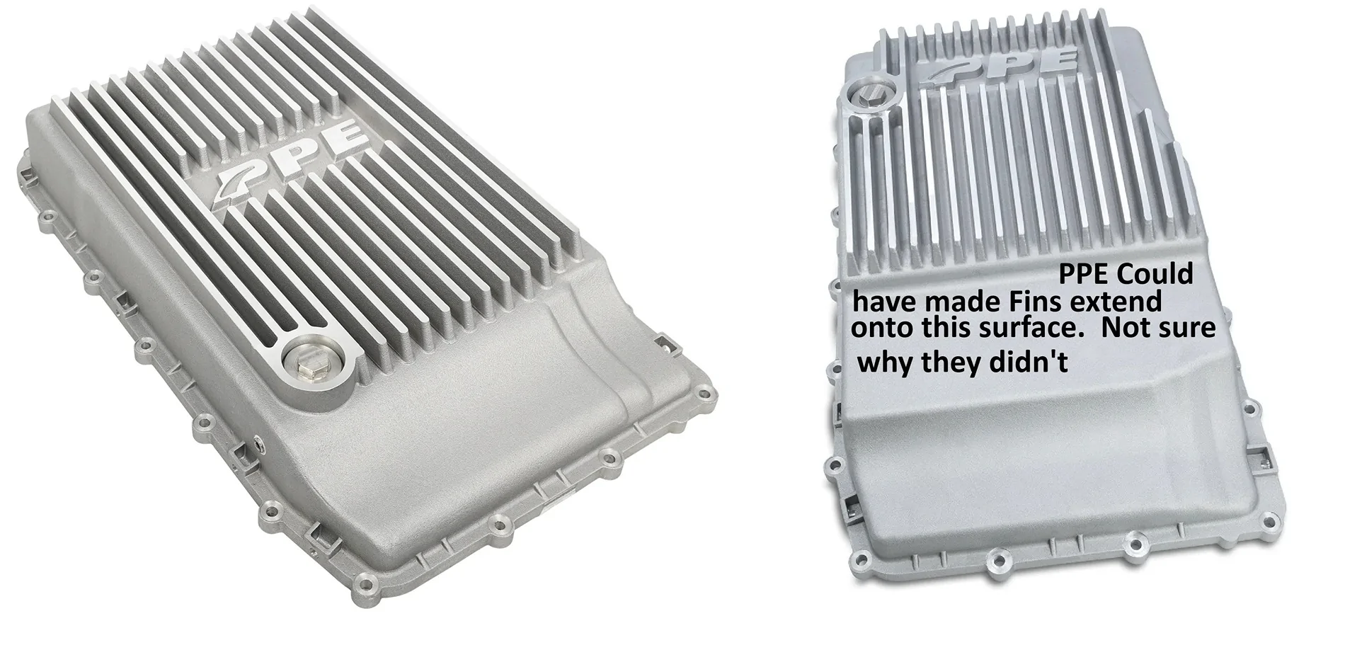

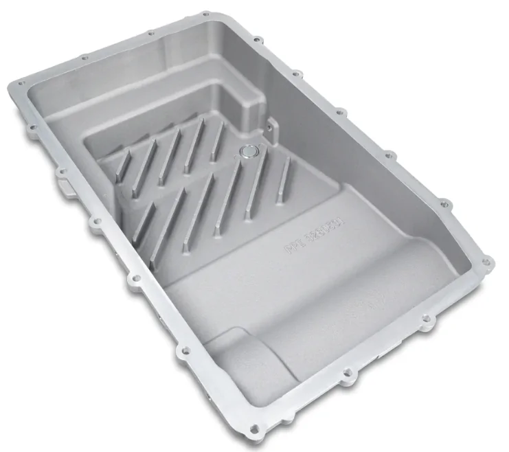

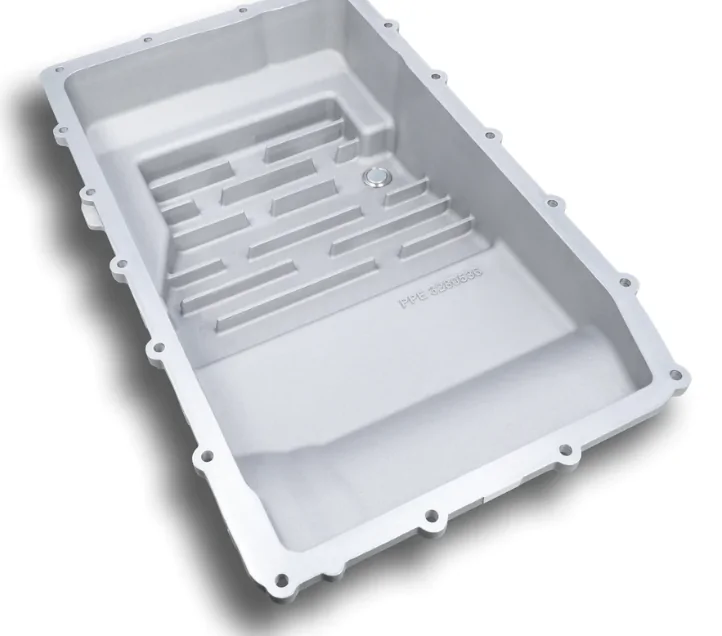

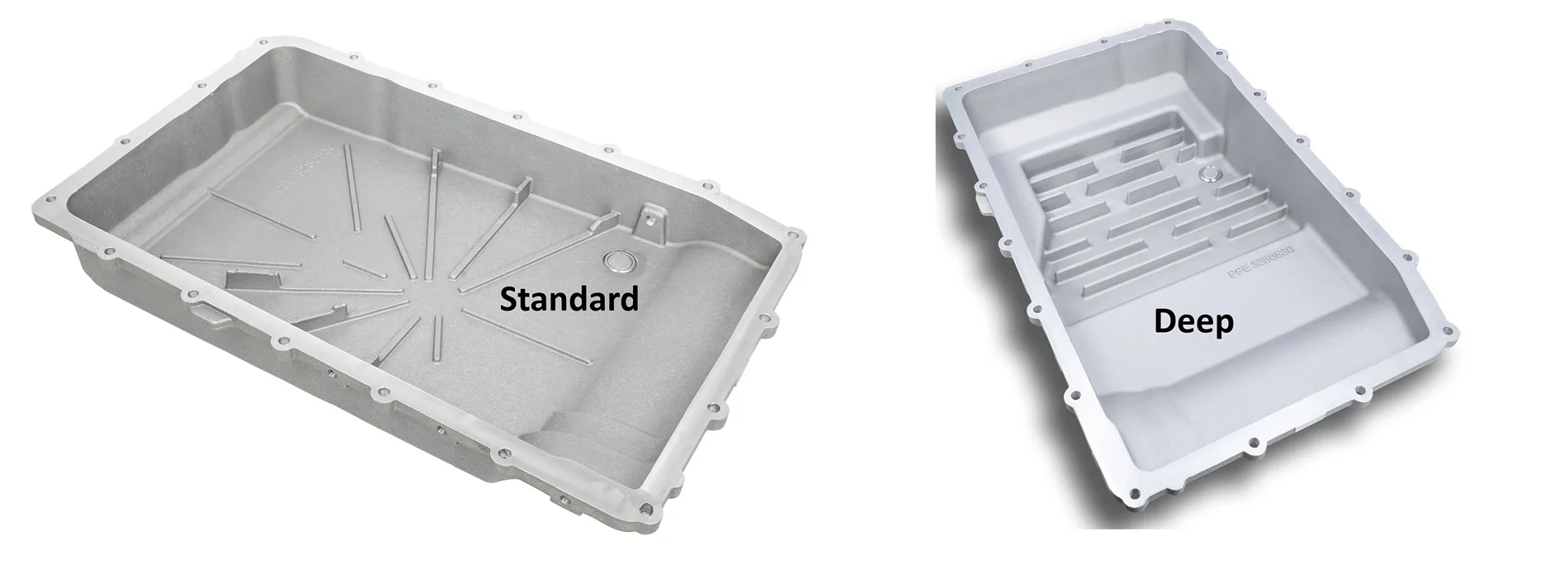

True, the filter will be farther from the bottom of the pan, so might not get as much goop from pan bottom. Standard pan vs deep pan does not change fluid level with respect to filter or fluid intake port, just adds more fluid capacity below those items. (1st Pic) Missing any same amount of fluid does not make top of fluid level any lower from filter or fluid pump intake. (pic 2) The shallow pan does appear to have longer fins on the outside, a curious design divergence (Pic 3). On the inside of the pans, the Deep Pan appears to have more / larger fins / baffles which would pickup / transfer more heat, maybe better disrupt sloshing. (pic 4)
