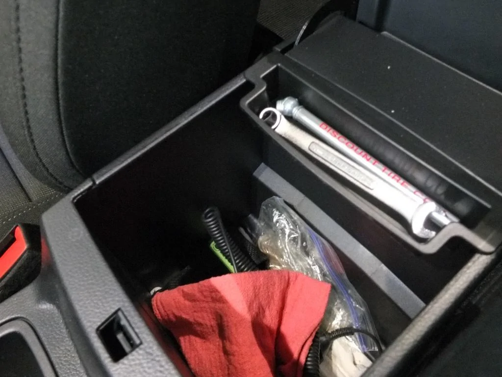

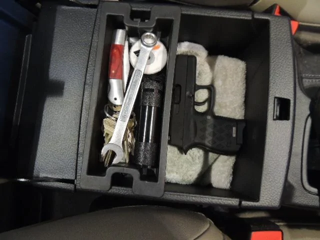

Isn't that what the little tray in the center console is for... a 10mm wrench?
Be sure to carry one with you in the truck. Might save your bacon when the truck dies in the middle of nowhere.... ??
We can all thank Bill Gates for this. Before him we never knew the phrase "Well, did you re-boot the computer?" :headbang:
Well, I'm confused.
What the heck does a 10mm wrench have to do with touch lock/unlock, or later .. auto windows?
What'd I miss?
137,226
Well, I'm confused.
What'd I miss?
If you're away from home and need to disconnect the batter to re-boot it.
