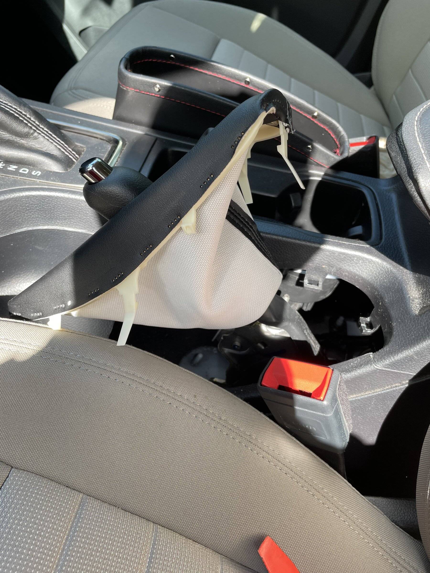

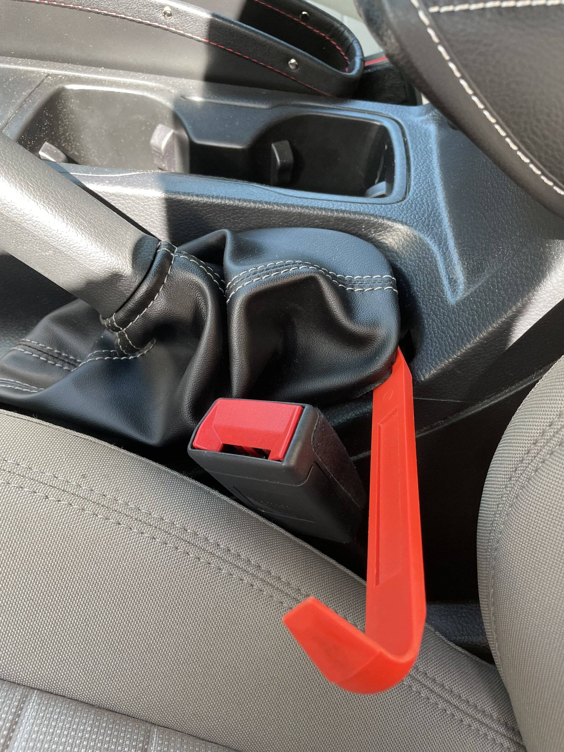

Well I took the first steps and I have to say this was very easy.
Step 1: Use your trim tool or whatever you have handy and pry the boot up from the rear.
Work the tool around the sides until all of the retainers are loose.
Now pull the boot over the brake handle.

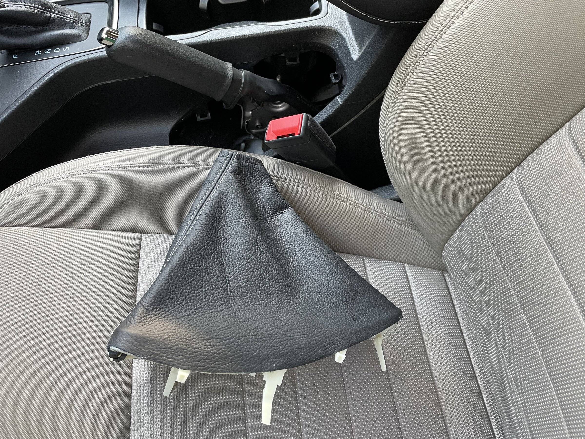

Here are all the retainers on the boot collar. Note the location notches on the boot. The Redline boot has the same locator notches.
And the Redline boot compared to the Ford boot.

This is the "frame" after the original boot has been peeled off.

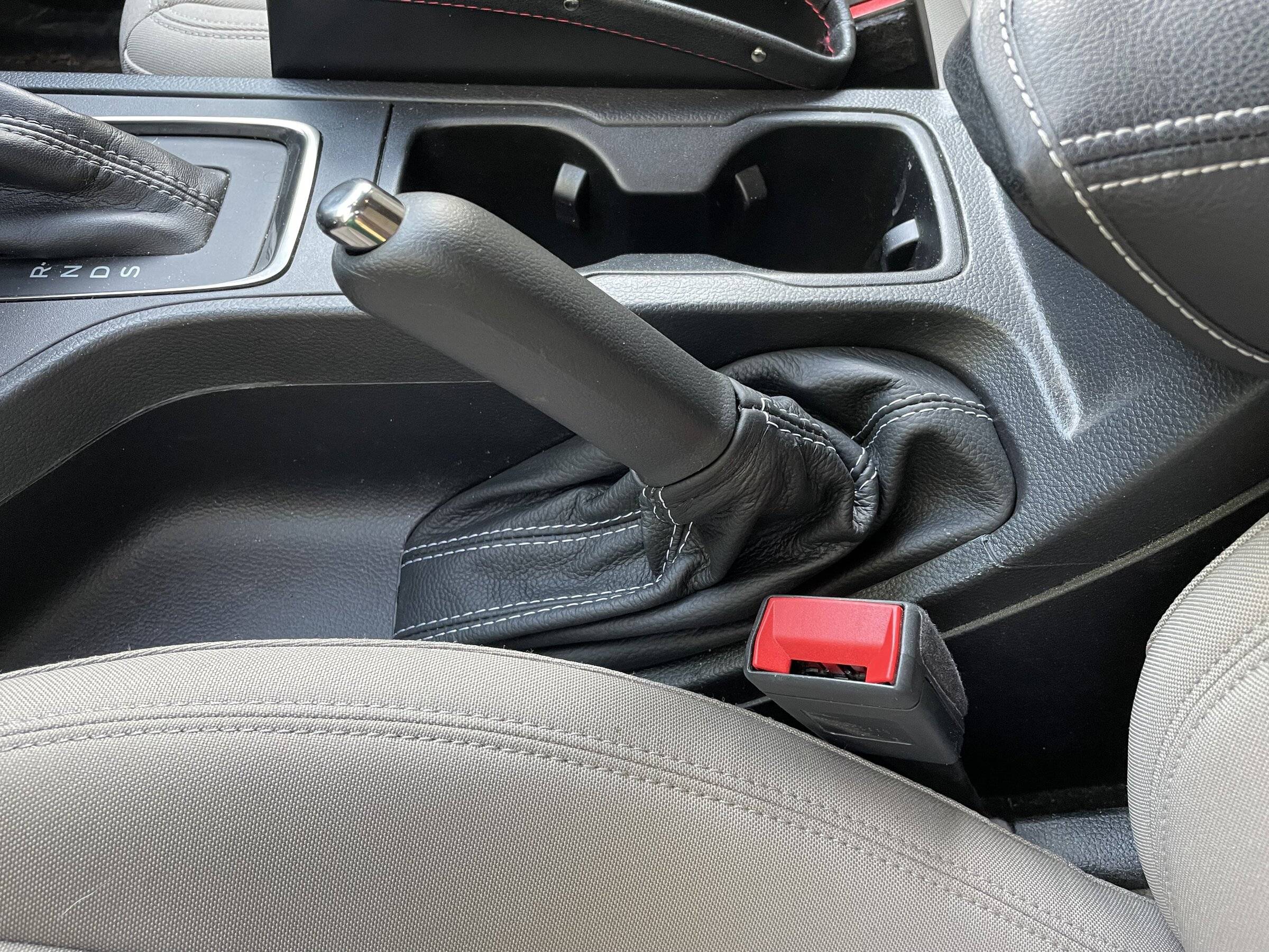

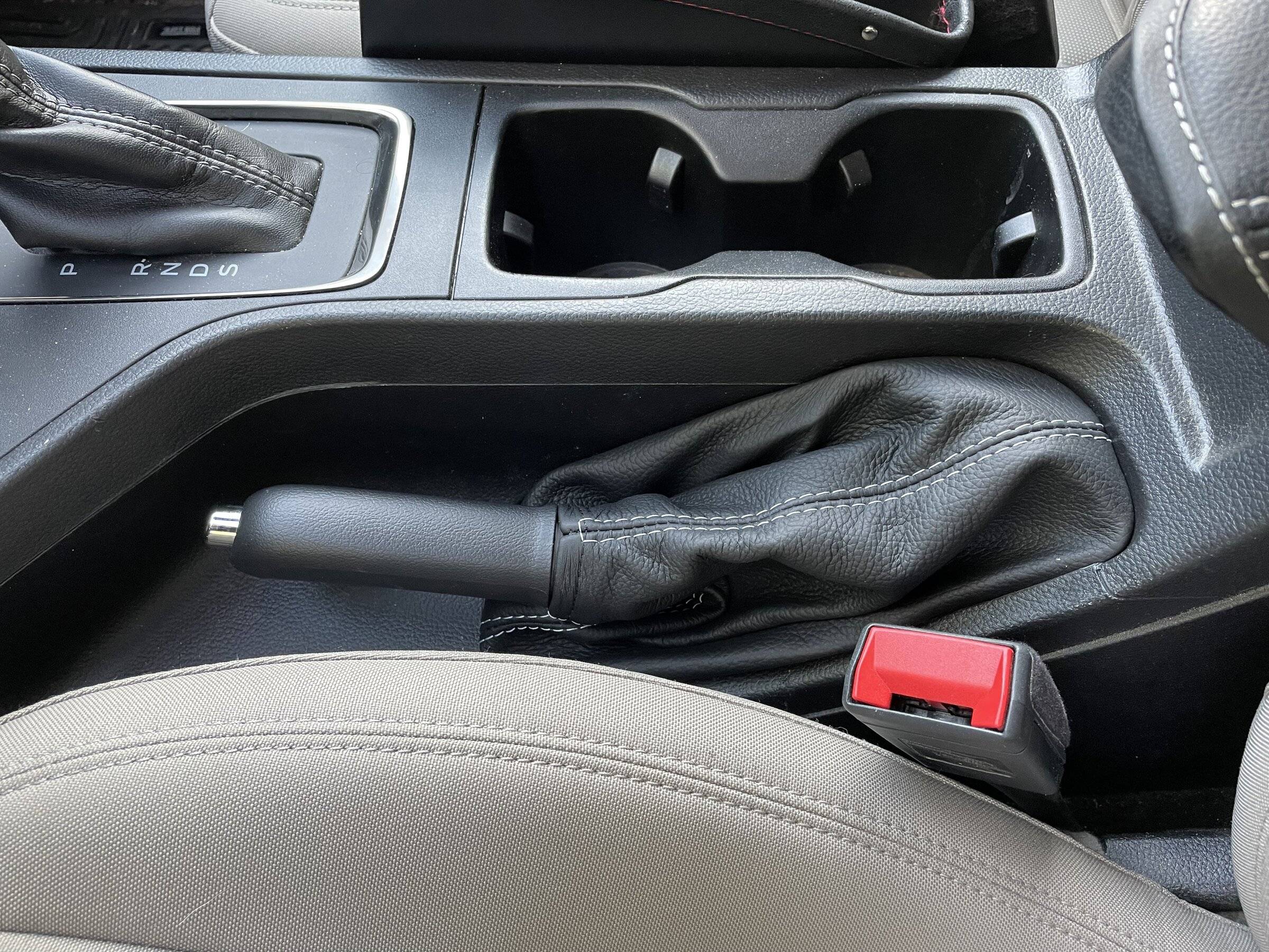

Pull the new boot over the handle and seat the boot collar in the the groove on the handle. Line up the long fingers with their retainers in the console then snap it down.
And, Voila!
Looks and feels SOOOO much nicer than the faux pleather of the original.
$40 well spent I do believe.
