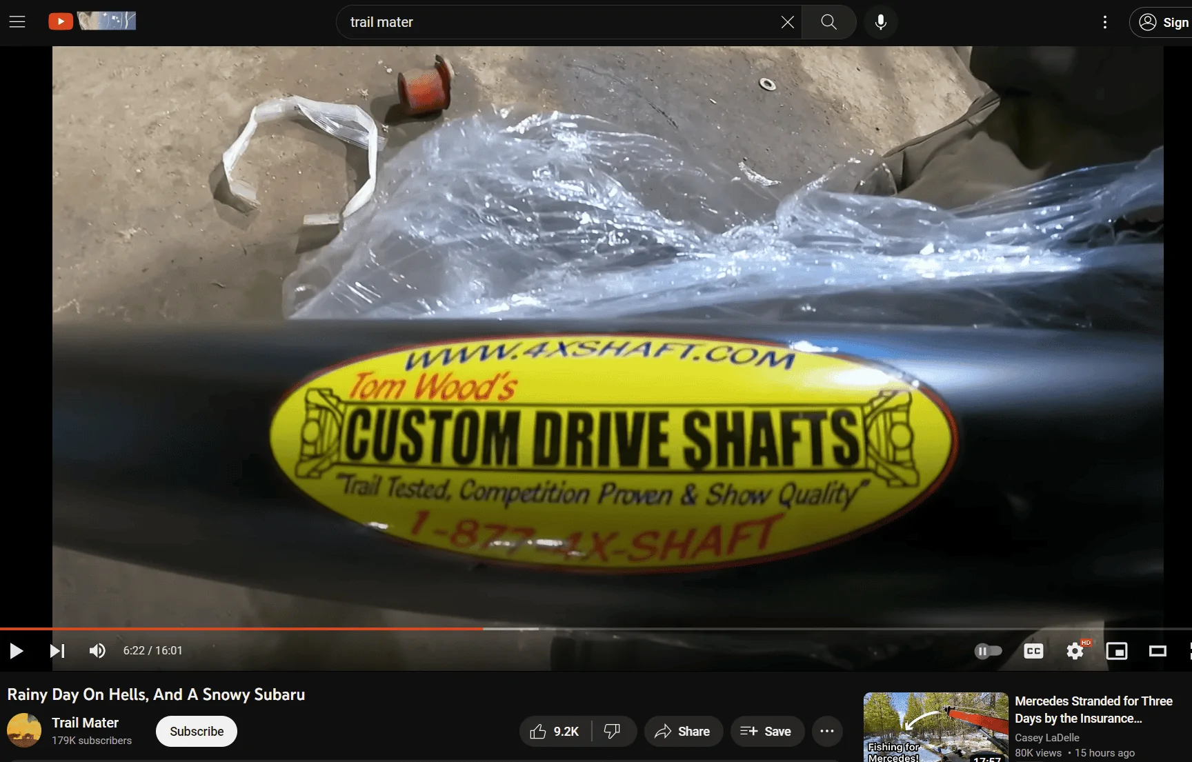

For anyone that has changed to the one piece TW driveshaft themsleves...can you tell me how difficult of a job this is? Time? I'm pretty mechanical able but at 53 lying on the ground for hours is not ideal! LOL
TJC
Aug 28, 2020
47
4,167
10,698
Took me 1 1/2 hours and I am 67. 4 bolts on each end and a spacer. Use Blue LockTight. I did have my bride put the truck in neutral a time or two to allow me to rotate the driveshaft so I had easier access to the bolts. If you can get the back end up in the air (jack stands) a little bit, it will minimize the number of times you have to crawl out from under the truck. Use the emergency brake to keep the driveshaft from rotating when breaking the bolts loose and tightening them up.
