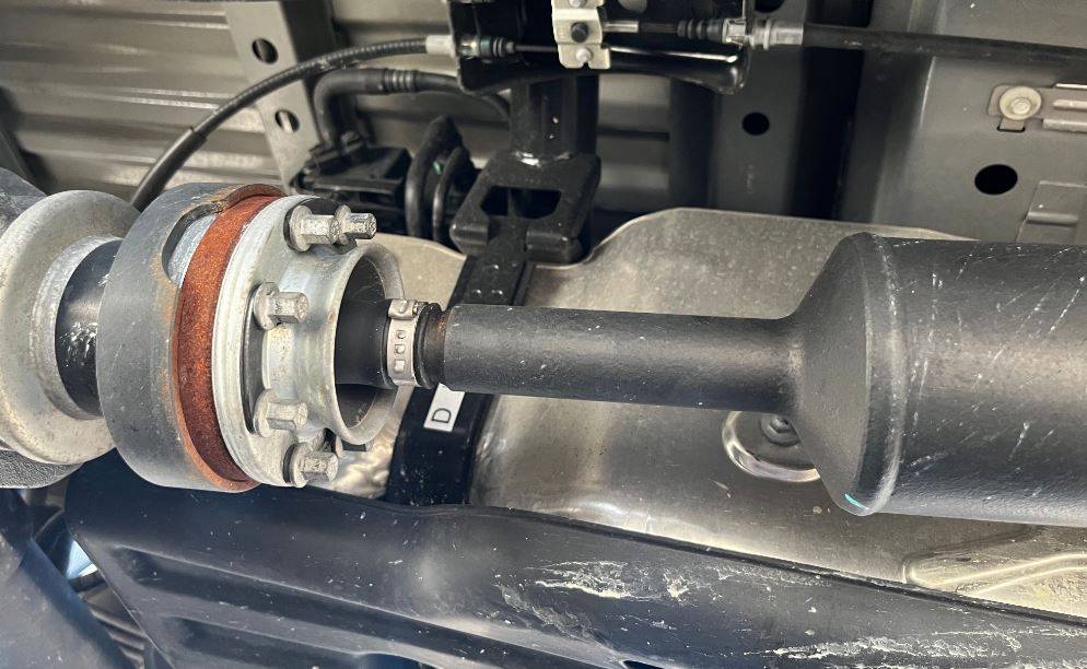

WHAT'S THE ADVANTAGE OF THE ONE PIECE OTHER THAN LESS UNIES TO REPLACE
Quite a few of us experienced vibration at takeoff and/or at higher speeds. This is pretty much the only available solution outside of the dealer and Ford who will just swap you out to another 2-piece.

My 2022 also has the takeoff shudder. Had it into the dealer for the TSB for the pinion shim. I measured the angle before taking it in 6.10º. After I got it back they said they used a 1.5º shim because the measured 7º before the shim was installed and said they saw 5º after. Keep in mind they used the analog measuring device the TSB said not to use. Picked up the truck and still had shudder so measured again when I got home and saw 7.6º. They put the shim in backwards. Took it back for them to fix and when I picked it up they said still had vibration but they disagreed about putting the shim in backwards. The tech said the instructions are wrong and that the wide end should be to the back when decreasing angle. He switched the 1.5 out for a 2.0. Measured at home and I saw 8.1º. Sent the service manager a pic of my measurement and he said bring it in and we will compare measuring devices. I took the truck back again, at this point it was the forth visit and they put it up on their alignment rack. The tech got out his analog unit and said it was hard to read. I handed him mine he zeroed on frame and then flipped it 180º and measured the pinion and said "see we have 5.75º". I told him zero the inclination meter and not flip it 180º and let me know what you see. He did and couldn't understand why he now saw 8.1. I explained when he zeroed and rotated it 180º he was subtracting the rake of the truck. He slapped his forhead and said crap we were doing it wrong and will need to replace again and rotate the shim like the instructions. After waiting for more u-bolts the fifth visit they got the angle at 5.1º using a 1.0 shim but still have the shudder. All shims the shudder felt the same as stock. Next they swapped the carrier bearing. No change. I have measured my driveline angles as Dana/Spicer website shows and entered my numbers into their calculator. No wonder the trucks vibrate. The angle at the transfer case is 2º less than the angle at the rear axle. Should be the opposite due to axle wrap tilting the pinion up when taking off and applying power. The only way I see fixing this is by shimming the carrier bearing to get the angles correct. Sorry for the long post but been through a lot and the dealer pretty much is saying it's normal because the one on their lot also vibrates. Good sample size huh? ;)
I feel your pain.
Been there, done that, went solid shaft - all gone. And transmission bizarre shift behavior cleared up as well.
I hope you have better success than I had. Sounds like you have a good handle on the cause of the issue.

For testing, I lowered the carrier bearing, then I flipped the carrier bearing and installed spacers and long bolts so I could raise it up, I was cycling through various angles on both front and rear shafts, I found a sweet spot, but then I had to take it into the dealer so I put it back to stock.
Then I was going to get a global carrier bearing which is mounted higher from the factory, but now I am just driving it, kinda tired of crawling underneath the truck, I can't find the perfect spot, now it's great no vibration...... until I load more than about 600 lbs, then it vibrates.
I think I found a shop that will build me a one piece shaft for a Tremor, but I have to be without the rear driveshaft for a week.

If you guys read through the threads about driveline take-off shudder and vibration you may find trying to achieve the proper angles on your driveshaft will not cure the issue. The problem seems to be more rooted in the soft support material around the driveshaft center bearing (some may call it a carrier bearing). I was one of the people who put a one piece driveshaft on my Ranger and the related problems are gone.
I was able to escalate my truck's issue to get attention by an FSE (field service engineer) luckily via a family member that works for Ford. The FSE reported after working with the local Ford tech that my truck's shudder was mild and was the best it would probably get. The story is much longer but for the sake of keeping brief I summarized. At that point I did my research and got a one piece driveshaft.
