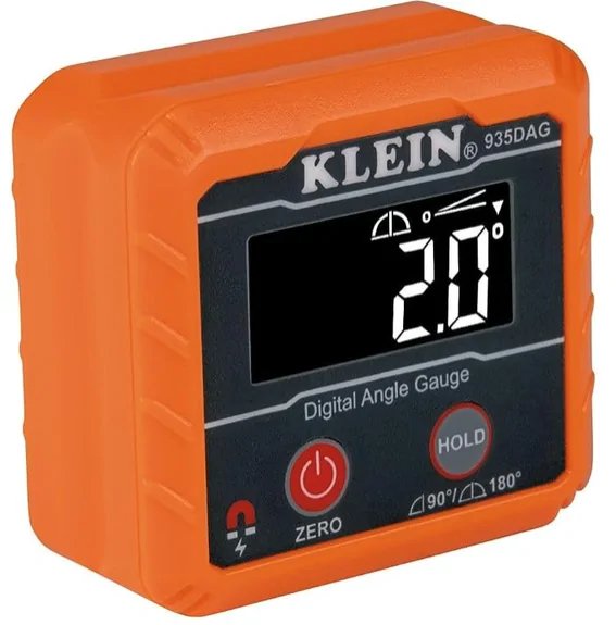

Buy a Klein Digital Electronic Level and Angle Gauge to determine the difference between the two angles, then if necessary, correct. They are only $33, and it will eliminate the guess work. It got a magnetic edge that aids in getting a correct measurement. Both ends should have the same angle.
This is what I used to determine if the angle was within tolerance.
