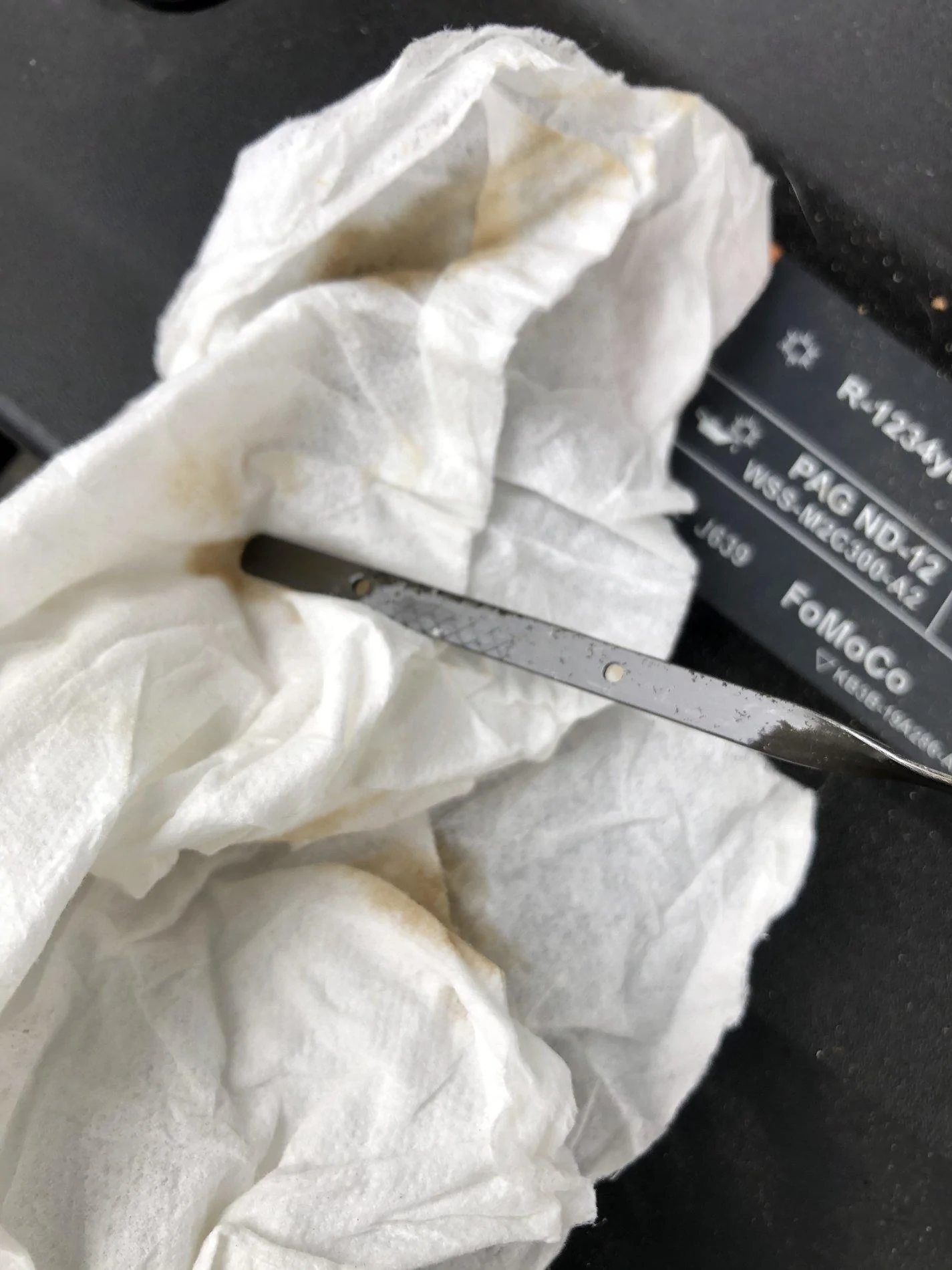

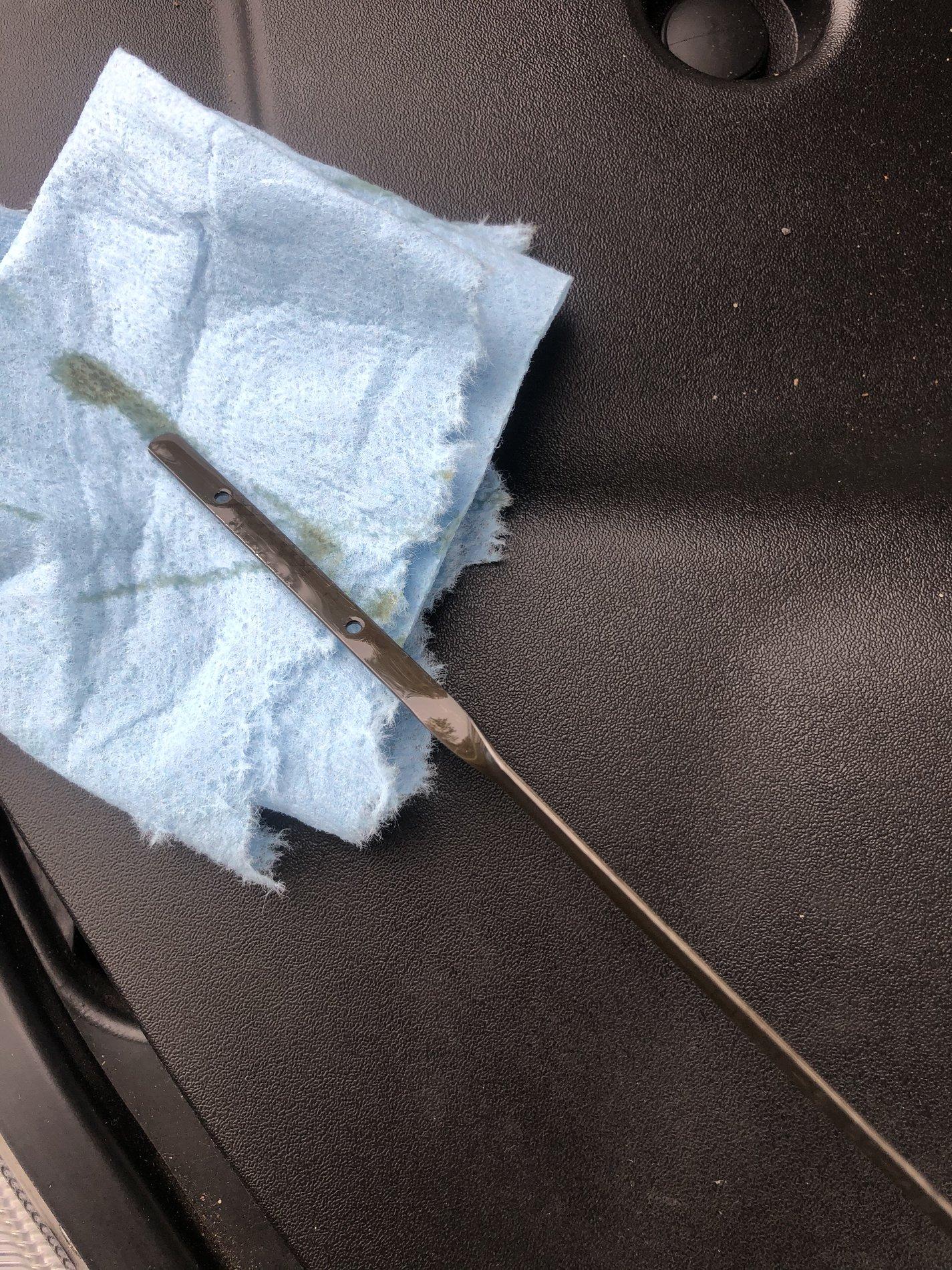

Ok took it to my front yard let run for 10 minutes and it seems if I stick the stick like nothing all this oil rubs into it and makes it look over filled(picture with blue towel) but if I do it slowly and straight down without bending it I can kinda of clearly see how it’s not above the oil line (picture with white paper towel)
I usually have to check mine several times because the same thing happens. You would think there would be a more decisive way to check.

Just did my other vehicles earlier all went perfect, this was my first time on ranger but ran into that problem, it just seems that I have to put the stick gently for some reason. I end up putting the full 6.2qt but just as previous post had to keep checking over and over, don’t know why it just rubs the whole thing as it’s going in.

I had the same "issue". I would stick it in, and then remove it and the level was unreadable with all the oil all over the dipstick. I ended up sticking it in and then removing it quickly and finally got a good reading.....just have to be quick on the draw.
By
yeah, I had to do it gently and making sure the stick went in straight but still.
