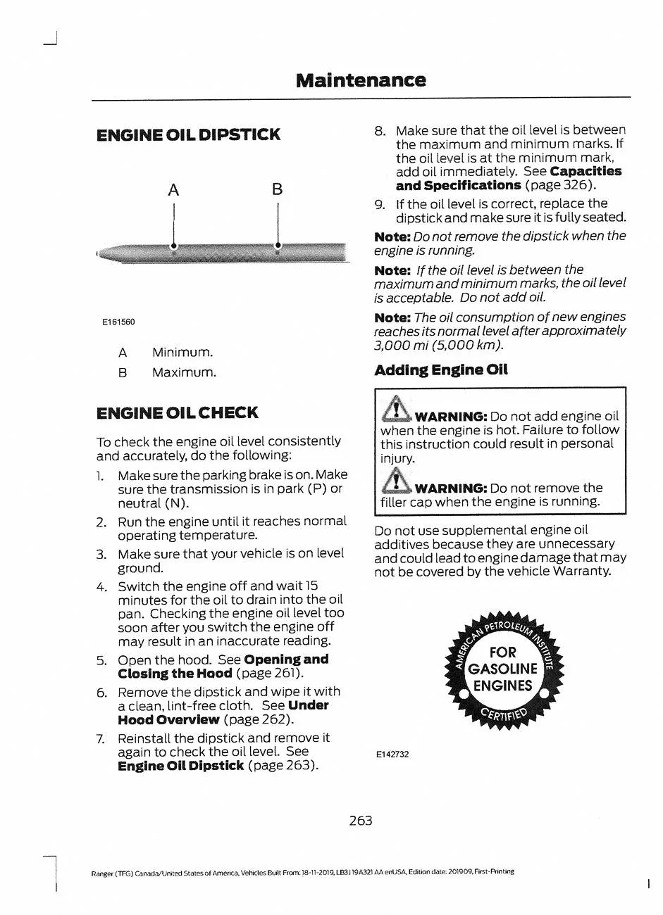

I only fill to the top hole on the dipstick. The top of the crosshatch is the maximum fill level.
The owner's manual indicates that the bottom hole is the minimum fill level and the top hole (not the crosshatch) is the maximum fill level.
Yes, you are correct. The top of the crosshatch is the normal fill level as far as I can determine. The top hole is maximum fill level.

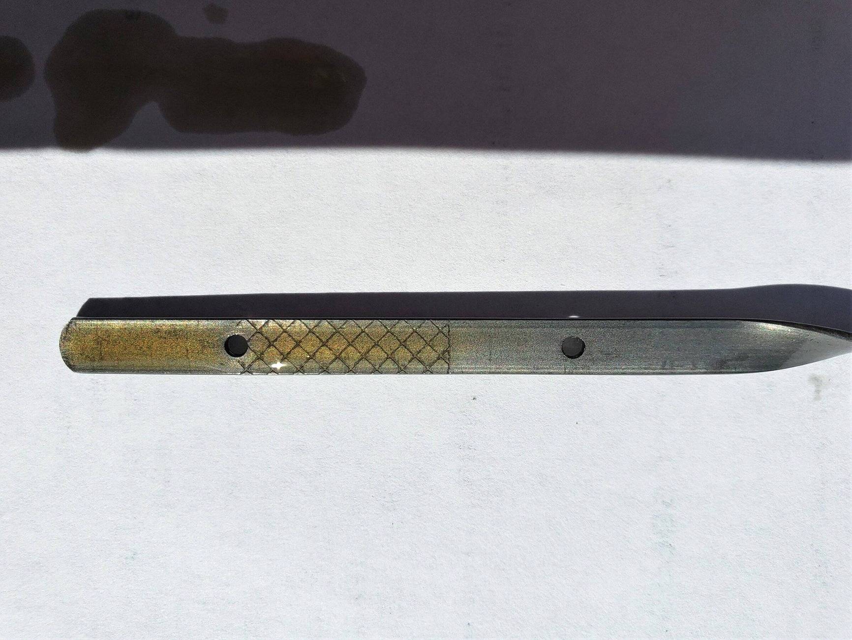

Bob, Thanks for the input. This does not work on my Ranger. When I 1st got the truck I tried waiting 15 minutes like the manual recommends and then 4 hours (the reading improved at this point but still iffy) before checking the dipstick. The oil is partially suspended and does not drain sufficiently for a clear reading until it sets overnight.
This probably has something to do with the configuration of the drain tube and/or my climate but I'm not concerned why it does not drain quickly because there are no oil leaks or oil pressure issues. After I switched from the synthetic blend to the full synthetic (Motorcraft) it still took overnight to get a nice clear reading. I would prefer a cold reading anyway because this will show the actual level of the oil before expansion from the engine heat up.
Unlike my 1999 and 2011 Rangers, I could gas up, clean the windows then check my oil level and get a clear reading.
The attached photo shows the oil level reading after setting overnight...:)
