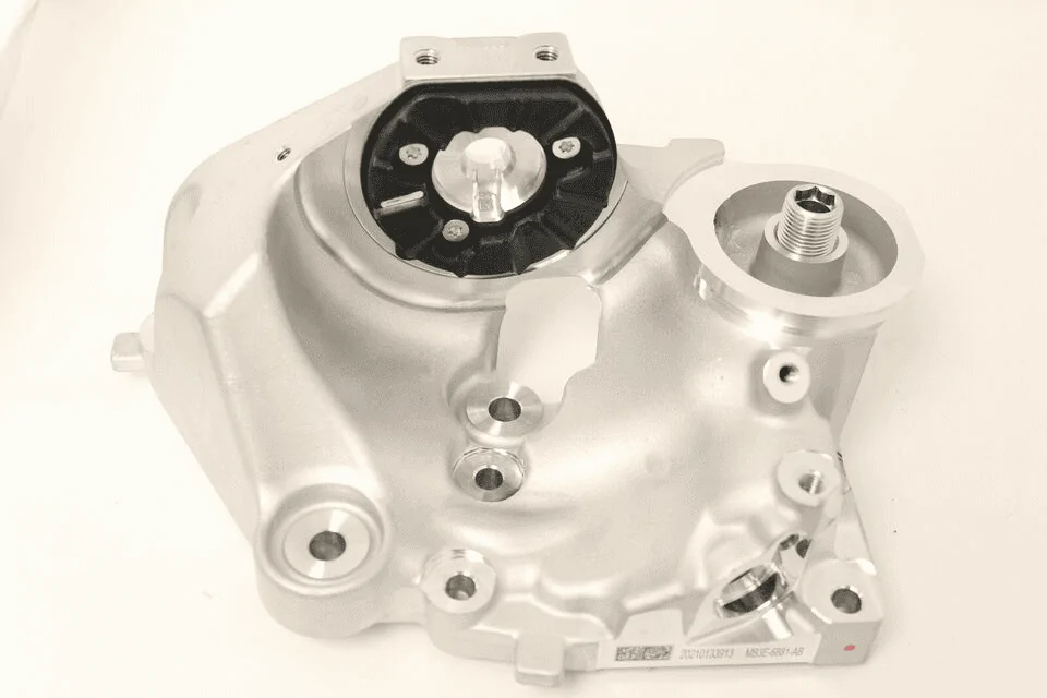

The threaded bit that the physical oil filter screws on too. My googlefu says it's not a big deal.
This is the best picture of it I can find
Is this the first oil change? They impact the filter on really tight from the factory so that might of caused it. Unless you are wrenching it on yourself. Should only be hand tight. Very hand tight but hand tight.
I had that piece come off of one of the cars. Can't remeber which one but cleaned it up, put a little blue thread locker on it and never had another issue.

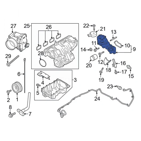

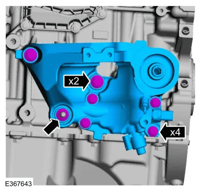

The Ranger has a one-piece unit for the Oil Filter Adaptor assembly:
However, if the pic matches you should be able to find a BIG hex key (Size?) and thread the boss back in and secure with Loctite.
Various Part Numbers come up, but this one appears to be the correct part number.
KB3Z-6881-A - About $130.00 Price wise from the sources I found.
No documentation found on install of the threaded boss, only the whole unit itself.
As I was curious if the boss had a stop or do you just split the difference on the length of exposed thread for the filter.
As far as size goes, my next oil change, this summer I can check if I can get one. As I MAY have a big Allen Key to fit it.

I had that piece come off of one of the cars. Can't remember which one but cleaned it up, put a little blue thread locker on it and never had another issue.
Never had that happen to me on a vehicle. Gotta say, if it did so I think I'd be a bit freaked out. Don't like any sort of mechanical boo boo's when I dealing with oil changes. And that piece coming off with the filter would definitely cause me some stress. Must add, the thought of adding loctite to it makes me nervous just thinking about it. I'd be paranoid about getting loctite into the oil system.
When I threaded it back in it felt like it had a stop but I also was in a bad mood after fighting the old filter and didn't want to make it worse
