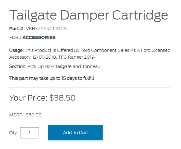

OEM 2019+ Ranger Tailgate Damper Part# VKB3Z-99406A10-A by DeeZee DZ43206

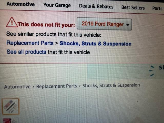

That damper is for the F150 and will not fit the Ranger. The brackets are totally different on them.
Dang, sorry about that. Well I guess Varsity Ford is still the best deal for a Ranger. G.B.

No biggie. :) My Ranger is in my Amazon garage so it automatically tells me if a part is comparable. Plus having recently installed mine I noticed the brackets were different.

My Dealer price matched Varsity with no questions - other then asking me to show them the price on my phone.
