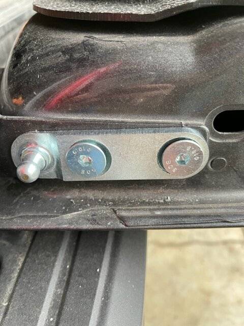

I bought a cheap version of this.... and well it's being returned. Maybe I am anal, but the bracket doesn't fit right. The holes are off and the bracket doesn't fit flush. Granted it was $20 and I probably could have forced it, but it wouldn't sit flat.
A-Premium Tailgate Assist from Amazon. These bolts aren't loose they are tightened up.
Someone please tell me a brand you used that this bracket fits. As they all look the same.
There's a lot of copycat ones out there but only one original which is DeeZee! I've had mine on for almost 3 years and am always in the bed and it still works like brand new.

Yeah, Amazon has a real problem with crappy copycat/fake products. Several of the knock-off dampers have stolen pictures and footage directly from the install video I made and used them in their Amazon listings, which has resulted in people who watched my video thinking they were buying one that I either endorsed or actually used in my video. It's been a real headache fighting with Amazon to get my content removed from these knock-off sellers. But I've won several times so far.
Long story short: ONLY buy the one that is actually made by Dee Zee. Yes, it costs a few bucks more, but it fits perfectly, and works great.
