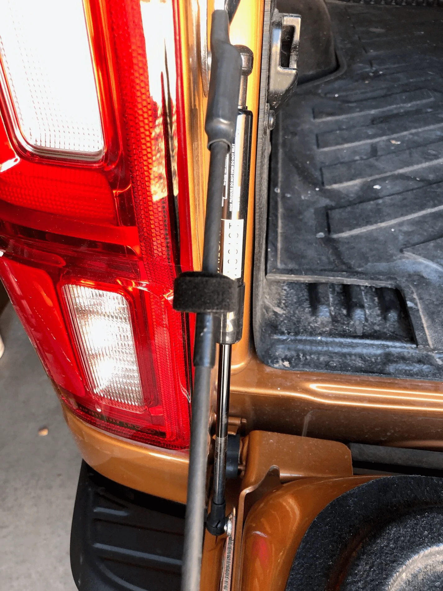

Eli, you have to do the damper mod. Yes it sounds silly but there is a mod for a mod. :shock: Get a velcro tie and add a piece of black tape under it and it will keep it from binding between the damper and the body.

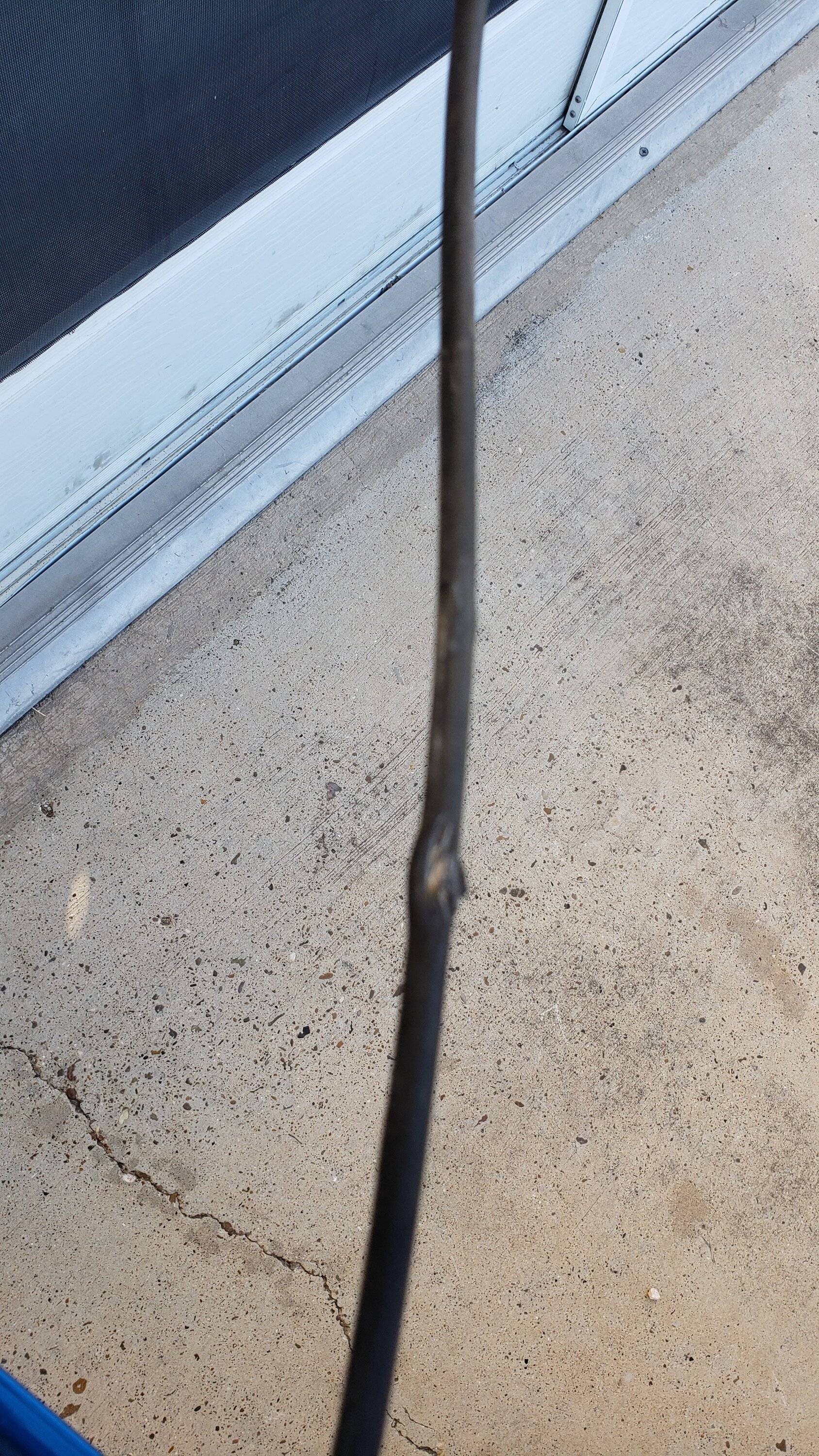

I installed the dreaded "tailgate damper" on my '22 XLT yesterday. (there sure are a lot of amusing comments...) I had four previous Rangers without a damper of any kind.
Other than it seemed like a low-cost upgrade, I was concerned about accidental drops of the tailgate causing shock damage to the reversing camera.

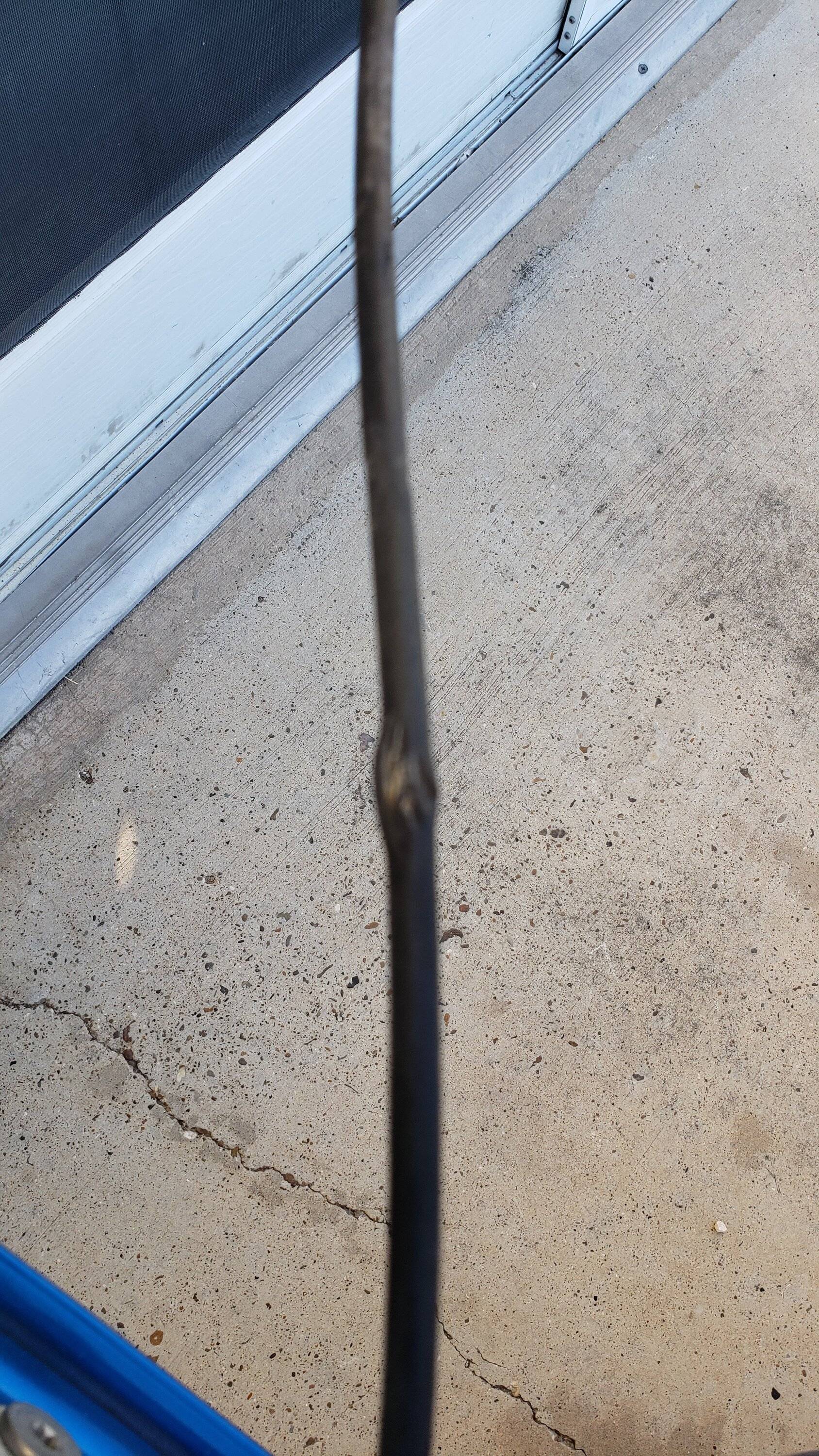

I experienced the problem where the tailgate cable tends to go between the body and the damper housing.

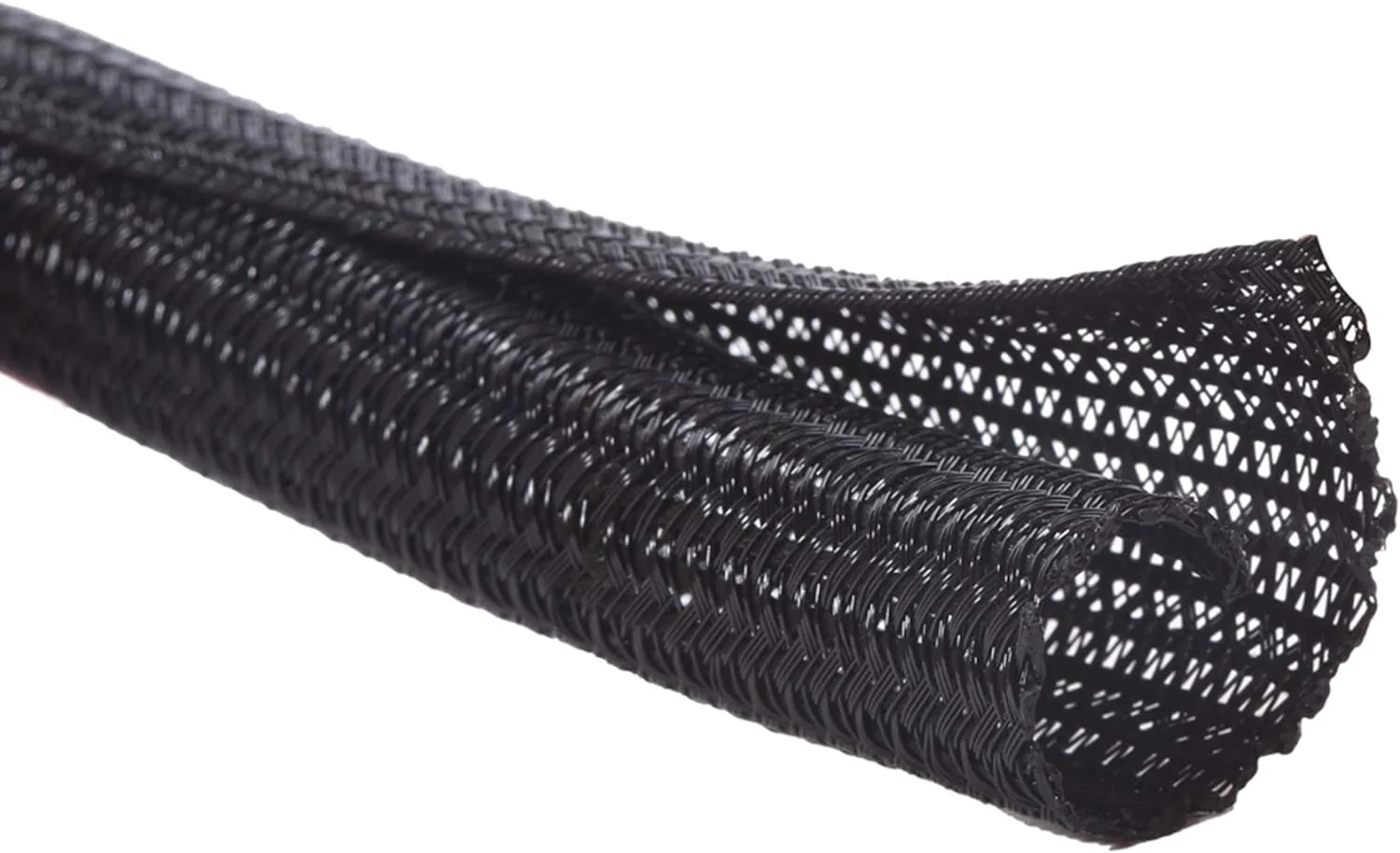

I decided to try putting electrical "convoluted loom" over the gate cable. It is similar in concept to the "velcro" fix, but it seems to work very well. The OD of the loom is just large enough that it no longer gets trapped between the body and damper. I bought 1/4 inch loom by the foot at O'Rielly's. I bought four feet, but it was more than needed, 3' would have worked.
I'll post a couple of photos for reference.
UPDATE: The cable had a tendency to slip through the slit, so I replaced it with a different type of loom that wraps around the cable. "Alex Tech 10ft - 1/4 inch Cord Protector" from Amazon.
