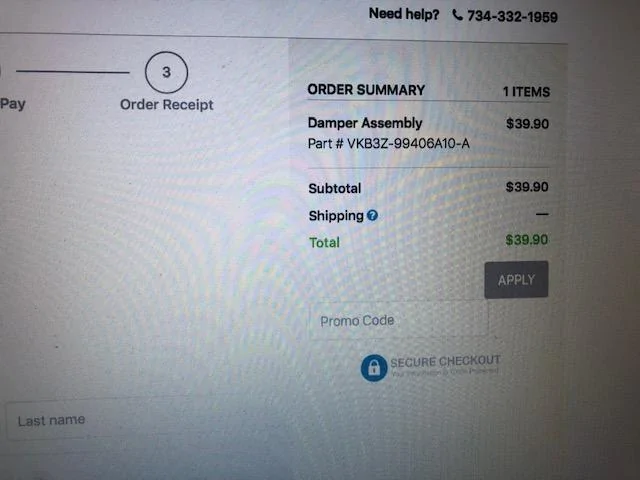

Just ordered mine from Varsity Ford.
$39.90 plus $12.42 shipping
Total: $52.32
Did not see where to enter the code WELCOME for the free shipping discount.
I sent them a message to try and get the shipping refunded.
I'll just have to wait and see how that goes
After you click the green bar that says "Secure Checkout" it was on the next page on the right side,Promo Code. I think another member here called them and they credited back the shipping so you might want to call them Monday if you don't hear back from the email.
