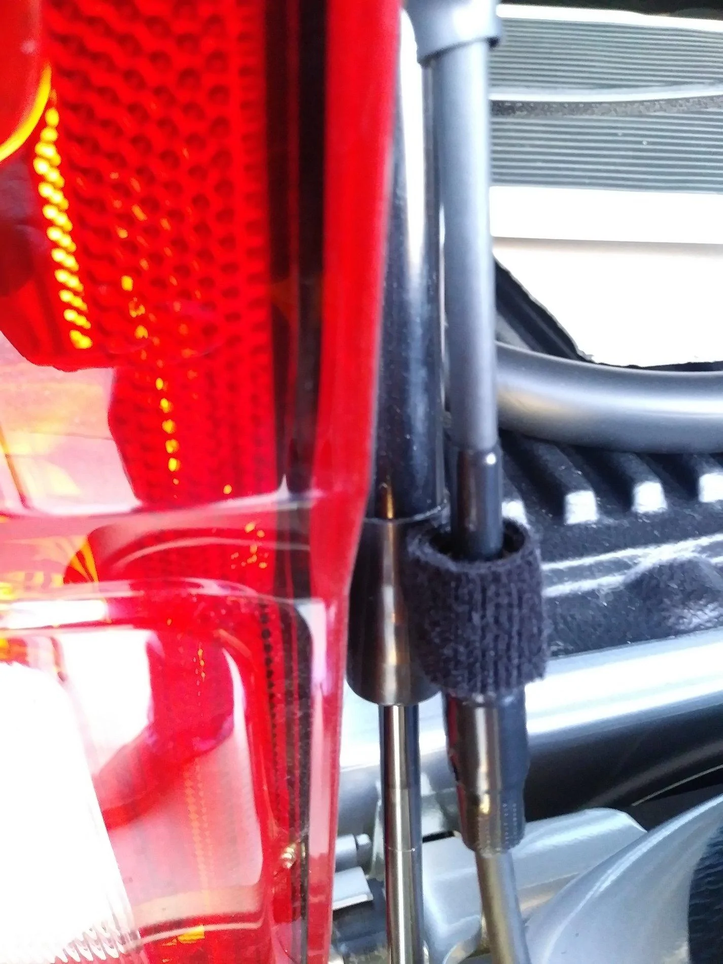

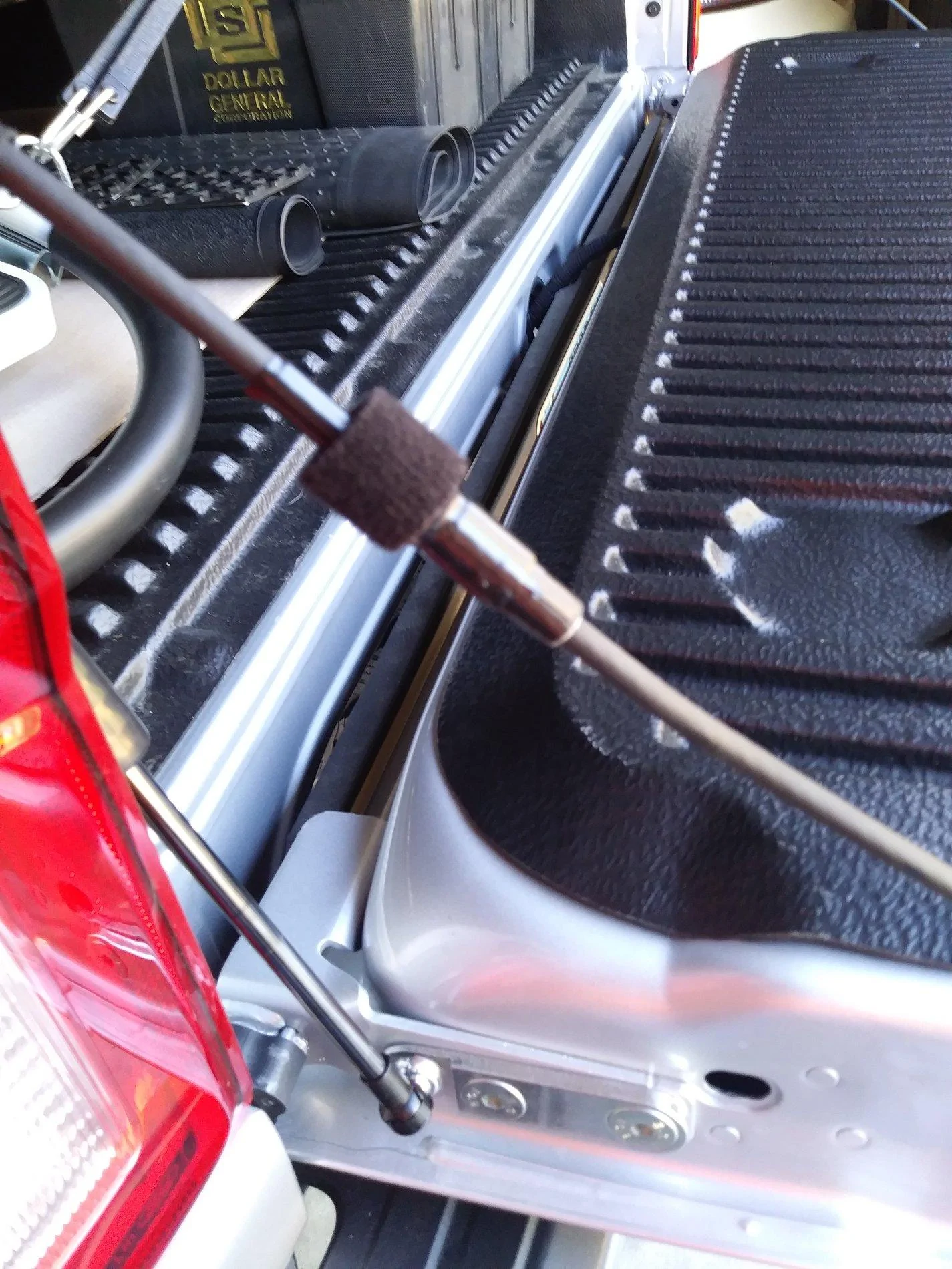

I installed the Ford/DeeZee unit and love it. But I noticed that the cable tends to want to rest BEHIND the cylinder, putting outward pressure on the ball/socket retainers. It would slightly catch on the cylinder and 'pop' on decent. While this might never push the cylinder loose, it can't be good for it. Here's a guide I fashioned out of velcro strip and electrical tape, It forces the cable to rest on the outside of the cylinder, putting pressure inwards. Like I said, it may not cause a problem but this insures that it won't .

This was the first thing I noticed after installing mine too. I'm going to steal your idea and add this to mine once I'm back home this weekend. :like:
All I did was loosen the fitting holding the cable (tailgate side) just a hair so the cable moves freely when opening/closing. Instead of the cable pushing against the cylinder and trying to go behind it when it closes, it rests in front of the cylinder with no pressure against it.
I was going to insert a thrust washer to accomplish that same thing, but didn't have one in the "existing resources" drawer of the toolbox!
