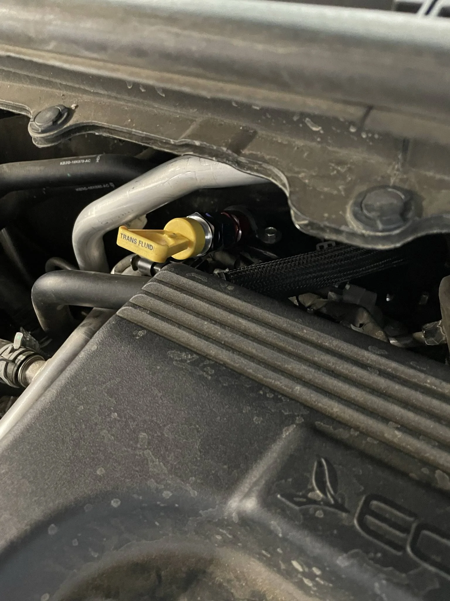

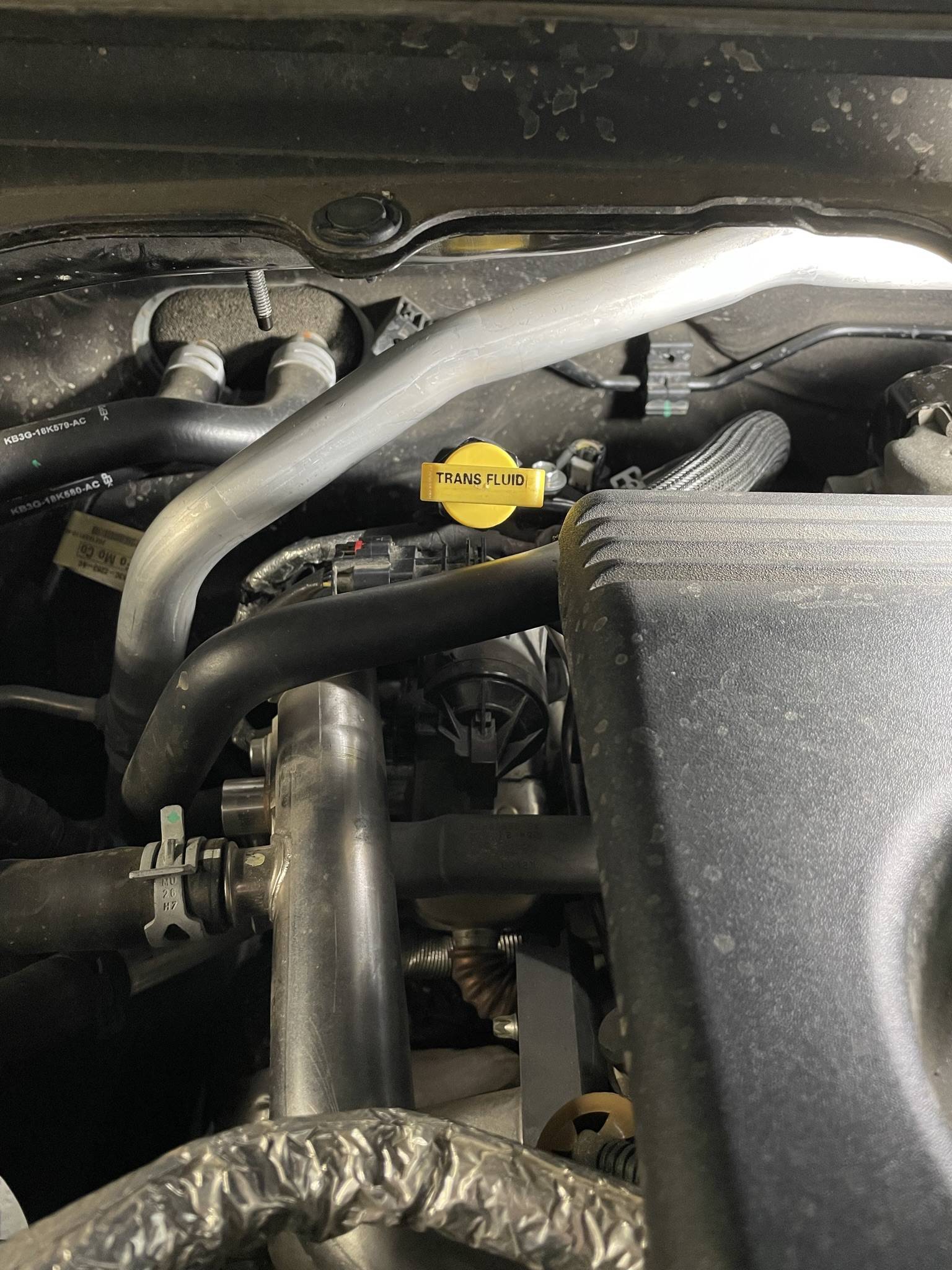

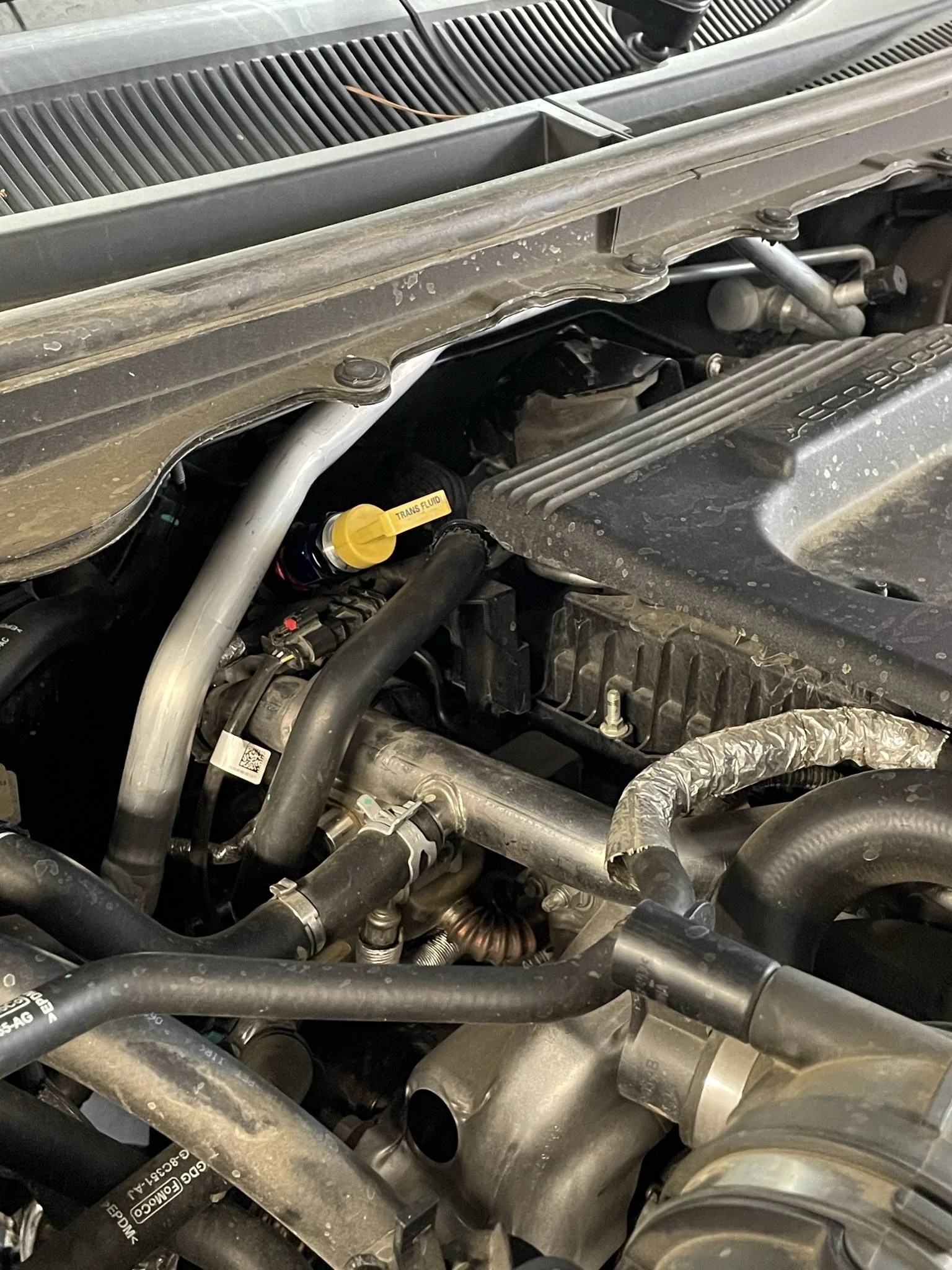

It will be a small batch at first, for sale here, the people who already have stated they want one, have the first right of refusal, they were the ones who motivated me as customers ready to buy before I even made one.
https://www.ranger5g.com/forum/threads/remote-transmission-dip-stick-aftermarket-support.24547/
That batch will come with strings attached, I need them to go to people who will put them on right away,(or soon) give feedback on installation, fit and accuracy of markings.
I may have a few sticks with temp tabs to go to high heat areas, I have a temp tab on my development stick, it's showing little to no signs of heat, but it's been cool here.
If that goes well, then the next batch will probably be 200 sticks, if there are changes to be made, then the next batch will be revised to include those changes.
The original price point target was $150 I know I wont be able to get that low, but we will see, the first batch is a loser anyways, all the time money and effort to get this far has been pretty steep.
Note: they are for the 2019-2022 2.3T engine only, maybe the 2023 as well, I have to see one of those trucks.

Highly recommend it! Bunch of us here on the forum have bought and installed the sticks. They work perfectly. Mike's done a fabulous job with the design. It literally looks like it rolled out of the factory with it.

The FitzStick is a braided hose that is pre-bent with shrink wrap to keep the shape - I'm probably describing it poorly - it fits in perfectly and is pre-marked - it is very accurate. It looks like it came off the assembly line. You absolutely won't be sorry you bought it.
