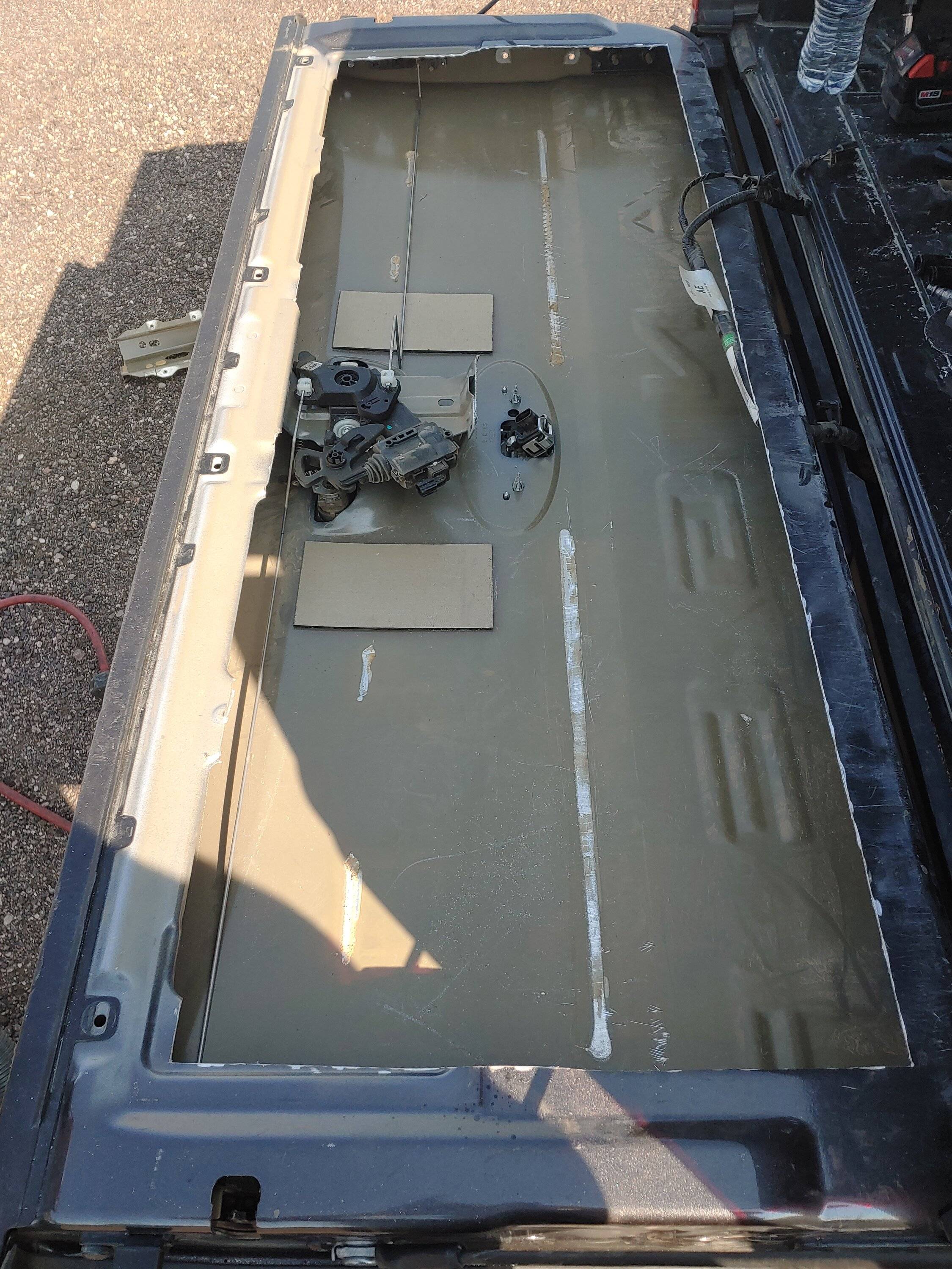

I wanted to get some general feedback as I feel like I am possibly missing something because the idea so simple I have to be missing something obvious. As most people know rear gate can mounting generally requires a steeply priced combination of either a replacement bumper or some sort of swing mount hitch option.
So I am in the beginning stages of designing more or less a steel bar U-shape (for lack of a better description) type mount. It will require drilling for the attachment points, but those points would actually be the tailgate access panel on the rear of the tailgate. I believe the height can easily be fine tuned to allow for proper clearance of opening the tailgate. The apparatus' only touching point will be the mounts, the steel bars would "float" over the top of the tailgate, then have drop down arms for the gas can mounting locations.
So this idea seems way to straight forward, what am I missing?

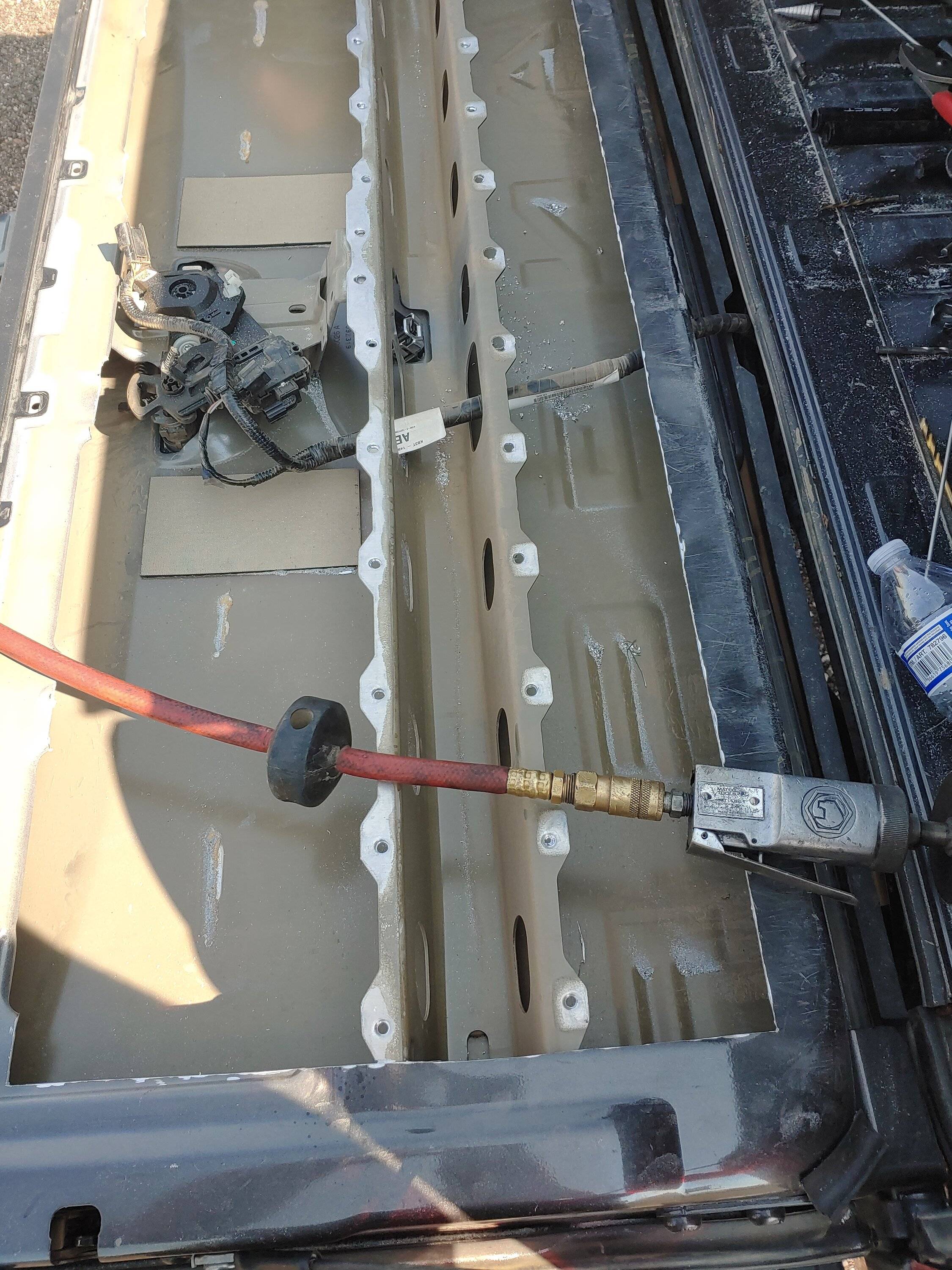

I like the overall idea. If anything you.may want to consider doing something to add strength to the Tailgate. When I did the install of the Hurricane Fab Storage I noticed there wasnr much of bracing material in the Tailgate. Yes it is designed to carry up to 300 LBS when folded down, but up in the locked position might be another story.
For those wondering you have to remove the structure support to install the Hurricane Fab Storage.

I'm not a fan of exterior mounted cans, other than milspec metal cans, mostly for heat and expansion pressures. The potential problem I have with 5 gallon metal cans is the weight when loaded, and added weight of the mounting bracket. If I understand your design, the only contact point is on the inside of the tailgate, then up, over and down on the outside, with no additional support. The bracket would have to be substantial, if I have that right. The fuel can location being behind the tailgate, is prone to exaggerated momentum forces, with every bounce, all of which would also be magnified by the wrap around design and natural springiness it creates. All together, the load at the connection point would have much greater dynamic loads than I would be comfortable with on an aluminum tailgate with little internal structure.
Sorry for the cheesy graphics, but adding a second brace point on top of the tailgate would greatly reduce the dynamic load on the primary connection and add stability.
