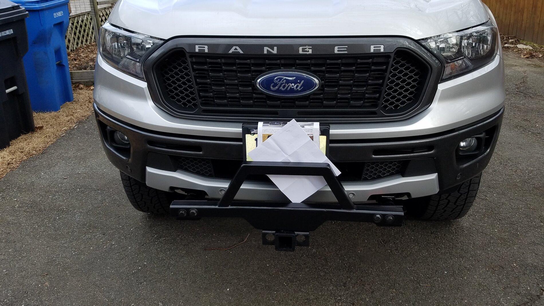

What I'd like to do is be able to mount a winch on a temporary basis on the front of the truck. Yes, I could mount on on the regular tow hitch on the rear but that's not what I want to do.

So, you removed the tow hooks and used those mounts?

Plus I can un bolt set up and never new it was there

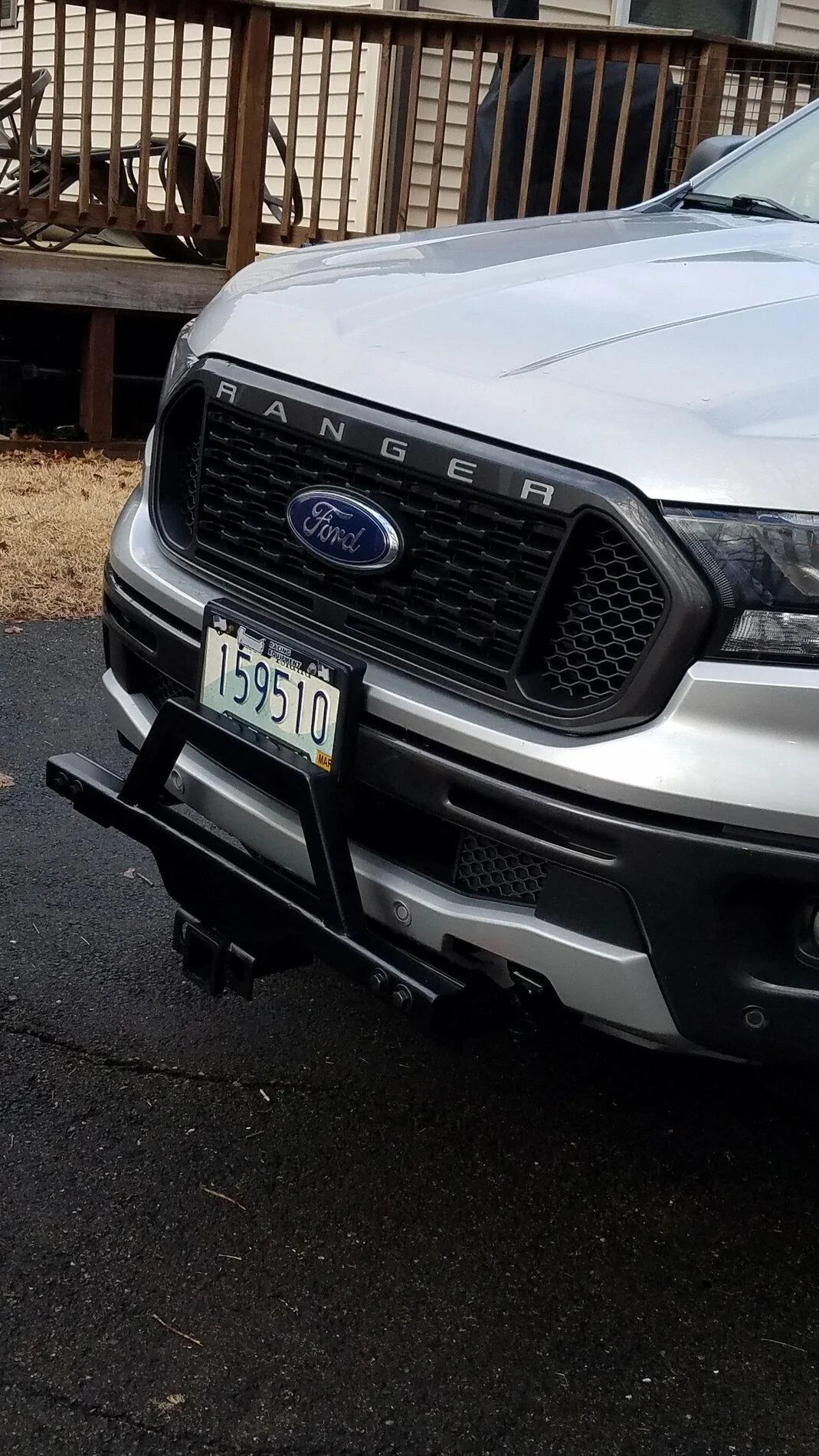

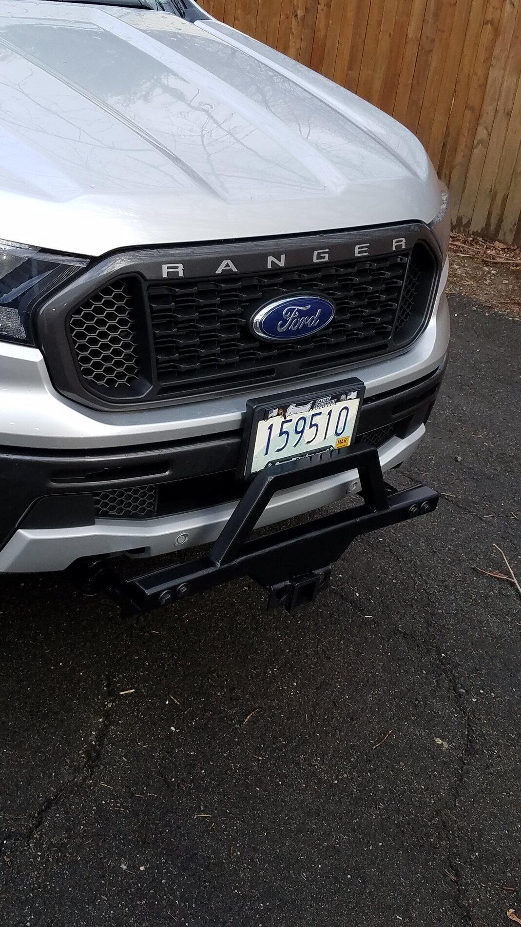

Bought two mounts and used there setup just welded up 2x2 .25 steel. With all mounts. Could have copied and made there product but not like that.

Guys just welded up what I needed to do to put a mini on truck. Just wanted to put it out as can put hitch on. Can't go closer as hits skid plate.
