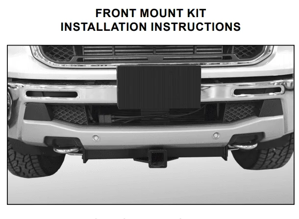

no pictures as of yet, and the instructions do not include a parts list and mention the need for a new skid plate. awaiting more info. I'm in a holding pattern.
In the instructions there is a picture of this new "skid" plate. I'd definitely not part with mine for what they are replacing it with if the install instructions are accurate (they appear to be as the truck definitely looks like mine).

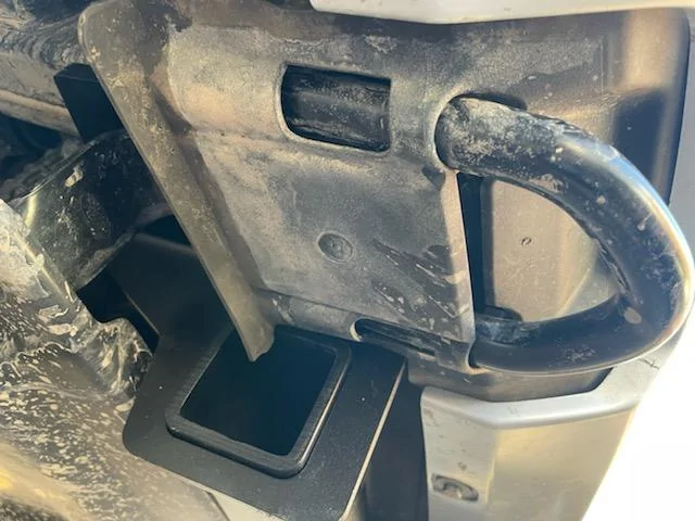

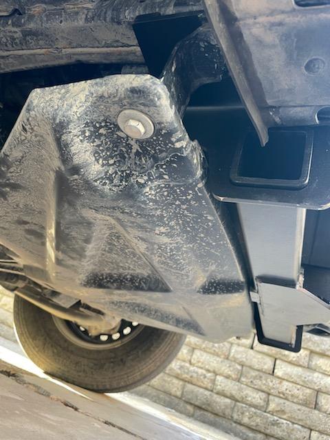

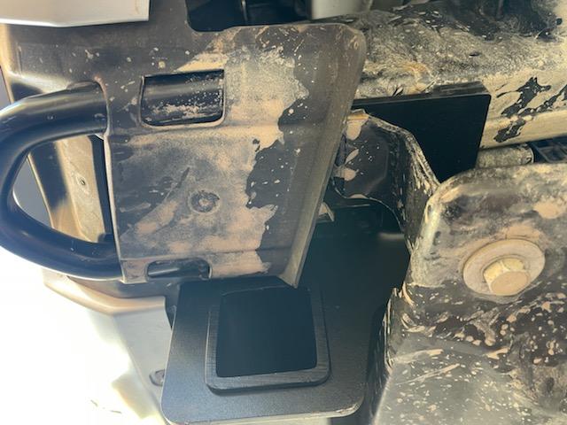

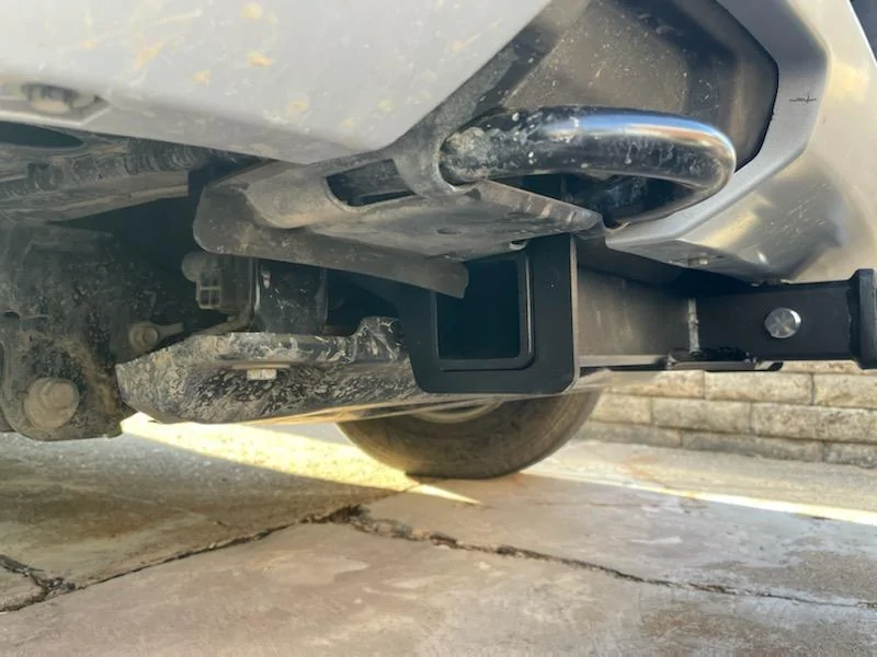

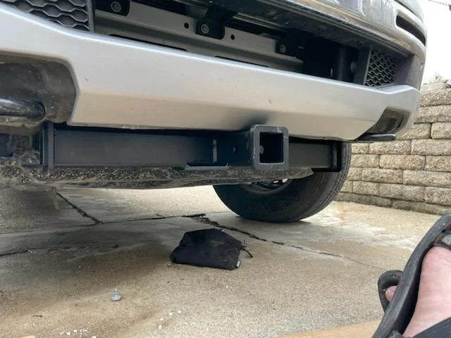

I made a profile just to thank you and tell you (or anyone else down the rabbit hole) this front hitch fits.
Shipping was fast it, came with zero instructions, and my factory skid plate fit back on without any issue.

Factory tow hooks went right back on without any alterations. You may be able to see in the one picture that the hitch manufacturer knew the tow hook has that little finger coming off on the back side, there is a hole for it on the hitch brackets. They definitely measured a Ranger like mine when they designed it.
I locked a cheap pumpkin protector (not sure what its actually called) in the receiver just to have something in it when not in use.
