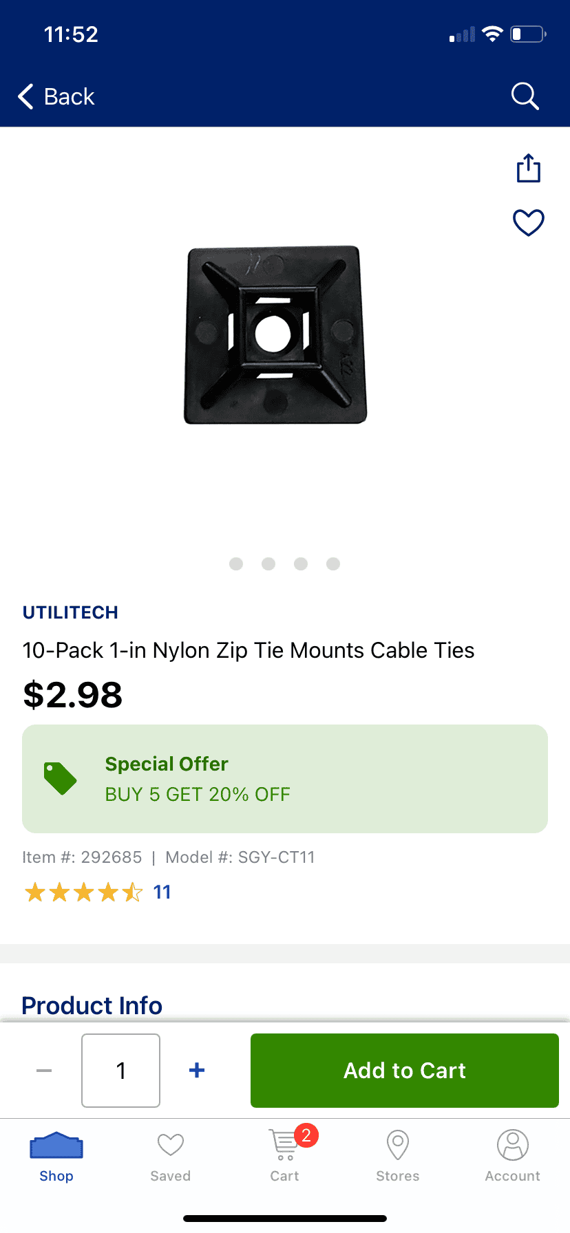

I've used the common little square ones with the "3M" backing for all the exterior wiring management on my rack. However over the summer I've learned they are not match for Georgia heat. It took time, but they have all about slowly fell off. I'm guessing the adhesive reaches a point on the black painted rack that it becomes goey and gravity does the rest.
So I need to move to more hardcore ideas. These zip tie mounts are put in places where they would be permanent anyhow, the cable management system is just as much part of the rack as other parts.
Should I just reinstall them with straight up superglue? How about a dab of JB weld? What other obvious solution am I missing?

Clean off the adhesive. Use a dab of the brown gorilla glue. Lightly dampen both surfaces. You will need to tape them in place temporarily. This glue foams/expands a bit. If done right, it can form around the tab for added adhesion/retention.
Alternatively, you will see a spot for a screw right in the middle. For exterior use, I would pre-drill and use either a small stainless screw, or a rivet. I prefer the screw, as I worry about the sharp chisel-cut tip of the rivet damaging the wire.

2 small #2 or #4 sheet metal screws to hold the clamps down or as Dfresh said drill holes in the frame but it wouldn't be fun trying to fish a zip tie through

Are you using the mounts with the heavy duty red liner grey sticky tape or the standard use tape ? The white sticky tape (usually has a green liner) that these usually come with is very light duty . Remove that tape and replace with the 3M grey tape with red liner . Clean surface with alcohol and it will be there .

Bingo was the green tape. Thanks!
The grey tape with red liner will hold almost anything if the surface is smooth and prepped well . Heat doesn't affect it like the other tapes . About the only thing that it will not adhere to is polypropylene plastic and nothing wants to stick to that ,LOL . The most common mistake people make when using the tape is improper surface cleaning . When you use any cleaner such as alcohol , you must buff off the residue it leaves behind off after it dries with a clean dry cloth before sticking the tape . We mounted hood scoops and rear spoilers to cars with this stuff and never had any issues . Most had no other bolts or attachments other than the tape . If a part came in with the tape already installed we would remove the tape and apply it ourselves because the tape would always come loose from the part and not where we adhered to the vehicle . Most aftermarket companies never prep the parts correctly and simply stick the tape to it .
