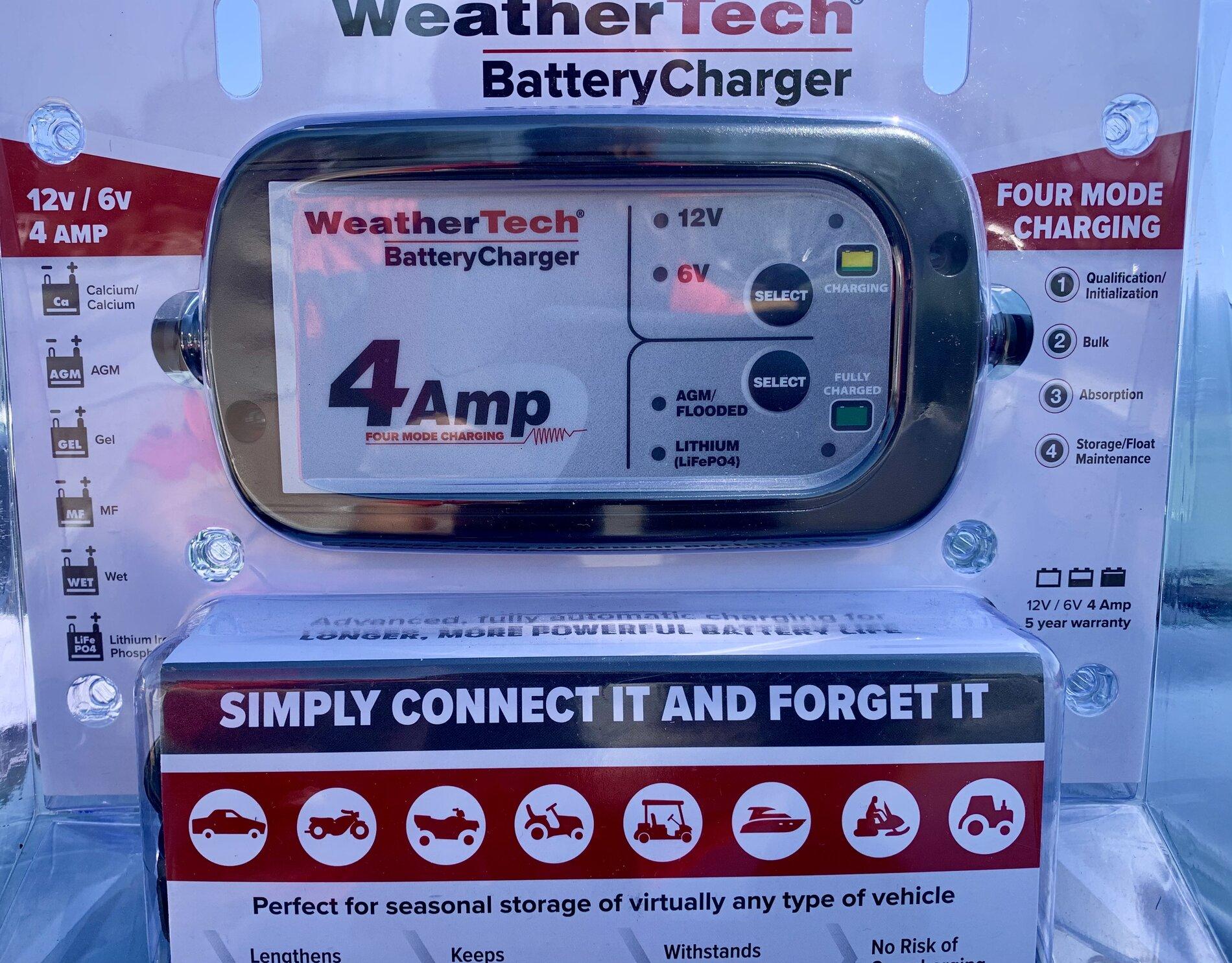

Thanks for the link ! I have known you have been using it for awhile. So does it plug into a normal garage outlet ? Do you have to pop the hood each night to attach it ? I have several very wealthy clients that use these as their countless toys sit in the garage, just never thought I would need one for a Ford Ranger. It may have to come down to this, so thanks again.
So I just picked this up the Ford dealers parts department, 69.99 !! And has a AGM setting. Poked my head in the service bay on my way out, told them what I was doing, they said they can give me a new battery only if the current one fails, they will check it as much as possible, weekly if I wish. Sounds fair to me, I know they have rules they follow. This may do the trick hopefully.

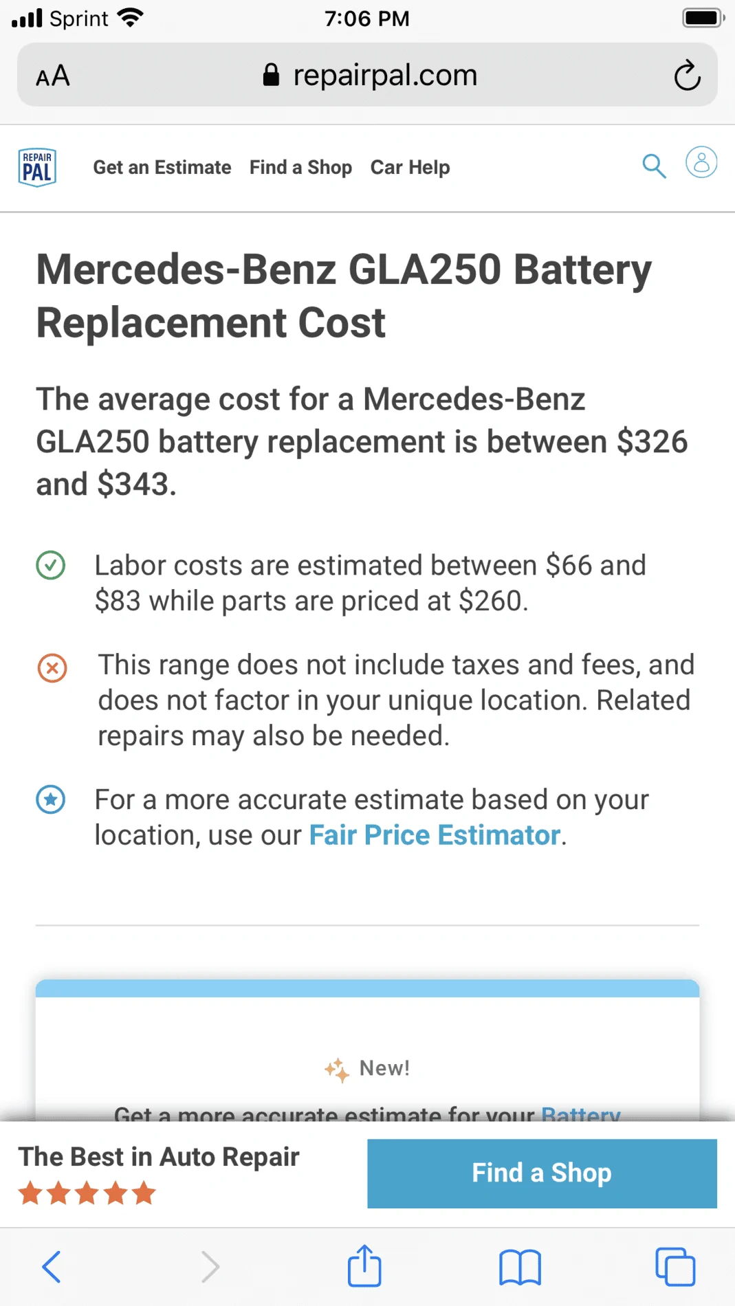

I have Mercedes GLA that the auto stop quit working, but after owning it for 4 years. Solution, replace the $500 Mercedes battery...
I got a discount on it, but the battery has electronics built in so it could not take a "normal" battery. Damn theses fancy electronics!
Umm. There are no electronics built into a Mercedes battery, or any othe automotive battery. As for the price of a replacement...
