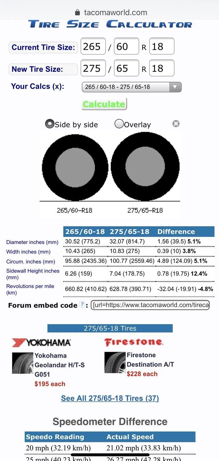

This is what I figured would fit without any modifications to the suspension on a FX4.

The issue here is where the tire can make contact with a plastic push pin cover for the front crash bar. The overall tire height is the issue here. You really should stay as close to or slightly under 32 inches.
• 275/70R18 ends up at 34.2 tall and 10.8 wide.
• 265/70R18 ends up at 32.6 tall and 10.4 wide.
A 275/65R18 ends up at 32.1 tall and 10.8 wide and is probably going to be the closest thing you can get provided the tires aren't overly aggressive. If you have a Trail Grappler or Open Country tire, you might want to drop a little more at 265/65R18 which will put you at 31.6 high and 10.4 wide.
