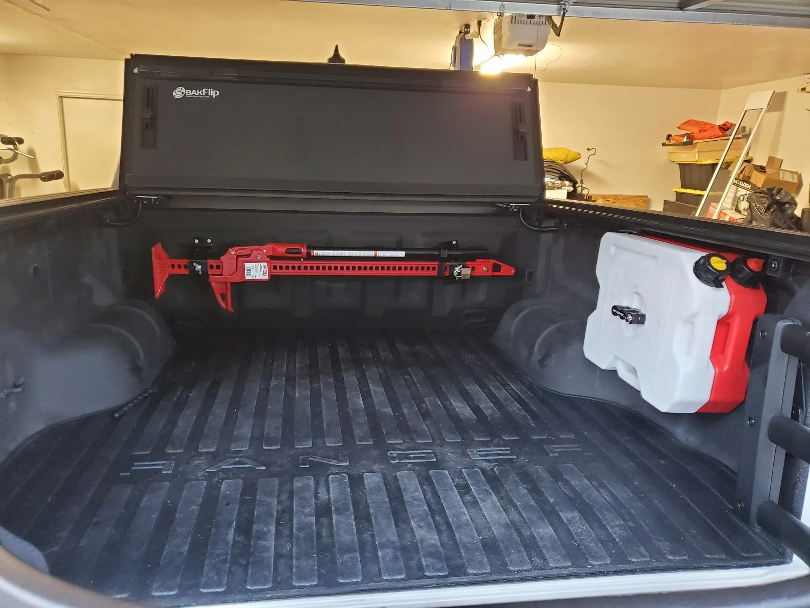

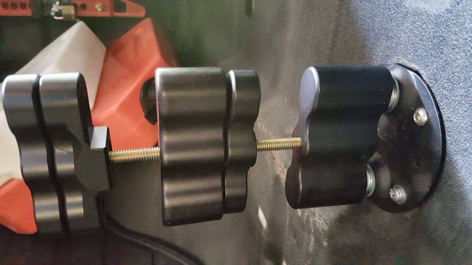

Thank you everyone. This is what I ordered from Rotopax. I used jack nuts to attach to bed side but had to use 1/4" spacers behind the mount since it's recessed right there;
2 Gallon Gasoline GEN 2
SKU RXX-2G
LOX Pack Mount
SKU RX-LOX-PM
1, 2, 2.25, and 4 Gallon Extension
SKU RX-EXT
2 Gallon Water GEN 2
SKU RXX-2W

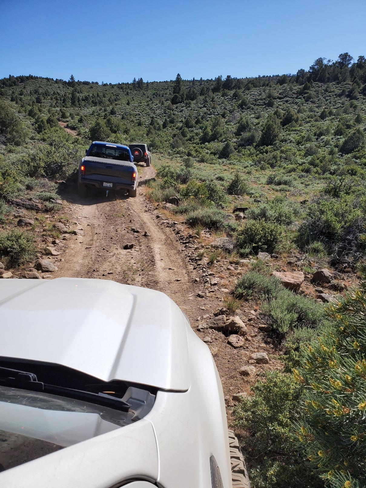

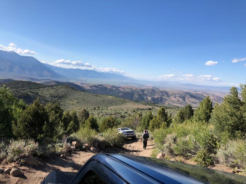

Made it through the weekend and the truck survived a 4/10 trail. Had a little rubbing so need a little more dremel work on the fender flares, but otherwise she did great. Had better clearance and turning radius than the Raptor and ended up with less pin stripping. Also hung with the lifted JL's. Now I definitely need sliders, skids and plastidip.

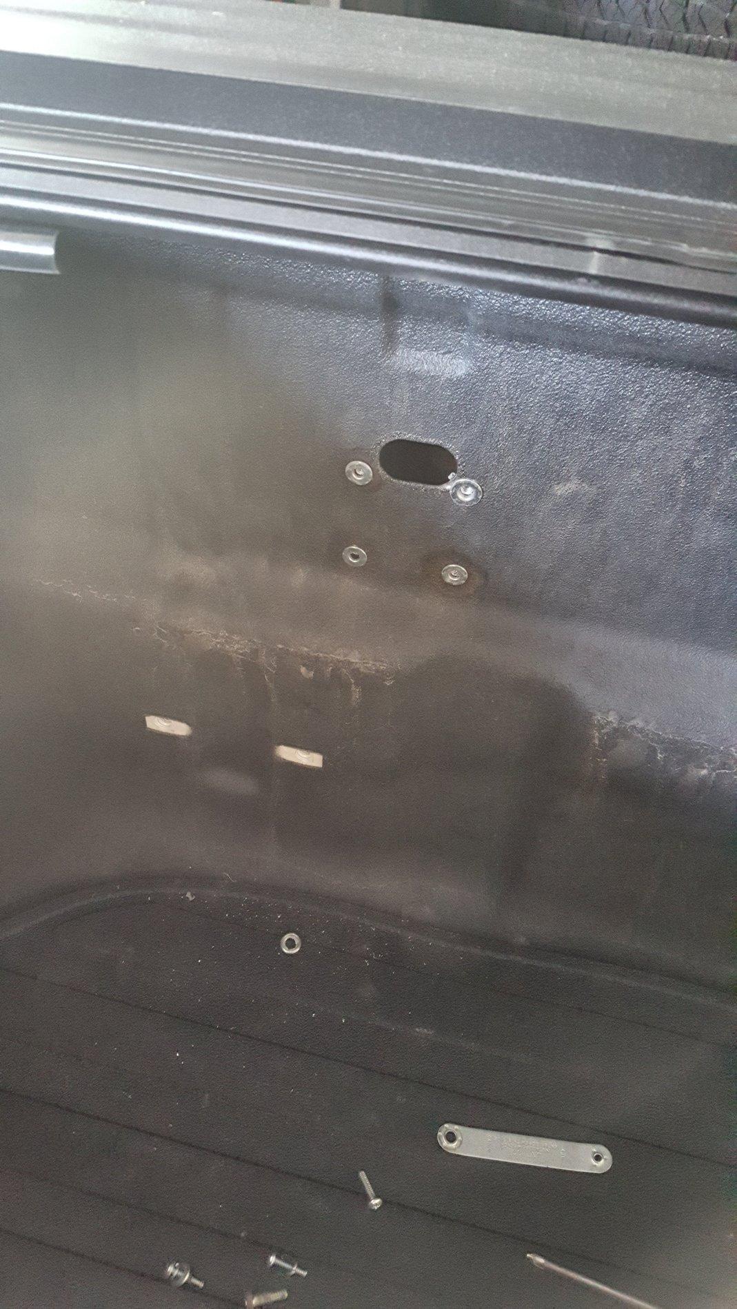

I'm generally curious to see how/where you fastened the rotopax mount to the sheet metal in the bed. I'm looking at doing something similar. It's doable to reach the back fasteners but it's up there.
srt42b
srt42b
Brian
Apr 26, 2020
Fresno, CA
2019 Ranger Lariat
  • Thread starter
  • Thread Starter
  • #23
It is accessible but might make for a long frustrating day. Although there is a grommet right where I mounted mine so that would help. I just used jack nuts since I had to for the Hi-Lift anyways. It was a 30 min job. Also of note, I have a bed extender so I mount mine horizontal and forward a bit. If I didn't need to clear the rails when the extender was swung in, I would have mounted them vertically and closer to the tailgate.

Photos didn't come out great but you get the idea. You can see my washers between the mounting base and extension to compensate for the recess in the bed side.
