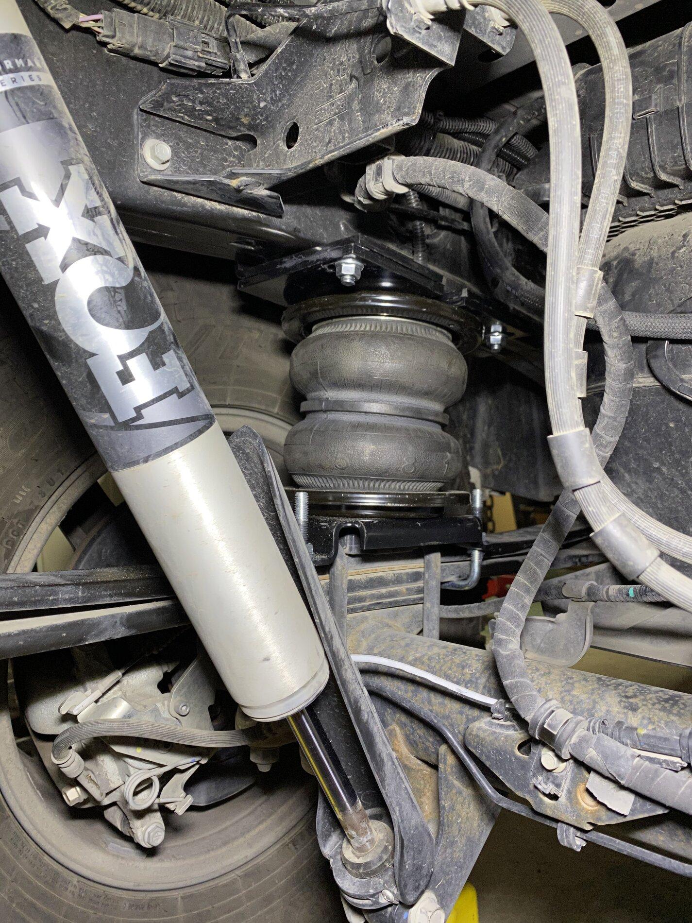

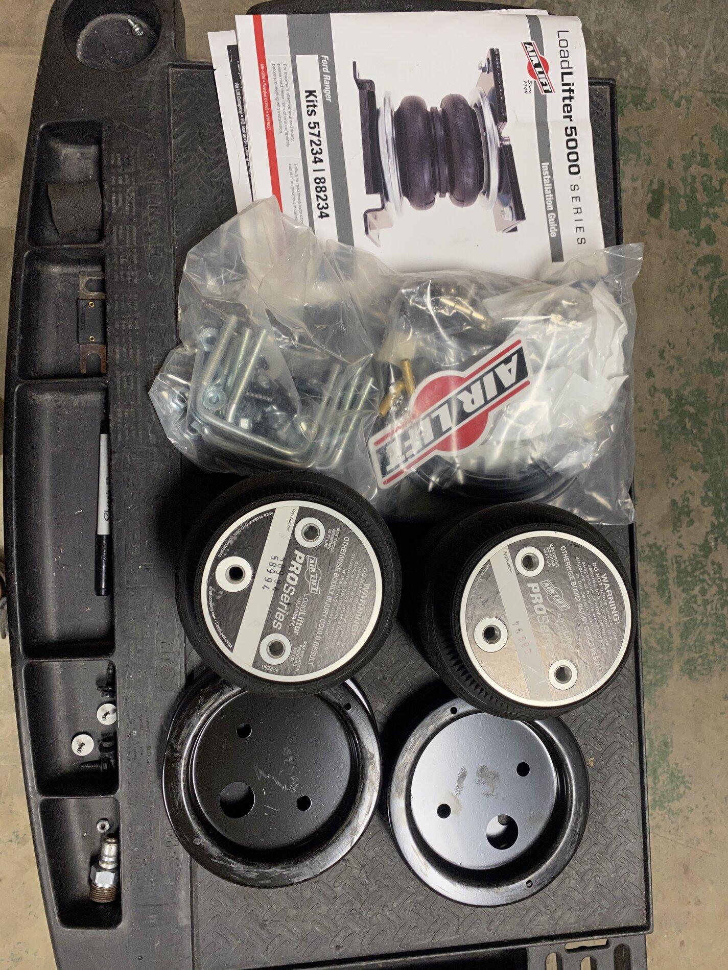

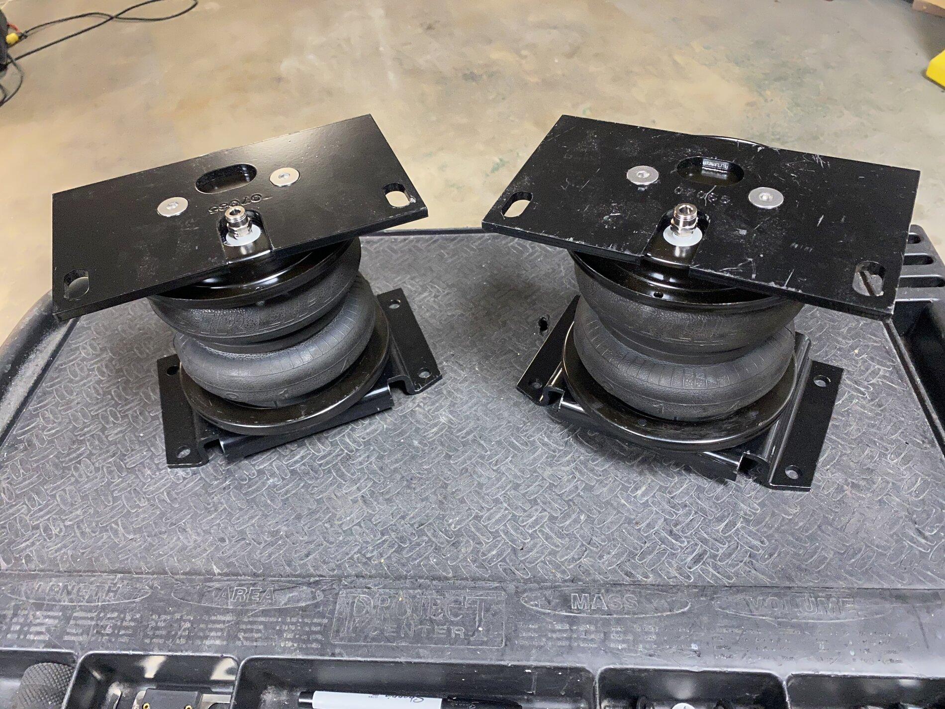

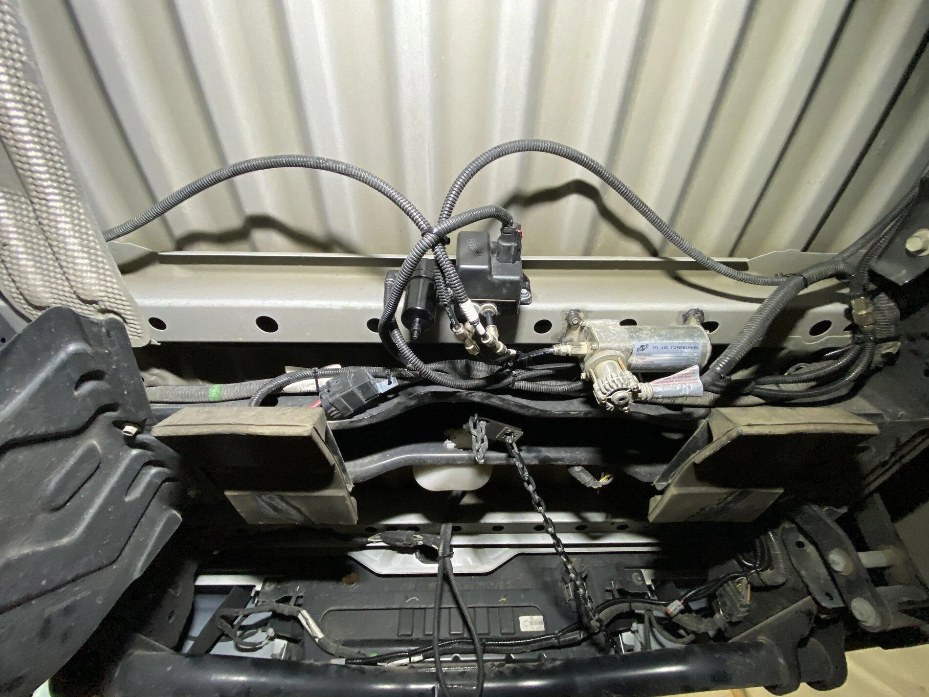

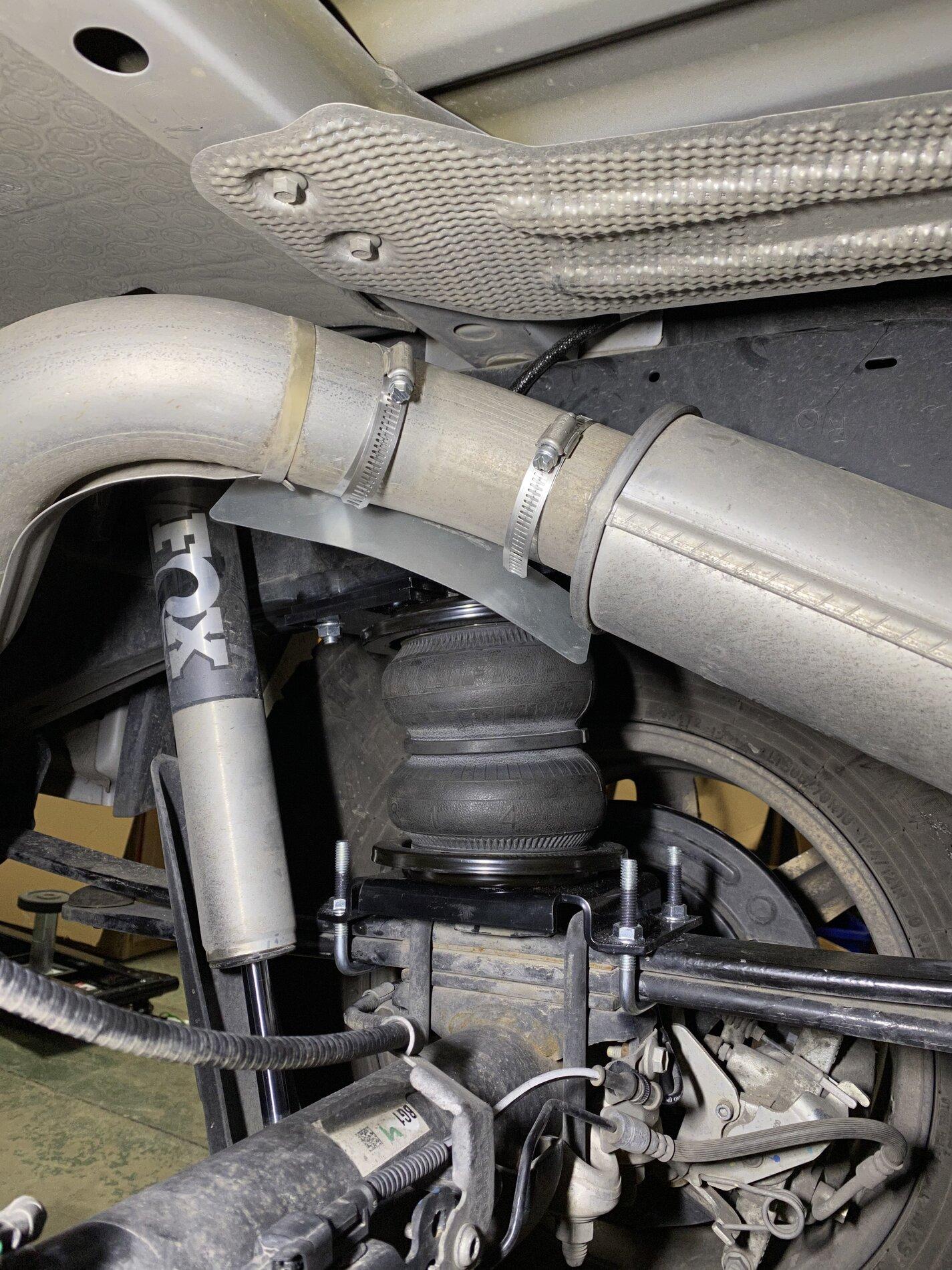

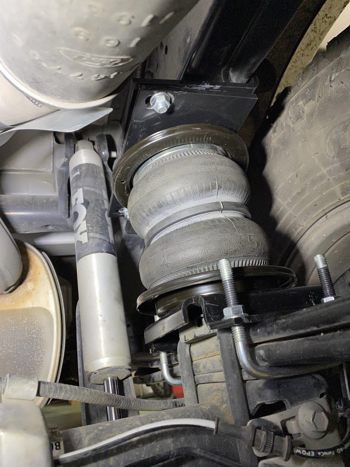

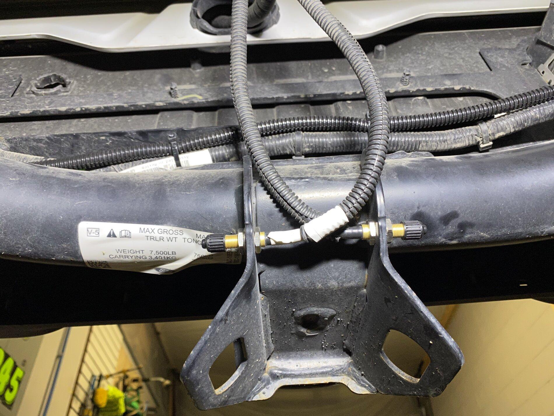

Been a busy summer here and haven't shared any updates so here is one. I added some Air Lift Load Lifter airbags in the back to help keep the Ranger level when towing. The wireless controller and Air Lift compressor were used in my previous truck, so I held onto them for this one as well. Here are a few pics.

Nice ! Did you add the exhaust heat shield for the airbag ?
What pressure do you set them to while unloaded ?
treimche
treimche
Troy
Apr 8, 2019
722
882
FORT MYERS, FL
2019 Ranger SOLD. 2005 S2000
Accountant
The heat shield is part of the airbag kit. The minimum pressure with these air bags is 5 psi. I have one of their wireless controllers so it automatically maintains whatever pressure I set it to.

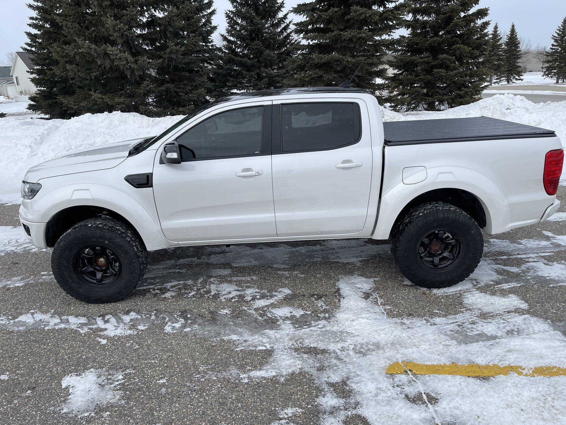

Looking forward to more pics of your new fender flares on your truck. I mean the garage shots are okay but hoping for a few better ones ay? Great build.
On the 16in wheels - does that mess with the brakes at all?
I finally got some pics yesterday and will post up. As far as the 16" wheels are concerned, they don't mess with the brakes at all. There is plenty of clearance.

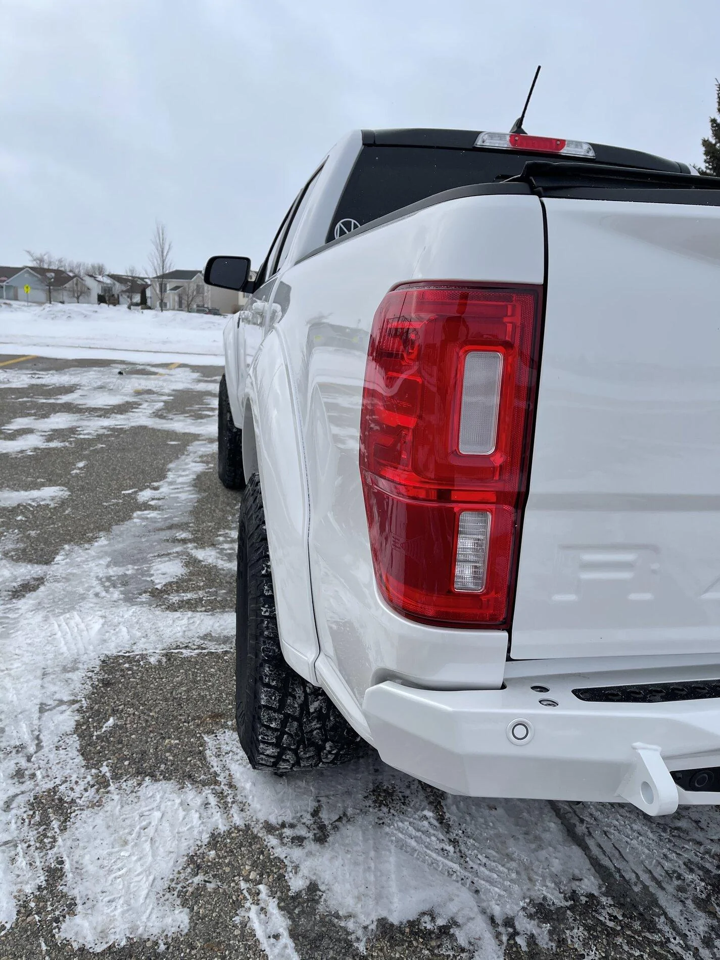

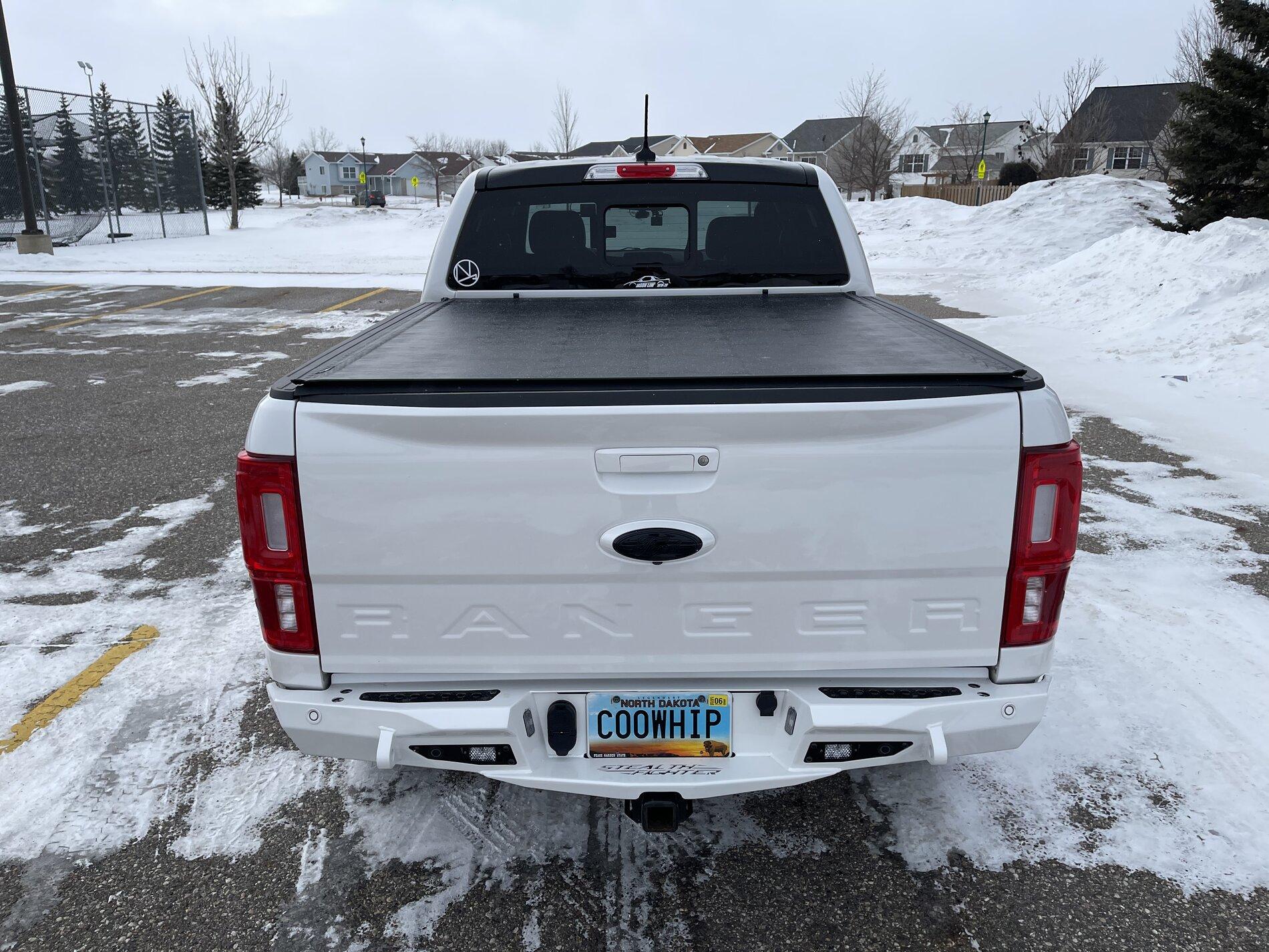

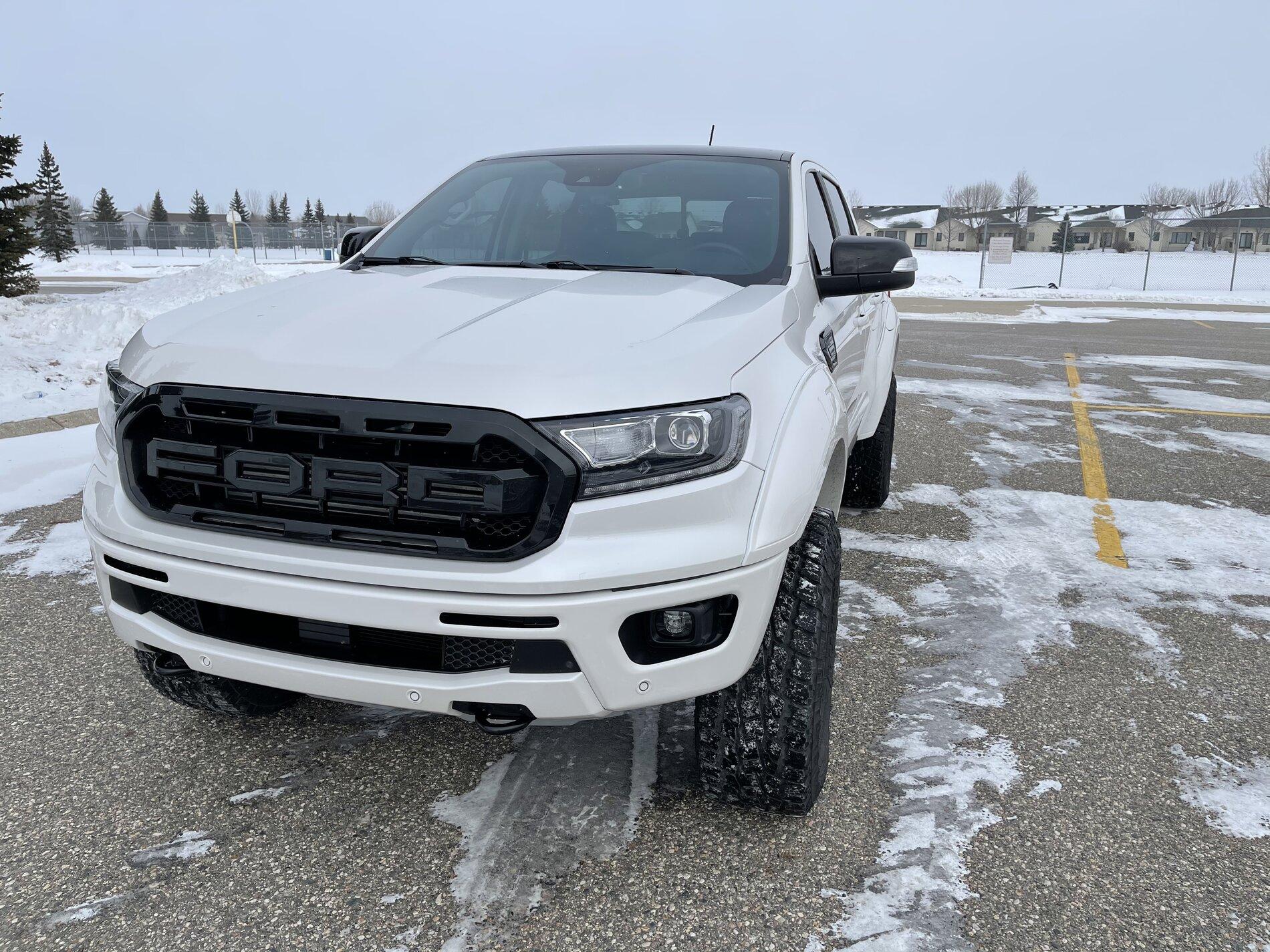

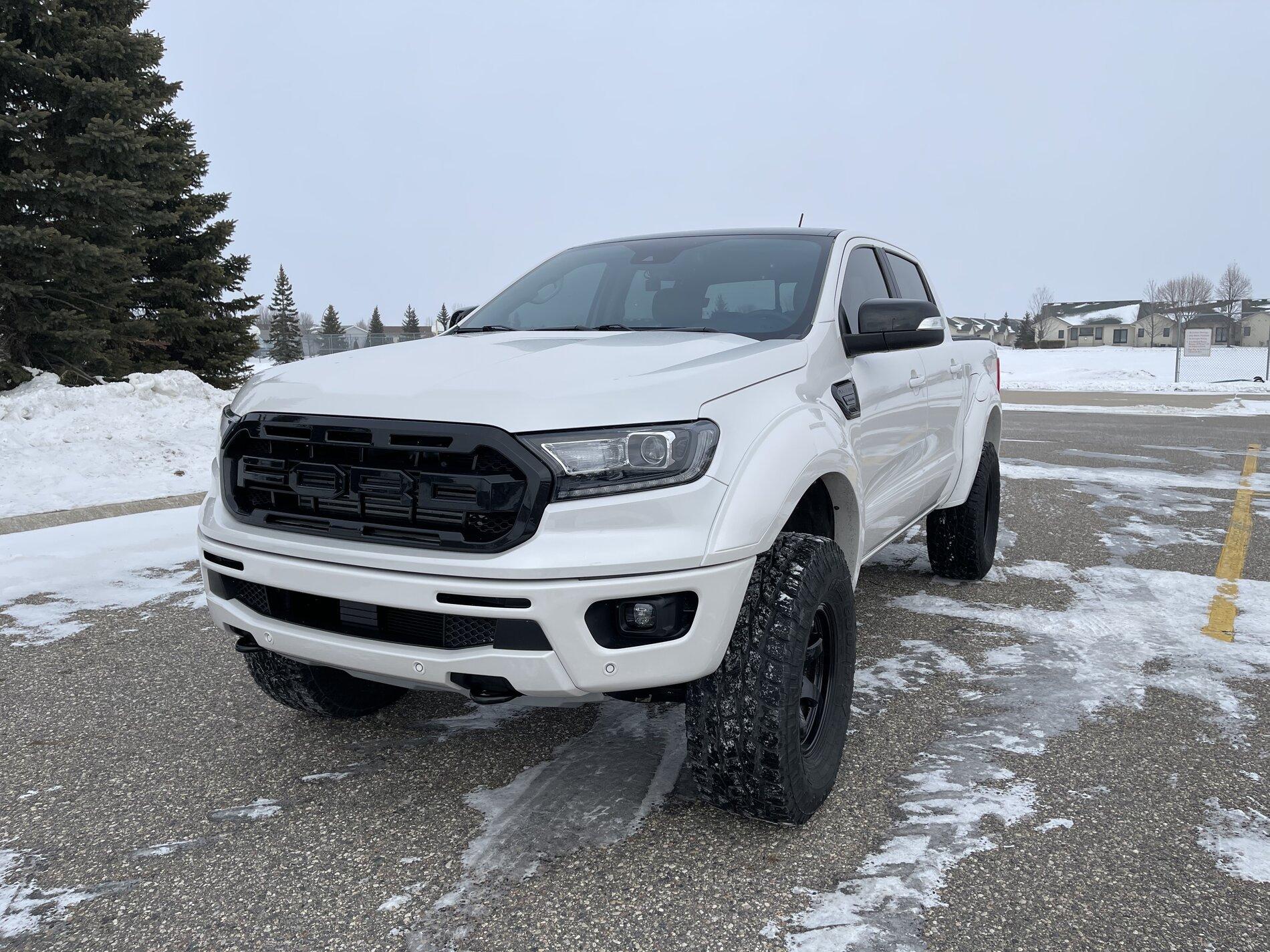

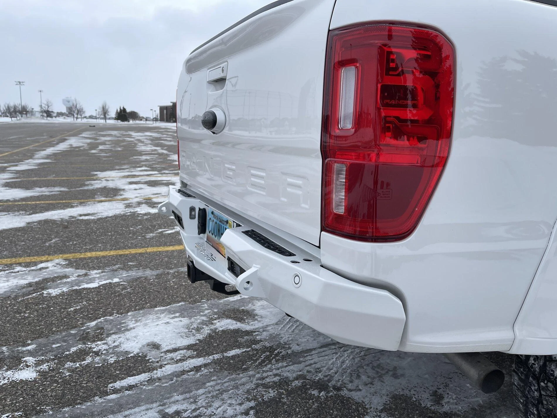

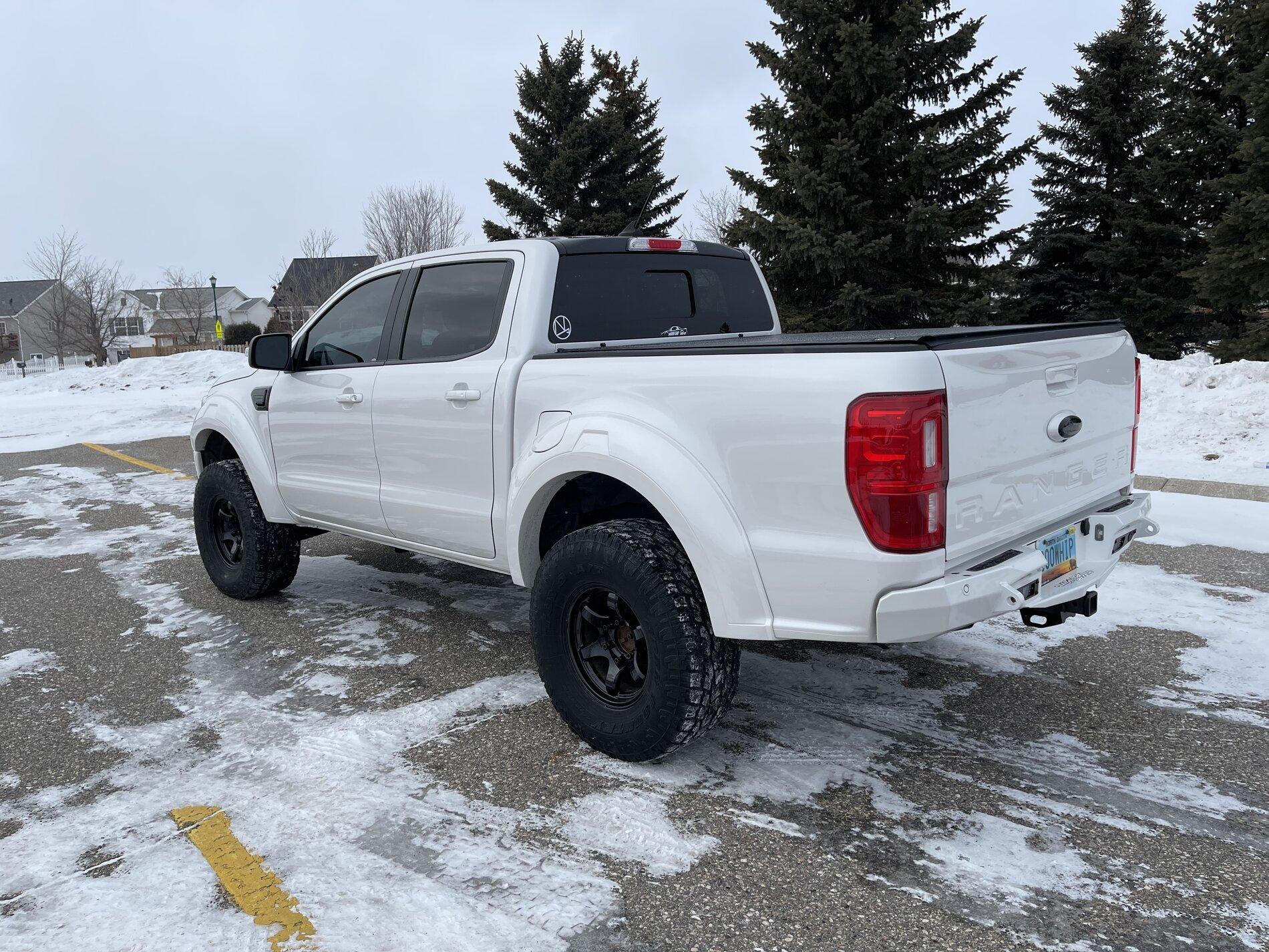

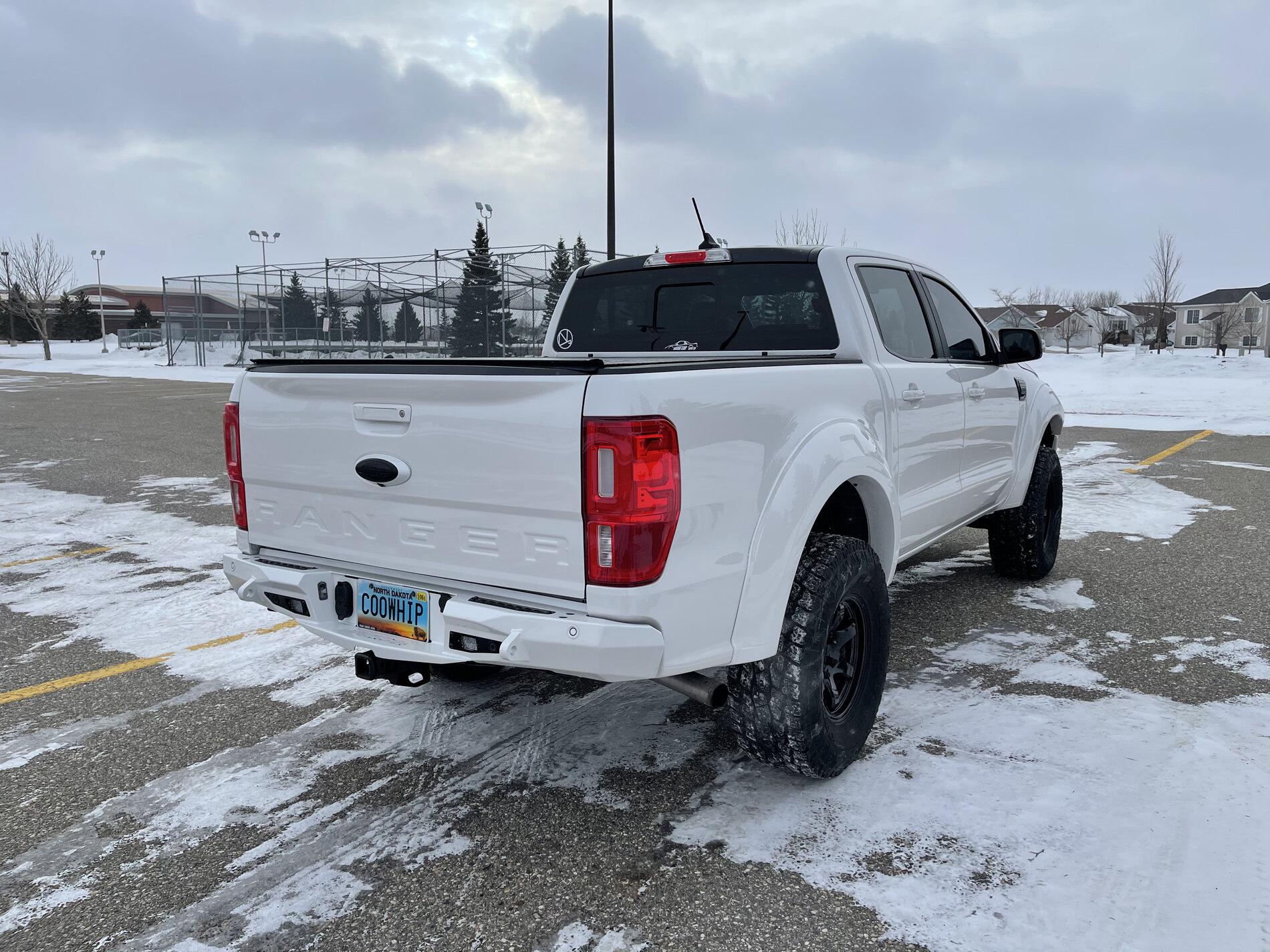

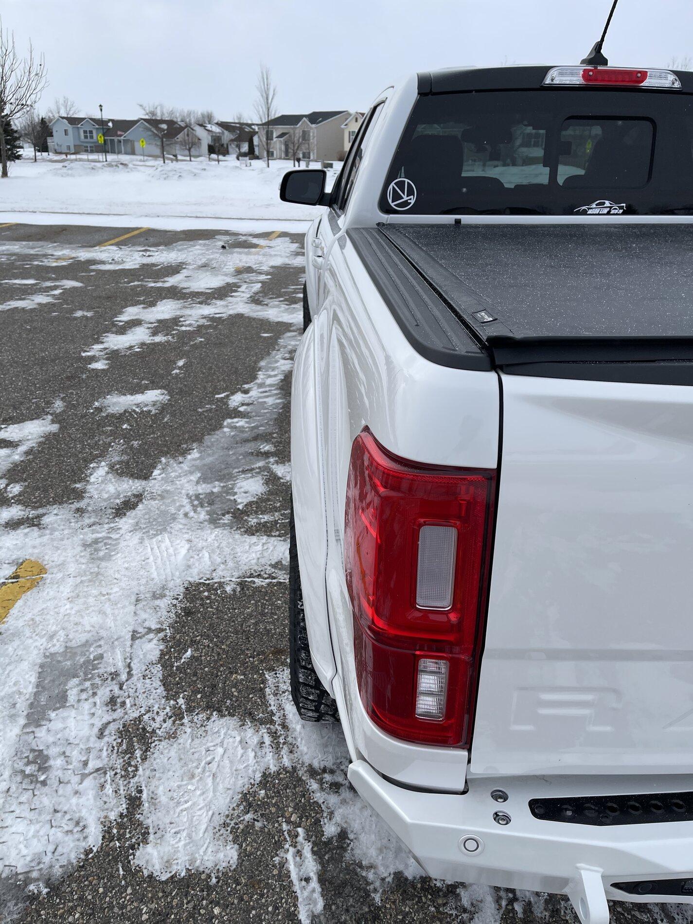

Finally! Some very obvious changes and a couple not so obvious.
Here are some pics of the ADD Stealth Fighter rear bumper and RK Sport fender flares all painted and installed. The Ranger is dirty, but this is about as clean as it will get for our shitty winter. The streets are usually so loaded with salt that they are sloppy all the time. Luckily they were sort of dry the other day.
The ADD Stealth Fighter rear bumper was a giant pain in the ass to install. Their instructions were ok but they clearly didn't do an install on more than 1 trim level of the Ranger. I mounted some Rigid Industries cube lights with diffusers in the openings of the rear bumper as they intended, and put the switch in my Lightforce switch fascia.

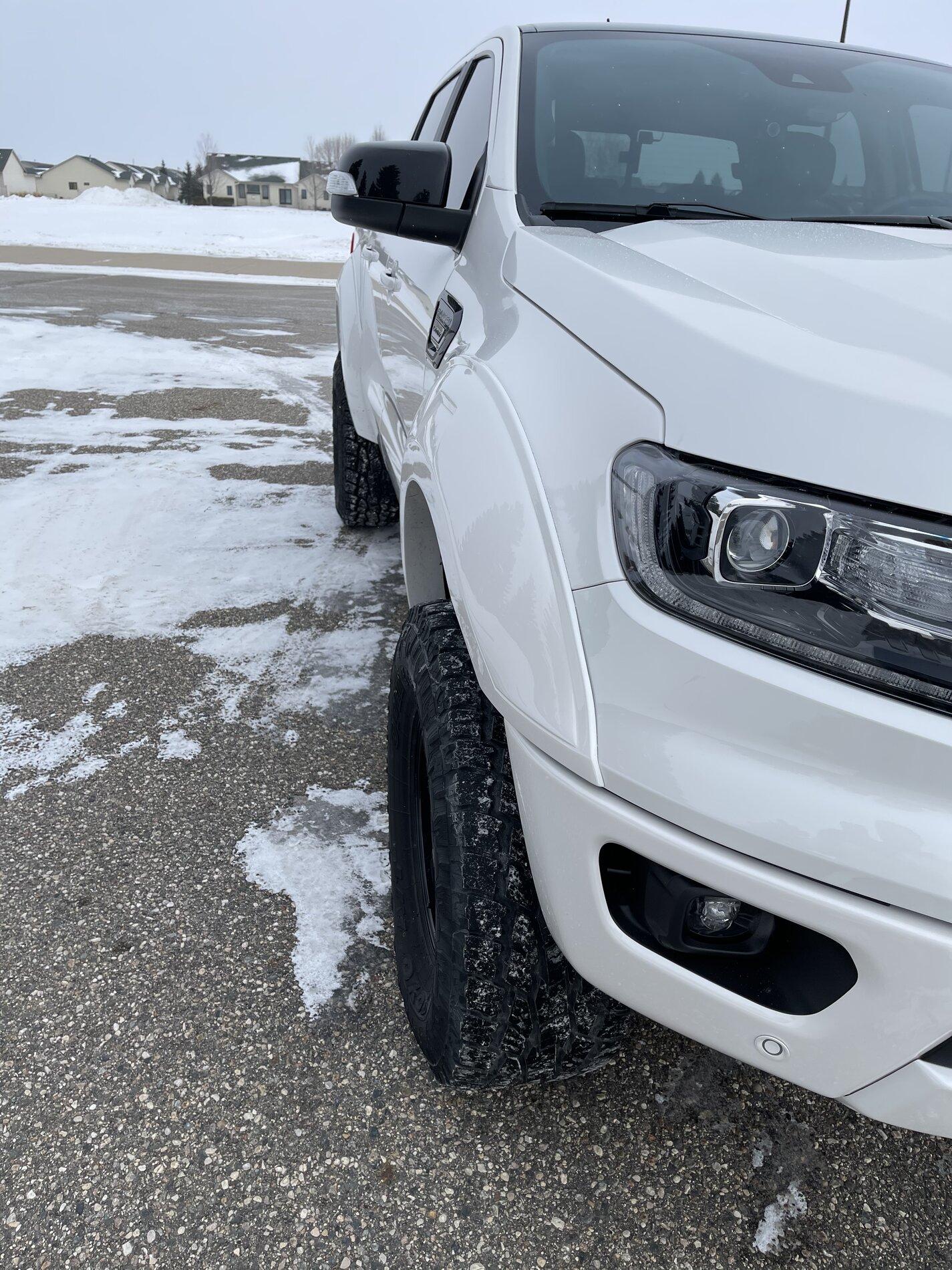

The RK Sport fender flares fit fantastic, especially considering they are fiberglass. I've never had a good experience with any fiberglass aftermarket body parts before this, so it really goes to show that RK Sport products are very high quality. Their flares fit great, and IMO, look better than any other flares for the Ranger currently on the market. I wasn't a fan of their mounting solution so I had to come up with my own. The flares have 3m double sided tape along the outer border of the flares which is just fine so they don't move at all and won't rub the factory paint, but they only included some screws to screw in around the inner portions of the fender flares. I'm not all about that, so I had to get some bolts and U clips that worked in place of some of the OEM fender trim clips. This way it is totally reversible in the future, and just makes a much nicer, cleaner install.
My Ranger had some paint issues from before I took delivery of it in July of 2019, so I finally made the dealership fix them properly. They had to repaint the whole front bumper, both passenger side doors, and the tailgate.
Since the front bumper paint was fresh and flawless, I finally installed some Xpel paint protection on the painted parts of the front. The bumper, bash plate, and the filler panel below the grill/headlights, along with the A pillars, door cups all got Xpel paint protection film. I also used some Llumar paint protection from a sample roll I've had for a while in order to protect the front half of the rear fender flares, bottoms of the flares right behind the tires, tailgate handle area, front door sills, and the center step portion of the rear bumper.

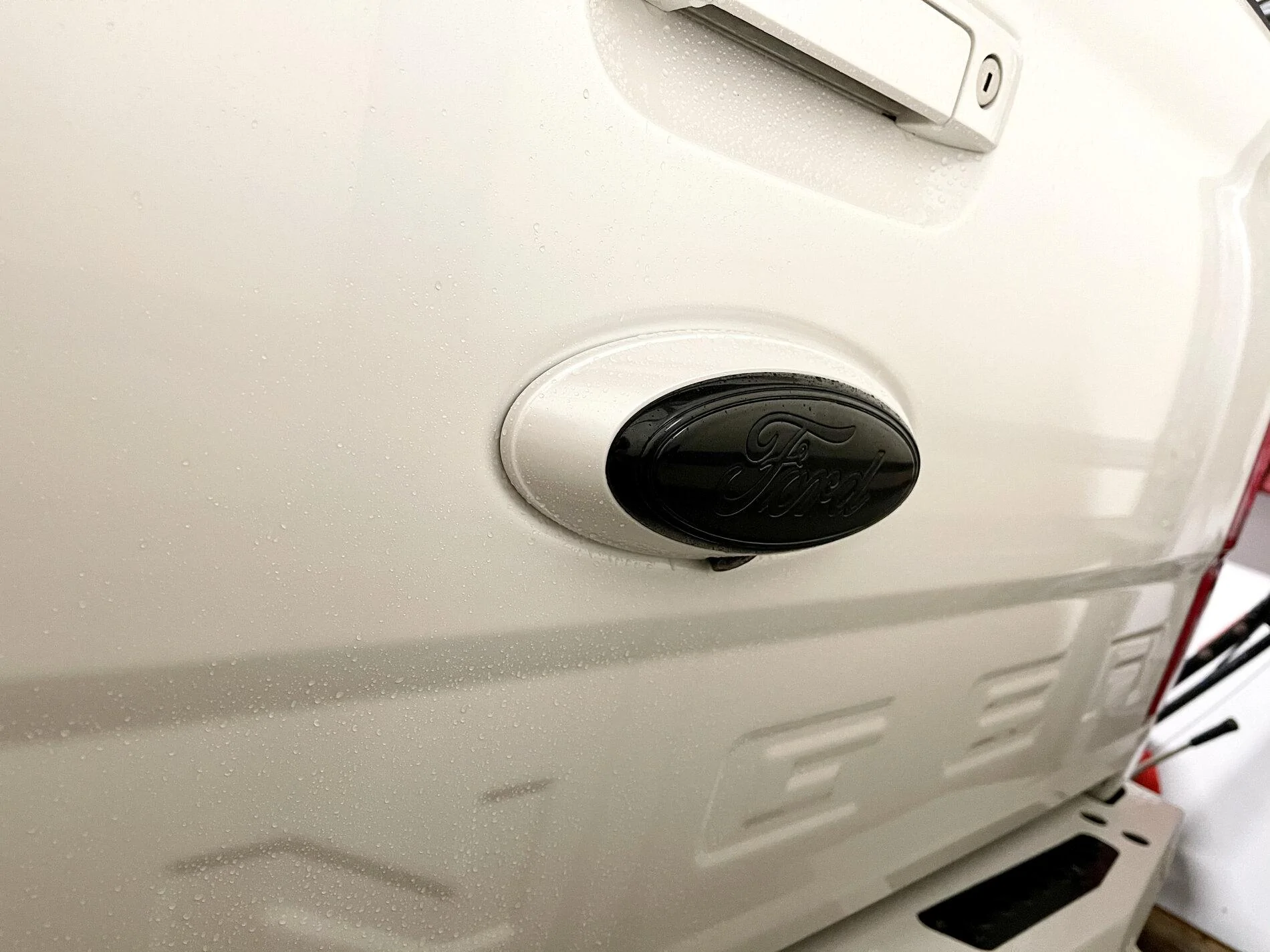

Lastly, while the dealer repainted the tailgate, I had the painter color match the chrome rear camera bezel, and paint the Ford logo black. Now my Ranger has NO CHROME left at all, which is perfect!
If the sun would ever come out here, I'll take some better pics, but this is as good as its going to get in this frozen shithole.

What was the prep like to paint the bumpers (rear in-particular). The ADD website kinda show a very textured surface... the photos look near baby-butt smooth...
